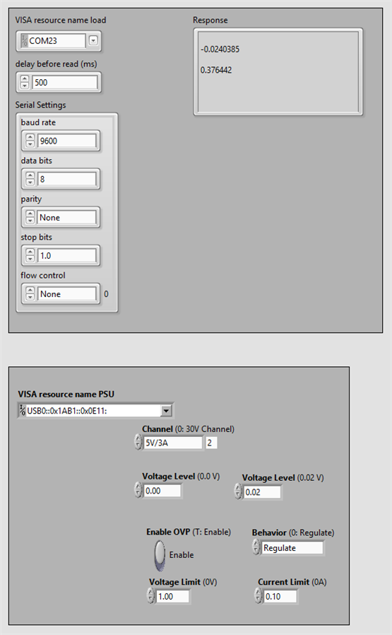

    I get excited about small things image but the image below is the result of controlling our electronic load and a power supply in a LabVIEW script.
    Two times the PSU is set to a certain voltage to mimic load current, then one of the load's ADCs sampled to validate that.
    First time the output is set to 0 V and the load should report 0 amps. The second time to 0.02V and the load should report 0.4 A.
    There are several reasons why the returned values aren't spot on, but that's not the purpose of the automation. The automation is there to reveal the errors and give a repeatable test case.
    This is how it looks like in the LabVIEW run-time.
    I still have to learn how I can make the 'set PSU then sample" block reusable and how to make good loops. Still it's satisfying to know that all tools are up to the game and that it's just skills that are lacking.

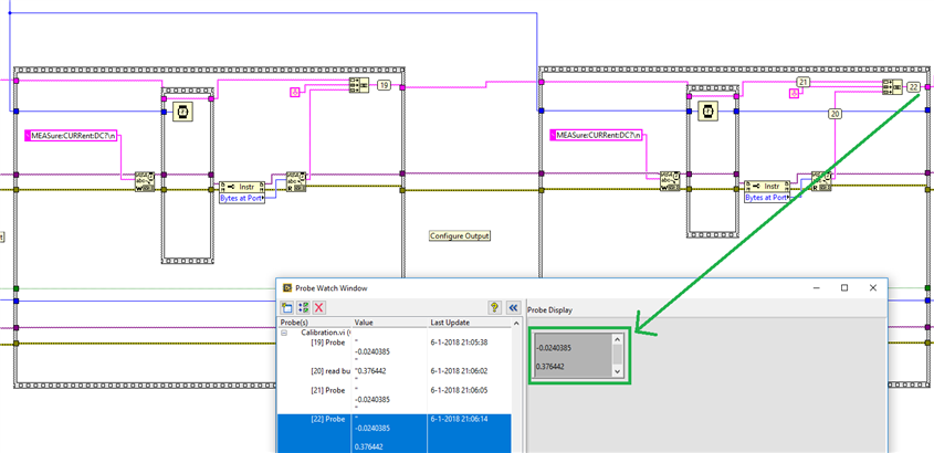

    Jan Cumps over 8 years ago in reply to Jan Cumps
    A day of studying and the flow looks significantly cleaner. No loop yet.
    The upper flow is the load, the lower one the PSU.
    The blocks in the load flow are custom made: Programmable Electronic Load - Write a LabVIEW Library part 1: Initialise Block

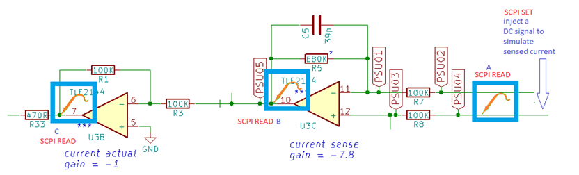

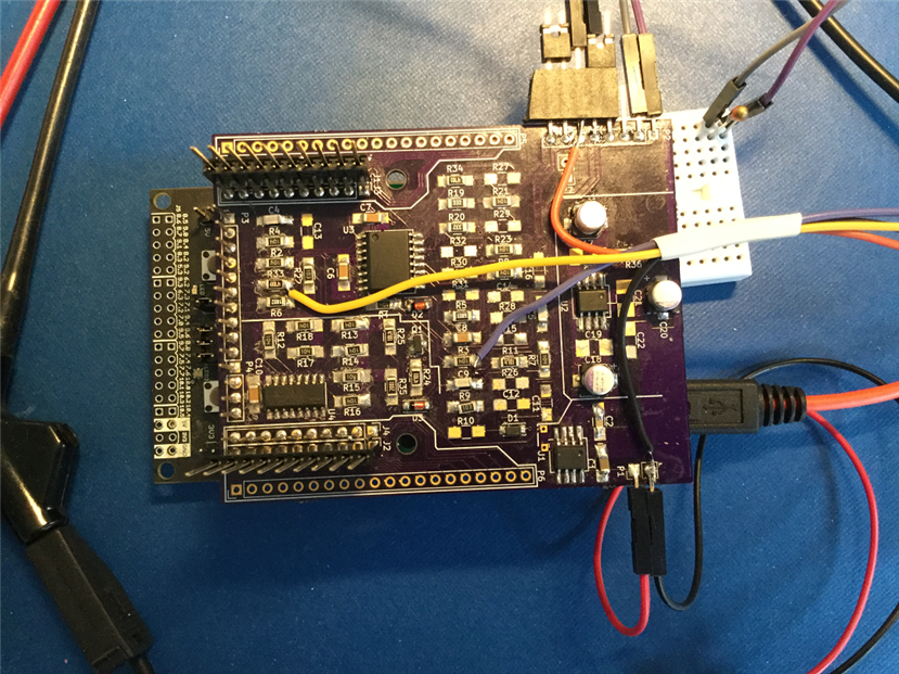

    I'm preparing the driver board for automated measurements.
    I'm going to measure the actual voltage that arrives at the current sense (A). I can't rely on the precision of the voltage that's delivered by my power supply.
    The second masurement is after the opamp with gain of -7.8 (B).
    The last sample is the voltage that goes to the ADC A, after the opamp with -1 gain (C).
    I hope that by having a fixed measurement setup I can avoid the impact from me holding the PCB while measuring and influence of bad probe contacts.
    It'll also allow for long time measurements.

    If the input voltage is a bench PSU (sorry, I'm a bit slow to catch on at times), aren't you just measuring its noise.
    You've got a few millivolts of fluctuation in the readings at the output. Divide that by the gain of eight and that equates to something like half a millivolt at the input. You'd be lucky if your PSU was cleaner than that (particularly if it has a lot of automation stuff inside it).
    Anyway, do the test with lots of readings. It will be interesting to see if you get a scatter plot with a wide, fuzzy band stretching across it.
    One way to quickly test if you are measuring the PSU noise would be to put a larger resistor in series with the current sense resistor, scale up the voltages appropriately, and then see if the variation drops by the attenuation factor.
