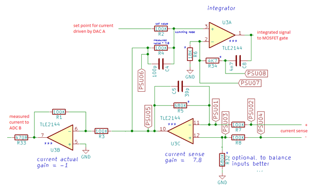

This blog documents investigates the feedback node of the electronic load that Robert Peter Oakes, jc2048 and Jan Cumps are designing.
It's an important spot in the load's design. It measures the set point and the feedback from the output.
When the output is driven to 0, it should be on a potential as close as possible to 0 V.
On the first prototype it's -0.2 V. Not so much off, but the negative value  influences our ADC measurements.
This document checks how we can get this node to 0 V.
Because this document is evolving, some comments below may be out of sync with the content. That's because the content is adapted based on the conversation.
The measurements taken here are based on the original design, without R32 in place and U3B + tied to ground.
The current sense side of R7 is connected to ground, and a variable negative voltage from 0 V down is applied to the current sense side of R8 to simulate current being sensed.
The circuit isn't complex. The set point is driven by a DAC. It's set to 0 for this test.
The second input to this node is OpAmp 3C. It has both inputs tied to ground so should theoretically have 0 V at the output.
On my board I measure a potential of -0.212V at the left side of R33.
I hope to get this closer to 0 V to ease the ADC a bit - its performance degrades with negative voltage at its inputs.

    The conclusion may be premature, but the cause for the bump seems to be the offset in the current sense opamp.
    When working that offset in the U3C away to under 200 µV, I get nicer behaviour when the regulation circuit starts.

    Jan Cumps
    I've done a bit more with mine. Rather than add another op-amp, I offset the 0V that the summing node gets compared to. See the last section of my build blog for more details

    Jan Cumps over 7 years ago in reply to Robert Peter Oakes
    Robert Peter Oakes,
    - I had an issue with the DACs of the DAC/ADC board. They can have a positive offset, and that can cause the firmware not to be able to manage the lowest region. That’s fixed with a substracting opmamp and using a free DAC channel to offset that offset.
    - there’s a more fundamental issue that the control circuit jumps at the region between no load and a slight load. It seems to be tolerance=based, because that sudden jump is from 0 to 1.3 mA on my instrument, and slightly below 1 mA on jc2048‘s board. It’s not related to DACs or firmware. That’s the jump that I show in my last comment here. After that jump, the instrument behaves linear.

    Jan Cumps over 7 years ago in reply to Jan Cumps
    It still shows that jump when the circuit starts to load
    edit: detail at the knee
    Jan Cumps over 7 years ago in reply to jc2048
    It works now - with proper resistor values. I'll try to find a DAC1 DAC2 combination that gives a good start near 0..

    jc2048 over 7 years ago in reply to Jan Cumps
    I found it: all resistors on my bodge board are 100 Ohm instead of 100K.
    So they are. It was staring us in the face in that photograph you posted - '101' marked on the tops.
    Personally, I'd change them all for 10k (including the two summing resistors) to get the currents up an order of magnitude, but that's probably just me being fussy.
