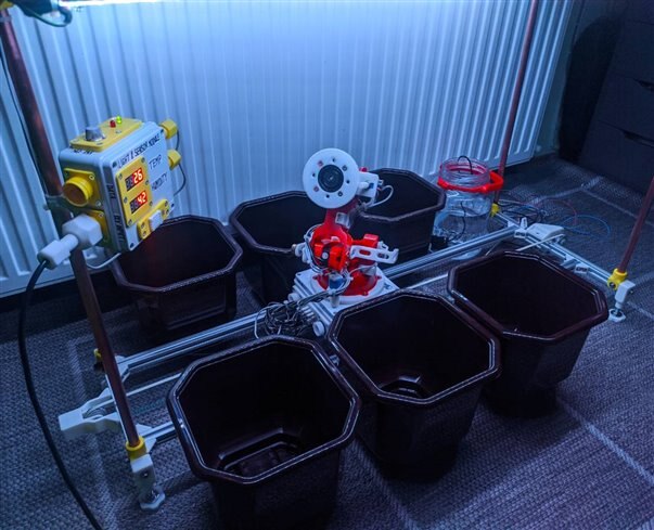

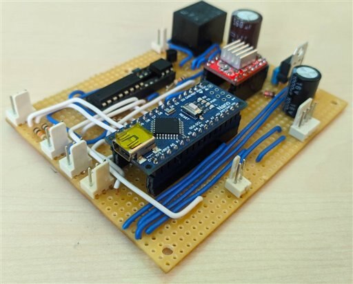

1. Introduction
     Hi! This will be my eleventh and final blog for the 1 Meter of Pi - Design Challenge. It was a great competition to be part of with a lot of amazing projects. Because of some other work and projects, I unfortunately had to start pretty late with my first blog being posted on November 29th. With a little over a month from then, I managed to write 10 additional blogs including this one. I've tried putting it as much as work and effort as I can both into the project and into the blogs. I'm really happy and proud of how far the projects has come since the first blog. But this won't be just the project summary blog, I will also finally cover the GUI I designed and programmed for the Raspberry and then I'll do some final tests and do a final overview of my whole journey for this project, hope you enjoy!

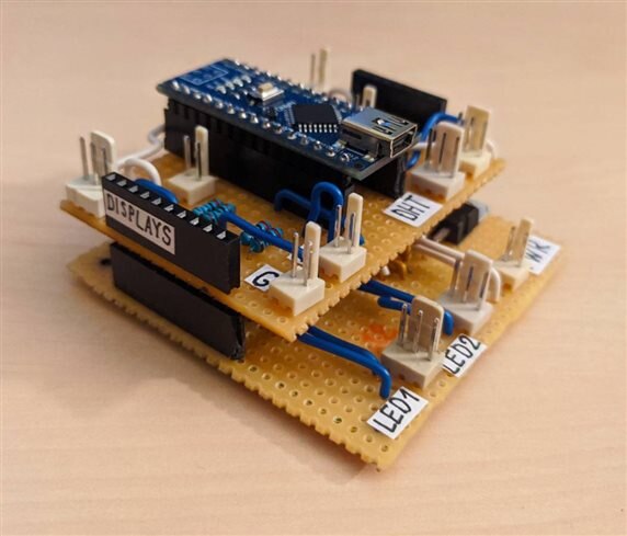

Slave
     On the slave side we will have Arduino Nanos, for them, I will be using the Wire Library. It has a couple of great built in functions which make it really easy to use with I2C. We need an address of course, this is the address I already mentioned that needs to match the address on the Raspberry and we need a function to call as an event when we receive some data over I2C.
// Setting up I2C
    Wire.begin(SLAVE_ADDRESS);
    Wire.onReceive(ReceiveData);
     Besides that, we need a function ReceiveData that will grab the bytes coming over I2C and store them in our variables which we can use further in our program. For example, for the SL module I just sliced the data into 2 parts where each of them showed how bright the LED strip should be, while for the WR Module, since it was controlled by buttons, if any of the buttons was pressed, I would send a single integer which I can then read and decode. Here is an example of a Receive Data function which I used in the WR module.
void ReceiveData(int byteCoun){
    while ( Wire.available()) {
        char c = (char)Wire.read();
        //Serial.println(c);
        RaspberryData += c;
    command = RaspberryData.substring(1).toInt();
    Serial.println(command);
    Serial.println(RaspberryData);
    RaspberryData = "";
    Execute(command);

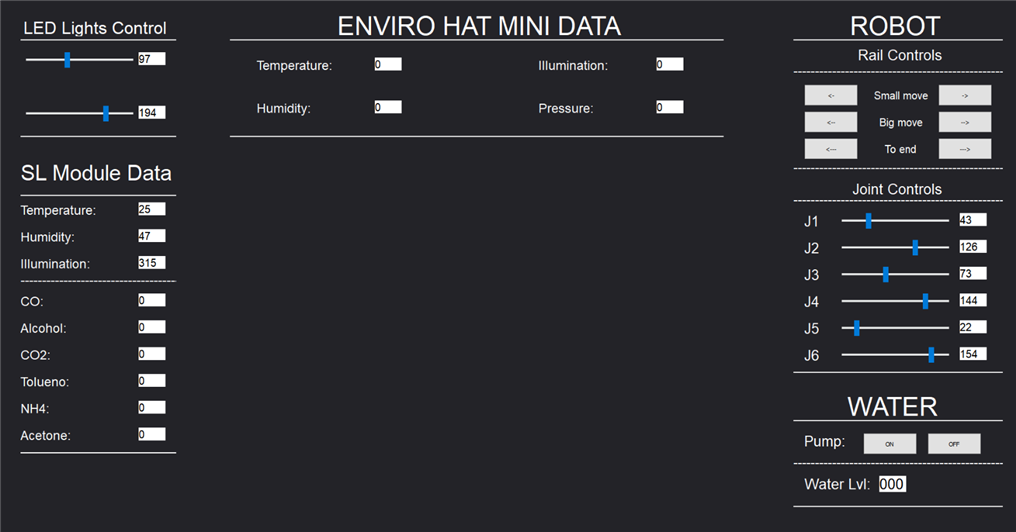

GUI

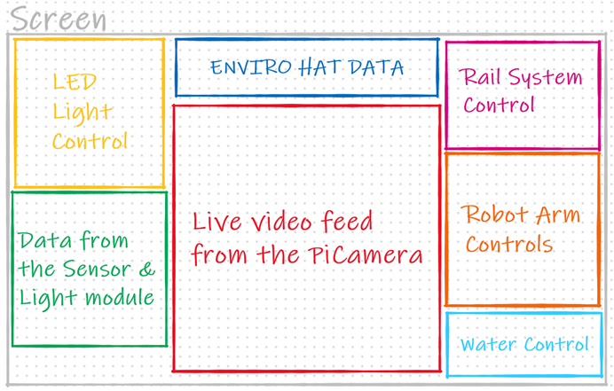

     This is a part that took a while. I'm not experienced with Python, so I just went and did what I see worked and repeated that until I got the result I wanted. This GUI is in my opinion 90% finished, the only thing I didn't manage to sort out was a central PiCamera live feed in the GUI. It can be done through a label and OpenCV, but I didn't have time to experiment and make it work. My idea for the GUI was essentially this.
     For controlling the lights I wanted to have sliders, which also goes for all of the joints on the robot, while for the rail controls and the water pump, I wanted just plain and ordinary buttons. When it comes to the rail system, I wanted 3 sets of buttons, ones for small movements, 10 steps, big movements, 100 steps, and to go from one end to the other. After a couple of hours of coding I ended up with this, and I'm more than happy with the looks.
Finished code
     These here are the codes that I've updated to support the communication that I talked about as well as work with the GUI that I designed. The Arduino codes are 95% the same as the codes I used in the blogs for each module, while the code for the Raspberry I wrote from scratch. For designing the GUI I used Python and a library called PyQt5. The code is pretty long, but I don't think that there's anything to complex in it. If you have any questions about it, feel free to reach out!
Raspberry code
from PyQt5.QtWidgets import QApplication, QPushButton, QLineEdit, QLabel, QWidget, QSlider

        self.labelSLTolueno = QLabel(self)
        self.labelSLTolueno.setText("Tolueno:")
        self.labelSLTolueno.setGeometry(60, 710, 300, 30)
        self.labelSLTolueno.setFont(QFont("Arial", 18))
        self.labelSLTolueno.setStyleSheet("QLabel {color : white}")
        self.labelSLToluenoValue = QLabel(self)
        self.labelSLToluenoValue.setText(str(SL_toluenoData))
        self.labelSLToluenoValue.setGeometry(280, 710, 50, 24)
        self.labelSLToluenoValue.setFont(QFont("Arial", 15))
        self.labelSLToluenoValue.setStyleSheet("QLabel {background-color : white; color : black}")
        self.labelSLNH4 = QLabel(self)
        self.labelSLNH4.setText("NH4:")
        self.labelSLNH4.setGeometry(60, 760, 300, 30)
        self.labelSLNH4.setFont(QFont("Arial", 18))
        self.labelSLNH4.setStyleSheet("QLabel {color : white}")
        self.labelSLNH4Value = QLabel(self)
        self.labelSLNH4Value.setText(str(SL_NH4Data))
        self.labelSLNH4Value.setGeometry(280, 760, 50, 24)
        self.labelSLNH4Value.setFont(QFont("Arial", 15))
        self.labelSLNH4Value.setStyleSheet("QLabel {background-color : white; color : black}")
        self.labelSLAcetone = QLabel(self)
        self.labelSLAcetone.setText("Acetone:")
        self.labelSLAcetone.setGeometry(60, 810, 300, 30)
        self.labelSLAcetone.setFont(QFont("Arial", 18))
        self.labelSLAcetone.setStyleSheet("QLabel {color : white}")
        self.labelSLAcetoneValue = QLabel(self)
        self.labelSLAcetoneValue.setText(str(SL_acetoneData))
        self.labelSLAcetoneValue.setGeometry(280, 810, 50, 24)
        self.labelSLAcetoneValue.setFont(QFont("Arial", 15))
        self.labelSLAcetoneValue.setStyleSheet("QLabel {background-color : white; color : black}")
        self.labelLine = QLabel(self)
        self.labelLine.setText("_______________________________________________")
        self.labelLine.setGeometry(60, 830, 290, 30)
        self.labelLine.setFont(QFont("Arial", 18))
        self.labelLine.setStyleSheet("QLabel {color : white}")
        self.labelLED = QLabel(self)
        self.labelLED.setText("ENVIRO HAT MINI DATA")
        self.labelLED.setGeometry(650, 40, 700, 40)
        self.labelLED.setFont(QFont("Arial", 36))
        self.labelLED.setStyleSheet("QLabel {color : white}")
        self.labelLine.setText("____________________________________________________________________________________________________________________________________________________")
        self.labelLine.setGeometry(450, 60, 920, 30)
        self.labelENVTemp = QLabel(self)
        self.labelENVTemp.setText("Temperature:")
        self.labelENVTemp.setGeometry(500, 120, 300, 30)
        self.labelENVTemp.setFont(QFont("Arial", 18))
        self.labelENVTemp.setStyleSheet("QLabel {color : white}")
        self.labelENVTempValue = QLabel(self)
        self.labelENVTempValue.setText(str(ENVIRO_tempData))
        self.labelENVTempValue.setGeometry(720, 120, 50, 24)
        self.labelENVTempValue.setFont(QFont("Arial", 15))
        self.labelENVTempValue.setStyleSheet("QLabel {background-color : white; color : black}")
        self.labelENVHum = QLabel(self)
        self.labelENVHum.setText("Humidity:")
        self.labelENVHum.setGeometry(500, 200, 300, 30)
        self.labelENVHum.setFont(QFont("Arial", 18))
        self.labelENVHum.setStyleSheet("QLabel {color : white}")
        self.labelENVHumValue = QLabel(self)
        self.labelENVHumValue.setText(str(ENVIRO_humData))
        self.labelENVHumValue.setGeometry(720, 200, 50, 24)
        self.labelENVHumValue.setFont(QFont("Arial", 15))
        self.labelENVHumValue.setStyleSheet("QLabel {background-color : white; color : black}")
        self.labelENVIllum = QLabel(self)
        self.labelENVIllum.setText("Illumination:")
        self.labelENVIllum.setGeometry(1025, 120, 300, 30)
        self.labelENVIllum.setFont(QFont("Arial", 18))
        self.labelENVIllum.setStyleSheet("QLabel {color : white}")
        self.labelENVIllumValue = QLabel(self)
        self.labelENVIllumValue.setText(str(ENVIRO_illuminationData))
        self.labelENVIllumValue.setGeometry(1245, 120, 50, 24)
        self.labelENVIllumValue.setFont(QFont("Arial", 15))
        self.labelENVIllumValue.setStyleSheet("QLabel {background-color : white; color : black}")
        self.labelENVPressure = QLabel(self)
        self.labelENVPressure.setText("Pressure:")
        self.labelENVPressure.setGeometry(1025, 200, 300, 30)
        self.labelENVPressure.setFont(QFont("Arial", 18))
        self.labelENVPressure.setStyleSheet("QLabel {color : white}")
        self.labelENVPressureValue = QLabel(self)
        self.labelENVPressureValue.setText(str(ENVIRO_pressureData))
        self.labelENVPressureValue.setGeometry(1245, 200, 50, 24)
        self.labelENVPressureValue.setFont(QFont("Arial", 15))
        self.labelENVPressureValue.setStyleSheet("QLabel {background-color : white; color : black}")
        self.labelLine.setGeometry(450, 240, 920, 30)
        self.labelLED.setText("ROBOT")
        self.labelLED.setGeometry(1605, 40, 300, 40)
        self.labelLine.setText("__________________________________________________________________")
        self.labelLine.setGeometry(1500, 60, 390, 30)
        self.labelLED.setText("Rail Controls")
        self.labelLED.setGeometry(1620, 100, 300, 30)
        self.labelLED.setFont(QFont("Arial", 20))
        self.labelLine.setText("--------------------------------------------------------")
        self.labelLine.setGeometry(1500, 130, 390, 30)
        self.labelLED.setText("Small move")
        self.labelLED.setGeometry(1650, 175, 300, 30)
        self.labelLED.setFont(QFont("Arial", 15))
        self.labelLED.setText("Big move")
        self.labelLED.setGeometry(1660, 225, 300, 30)
        self.labelLED.setText("To end")
        self.labelLED.setGeometry(1670, 275, 300, 30)
        self.buttonSlowLeft = QPushButton('<-', self)
        self.buttonSlowLeft.resize(100, 40)
        self.buttonSlowLeft.move(1520, 170)
        self.buttonSlowLeft.clicked.connect(self.Button1Fcn)
        self.buttonFastLeft = QPushButton('<--', self)
        self.buttonFastLeft.resize(100, 40)
        self.buttonFastLeft.move(1520, 220)
        self.buttonFastLeft.clicked.connect(self.Button2Fcn)
        self.buttonToEndLeft = QPushButton('<---', self)
        self.buttonToEndLeft.resize(100, 40)
        self.buttonToEndLeft.move(1520, 270)
        self.buttonToEndLeft.clicked.connect(self.Button3Fcn)
        self.buttonSlowRight = QPushButton('->', self)
        self.buttonSlowRight.resize(100, 40)
        self.buttonSlowRight.move(1770, 170)
        self.buttonSlowRight.clicked.connect(self.Button4Fcn)
        self.buttonFastRight = QPushButton('-->', self)
        self.buttonFastRight.resize(100, 40)
        self.buttonFastRight.move(1770, 220)
        self.buttonFastRight.clicked.connect(self.Button5Fcn)
        self.buttonToEndRight = QPushButton('--->', self)
        self.buttonToEndRight.resize(100, 40)
        self.buttonToEndRight.move(1770, 270)
        self.buttonToEndRight.clicked.connect(self.Button6Fcn)
        self.labelLine.setGeometry(1500, 310, 390, 30)
        self.labelLED.setText("Joint Controls")
        self.labelLED.setGeometry(1610, 350, 300, 30)
        self.labelLine.setGeometry(1500, 370, 390, 30)
        #1
        self.labelLED.setText("J1")
        self.labelLED.setGeometry(1520, 410, 300, 30)
        self.SliderR1 = QSlider(Qt.Horizontal, self)
        self.SliderR1.setGeometry(1590, 410, 200, 30)
        self.SliderR1.setRange(0,180)
        self.SliderR1.valueChanged[int].connect(self.changeValueR1)
        self.labelSliderR1 = QLabel(self)
        self.labelSliderR1.setText("000")
        self.labelSliderR1.setGeometry(1810, 410, 50, 24)
        self.labelSliderR1.setFont(QFont("Arial", 15))
        self.labelSliderR1.setStyleSheet("QLabel {background-color : white; color : black}")
        #2
        self.labelLED.setText("J2")
        self.labelLED.setGeometry(1520, 460, 300, 30)
        self.SliderR2 = QSlider(Qt.Horizontal, self)
        self.SliderR2.setGeometry(1590, 460, 200, 30)
        self.SliderR2.setRange(0,180)
        self.SliderR2.valueChanged[int].connect(self.changeValueR2)
        self.labelSliderR2 = QLabel(self)
        self.labelSliderR2.setText("000")
        self.labelSliderR2.setGeometry(1810, 460, 50, 24)
        self.labelSliderR2.setFont(QFont("Arial", 15))
        self.labelSliderR2.setStyleSheet("QLabel {background-color : white; color : black}")
        #3
        self.labelLED.setText("J3")
        self.labelLED.setGeometry(1520, 510, 300, 30)
        self.SliderR3 = QSlider(Qt.Horizontal, self)
        self.SliderR3.setGeometry(1590, 510, 200, 30)
        self.SliderR3.setRange(0,180)
        self.SliderR3.valueChanged[int].connect(self.changeValueR3)
        self.labelSliderR3 = QLabel(self)
        self.labelSliderR3.setText("000")
        self.labelSliderR3.setGeometry(1810, 510, 50, 24)
        self.labelSliderR3.setFont(QFont("Arial", 15))
        self.labelSliderR3.setStyleSheet("QLabel {background-color : white; color : black}")
        #4
        self.labelLED.setText("J4")
        self.labelLED.setGeometry(1520, 560, 300, 30)
        self.SliderR4 = QSlider(Qt.Horizontal, self)
        self.SliderR4.setGeometry(1590, 560, 200, 30)
        self.SliderR4.setRange(0,180)
        self.SliderR4.valueChanged[int].connect(self.changeValueR4)
        self.labelSliderR4 = QLabel(self)
        self.labelSliderR4.setText("000")
        self.labelSliderR4.setGeometry(1810, 560, 50, 24)
        self.labelSliderR4.setFont(QFont("Arial", 15))
        self.labelSliderR4.setStyleSheet("QLabel {background-color : white; color : black}")
        #5
        self.labelLED.setText("J5")
        self.labelLED.setGeometry(1520, 610, 300, 30)
        self.SliderR5 = QSlider(Qt.Horizontal, self)
        self.SliderR5.setGeometry(1590, 610, 200, 30)
        self.SliderR5.setRange(0,180)
        self.SliderR5.valueChanged[int].connect(self.changeValueR5)
        self.labelSliderR5 = QLabel(self)
        self.labelSliderR5.setText("000")
        self.labelSliderR5.setGeometry(1810, 610, 50, 24)
        self.labelSliderR5.setFont(QFont("Arial", 15))
        self.labelSliderR5.setStyleSheet("QLabel {background-color : white; color : black}")
        #6
        self.labelLED.setText("J6")
        self.labelLED.setGeometry(1520, 660, 300, 30)
        self.SliderR6 = QSlider(Qt.Horizontal, self)
        self.SliderR6.setGeometry(1590, 660, 200, 30)
        self.SliderR6.setRange(0,180)
        self.SliderR6.valueChanged[int].connect(self.changeValueR6)
        self.labelSliderR6 = QLabel(self)
        self.labelSliderR6.setText("000")
        self.labelSliderR6.setGeometry(1810, 660, 50, 24)
        self.labelSliderR6.setFont(QFont("Arial", 15))
        self.labelSliderR6.setStyleSheet("QLabel {background-color : white; color : black}")
        self.labelLine.setGeometry(1500, 680, 390, 30)
        self.labelLED.setText("WATER")
        self.labelLED.setGeometry(1600, 750, 300, 40)
        self.labelLine.setGeometry(1500, 770, 390, 30)
        self.labelLED.setText("Pump: ")
        self.labelLED.setGeometry(1520, 820, 300, 30)
        self.buttonPumpOn = QPushButton('ON', self)
        self.buttonPumpOn.resize(100, 40)
        self.buttonPumpOn.move(1630, 820)
        self.buttonPumpOn.clicked.connect(self.Button7Fcn)
        self.buttonPumpOff = QPushButton('OFF', self)
        self.buttonPumpOff.resize(100, 40)
        self.buttonPumpOff.move(1750, 820)
        self.buttonPumpOff.clicked.connect(self.Button8Fcn)
        self.labelLine.setGeometry(1500, 860, 390, 30)
        self.labelLED.setText("Water Lvl: ")
        self.labelLED.setGeometry(1520, 900, 300, 30)
        self.labelWaterLevel = QLabel(self)
        self.labelWaterLevel.setText("000")
        self.labelWaterLevel.setGeometry(1700, 900, 300, 30)
        self.labelWaterLevel.setFont(QFont("Arial", 20))
        self.labelWaterLevel.setStyleSheet("QLabel {color : white}")
        self.labelLine.setGeometry(1500, 930, 390, 30)
        self.labelLine.setStyleSheet("QLabel {background-color : white; color : black}")
        self.show()
    def changeValue1(self, value):
        self.labelSlider1.setText(str(value))
        global LED1
        LED1 = value
        #SendLEDData()
        print(value)
    def changeValue2(self, value):
        self.labelSlider2.setText(str(value))
        global LED2
        LED2 = value
        #SendLEDData()
        print(value)
    def changeValueR1(self, value):
        self.labelSliderR1.setText(str(value))
        print(value)
    def changeValueR2(self, value):
        self.labelSliderR2.setText(str(value))
        print(value)
    def changeValueR3(self, value):
        self.labelSliderR3.setText(str(value))
        print(value)
    def changeValueR4(self, value):
        self.labelSliderR4.setText(str(value))
        print(value)
    def changeValueR5(self, value):
        self.labelSliderR5.setText(str(value))
        print(value)
    def changeValueR6(self, value):
        self.labelSliderR6.setText(str(value))
        print(value)

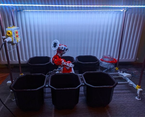

3. Final Tests
     With the spine of the GUI completed, it was time to test it out a bit. While I did manage to get both way communication going fairly nicely over I2C, I didn't have time to implement data logging and translating all of the raw data from the modules into useful data which I could show on the GUI. What I did manage to was to go ahead and control some of the functions on the project using the GUI on the Raspberry. Here are those videos.
Controlling the lights through the GUI
Controlling the robot over the GUI
Controlling the pump over the GUI
     Everything is working great and as expected! Sorry if the videos aren't the best, I had trouble setting up a single shot which would catch both the monitor and the whole rails system. You can hear in the video that I'm clicking in the background with a mouse, also you can hear the pump going in the third video.

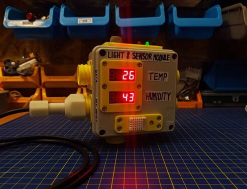

Blog #5 --- Sensor & Light Module
     Here we come to the first of the modules that I've designed for this project, the Sensor & Light Module. While my plan was to do measurements with the Enviro Hat Mini which was included in the Starter Kit, I also wanted to have another set of sensors for redundancy and some additional sensors which the Enviro didn't cover. This module is capable of measuring air temperature, humidity, illumination, and levels of multiples gases which are: CO, Alcohol, CO2, Toluene, NH4, Acetone. Besides being able to do that, the module is also capable of controlling 2 independent RGB LED strips using the MOSFET stage which I covered in that blog.

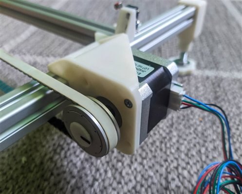

Blog #6 --- Mechanical Build P1 - Robot On Rails
     Now we come to the blog that proves once again that not everything can always go smoothly. This is the blog where I've designed and assembled the main construction for this project, the rail system on which the robot rides on between the plants. There was a lot of design work that went into this, a lot of various brackets, belt tensioner, wheels for the robot, legs for the whole construction and so on. I'm really proud with how this turned out, until I had a couple of hick ups. There was a lot of strange noise and the stepper motor driver decided to burn out.
     But even considering that, I consider this blog a success, because it was the foundation which let me finish on time. As for the issues and problems that've occurred in this blog, I've addressed all of them in one of the later blogs. But rather then just ending with the picture of a toasty stepper controller, here is what I actually accomplished in this blog.

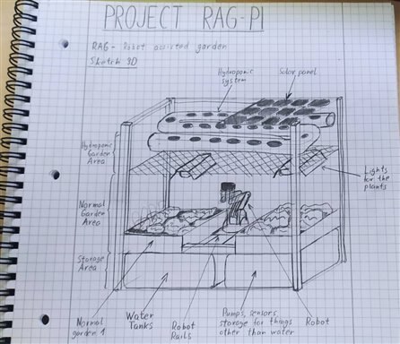

7. Sketches

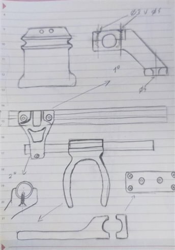

     Something I've noticed a lot of people commented on is that they love the hand sketches and rough drawings which I put into some of my blogs. I love doing sketches and drawings for my projects, makes it much easier for me wrap my head around it and often brings out better ideas and easier ways to do stuff. Here are some of the sketches I did which helped me a lot with this project while other unfortunately didn't make it.

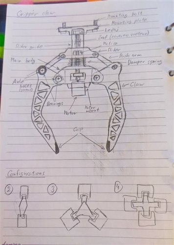

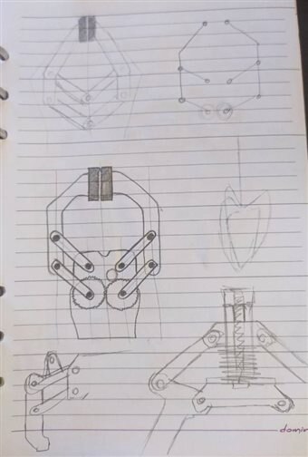

Robot Grippers

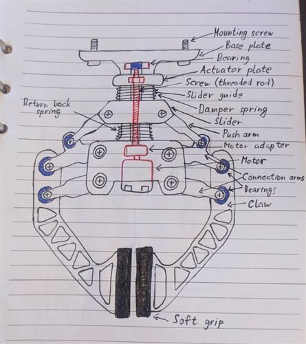

     One of the things I desperately wanted to design and assemble for this project was my own design of a gripper for a robot. I have a lot of ideas on this topic and have made one recently for a university class. It's a really fun thing to draw specially when you get into various ways of moving the gripper fingers and their relationship between them as they move. Here are a few sketches.
     As you can see from the drawings, all 3 have a different style of mechanism, the first one is a standard one which relies on gears, while I designed the other 2 to use a screw mechanism for more torque. While they both use the screw mechanism, there are major changes in the linkage design where one would move like a claw on a crab while the second one would keep the tip of the fingers parallel through the movement.

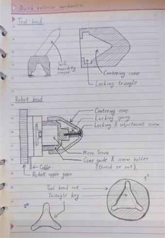

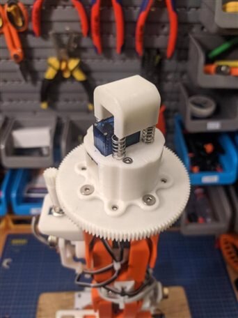

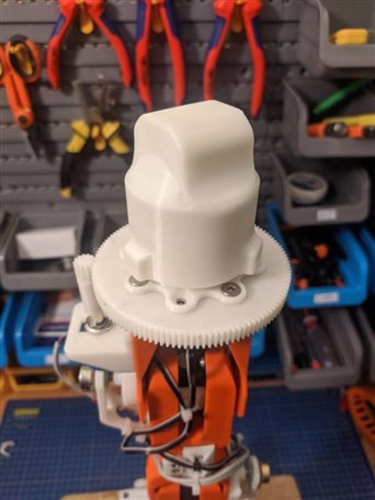

Tool holder & tool changer
     This is something I worked on a lot and something I made, but just didn't have enough time to implement. A lot of different designs went through my head for this design, but this one stuck until the end because it could be printed in just a couple of parts, and it was a mechanism that is actually printable and strong enough while not having to be based upon things like electromagnets and such things.

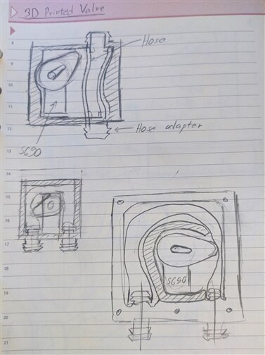

Watering System

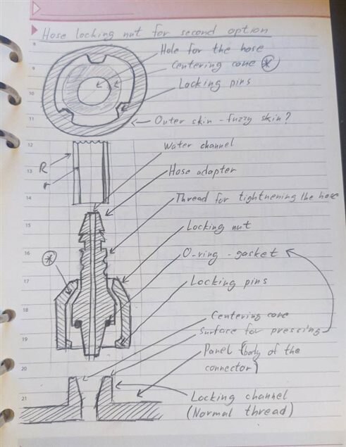

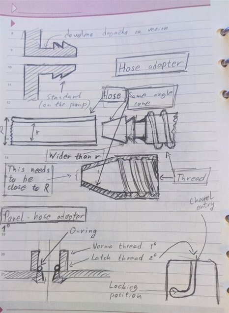

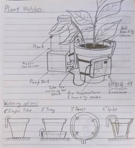

     Now we come to the system that I've semi implemented for which I had so many more ideas. Even got some tests done for some of the components below, but again, didn't have the time to be able to implement them properly. I thought about making my own lost cost 3D printed valves for watering the plants, with the main goal being making it low cost, since the SG90 servo is 3 times cheaper than the cheapest electric valve I could find. I also wanted to print out and make a lot bits for delivering the water to the plants as well as a lot of adapter for attaching the hoses together.
     Above, you can see some of my ideas for delivering the water and nutrients to the plant, from the standard just putting a hose no top of the pot to making a ring around the plant which would equally distribute the water to a spike whose purpose was to deliver the water at all levels. On the second picture you can see the idea for the valve. Since this was never planned to be a high pressure system, I though just about making a small unsymmetrical motor mount which would spin around and gradually press and pinch the hose against the wall and stopping the water in that way.

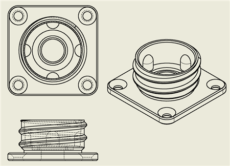

     Inspired by the 3D printed connectors I used in this project, I wanted to design and make similar connectors but this time for small hoses. While I wanted to try the basic connector style like I did with the connectors, I also wanted to try locking latch mechanism where it would click into place, but this is something that would have required a lot of trial and error to get the tolerances dialed in so it can work flawlessly.
