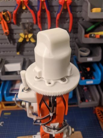

Blog #4 --- Quick Tool Change Mechanism For The Robot Arm
     In this blog, I went over the first more serious mechanical design and I could also say, most complex when it comes to fitting all of it together. In this blog I designed and printed out a tool for my robot which allows it to switch between different tools. It's a small mechanical mechanism driven by a small servo embedded on top. The mechanism proved to be extremely tough and reliable. Here are some pictures of that mechanism as well as a video where I'm testing it with the full weight of the robot.

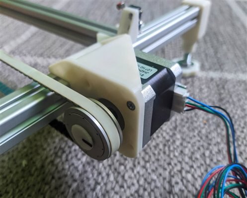

Blog #6 --- Mechanical Build P1 - Robot On Rails
     Now we come to the blog that proves once again that not everything can always go smoothly. This is the blog where I've designed and assembled the main construction for this project, the rail system on which the robot rides on between the plants. There was a lot of design work that went into this, a lot of various brackets, belt tensioner, wheels for the robot, legs for the whole construction and so on. I'm really proud with how this turned out, until I had a couple of hick ups. There was a lot of strange noise and the stepper motor driver decided to burn out.
     But even considering that, I consider this blog a success, because it was the foundation which let me finish on time. As for the issues and problems that've occurred in this blog, I've addressed all of them in one of the later blogs. But rather then just ending with the picture of a toasty stepper controller, here is what I actually accomplished in this blog.

Blog #8 --- Mechanical Build P2 - Robot On Rails
     I'll call this the blog that saved the project. In this blog I covered how I went and solved to major problems I had, which would have stopped the project if I hadn't solved them. One of those problems I already mentioned and it was in the blog #6, as for the other problem, one of the adapter plates on the robot lost all of its teeth and I ran out of replacements, so I had to do some modifications to the servo and design my own adapter plates. As for the stepper motor and driver issue, I did a lot of research to see what can cause this and came to the conclusion that it was because I didn't properly protect the driver or the motor and the driver just ended up dying. It was a cheap solution utilizing only a few capacitors and a Zenner diode.
