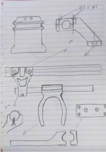

Tool holder & tool changer
     This is something I worked on a lot and something I made, but just didn't have enough time to implement. A lot of different designs went through my head for this design, but this one stuck until the end because it could be printed in just a couple of parts, and it was a mechanism that is actually printable and strong enough while not having to be based upon things like electromagnets and such things.
