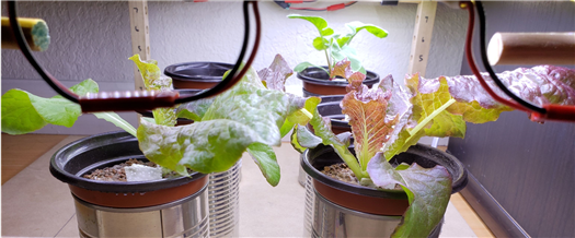

  • I successfully grew radish and lettuce to harvest with my plant pot system! Given the short growing season, the slower growing plants (tomato, onion, cilantro) have not yet reached maturity, but are on track to produce sizable harvests.

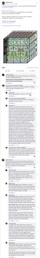

This being the last blog of the 10 blog series, I don't have have a next blog to intro. So in place of that, I'll leave the audience with some food for thought. The following are a series of thought-provoking conversations I've had through the Space Chile Challenge Facebook group.
