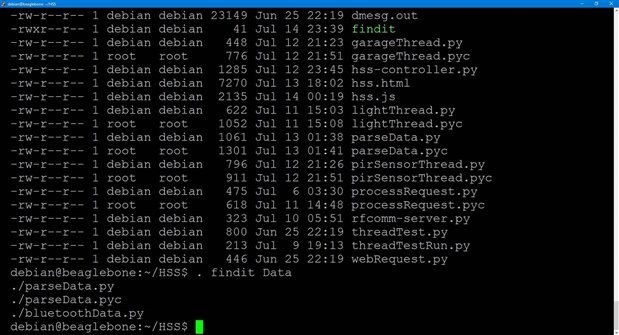

Section VI – Linux Tips

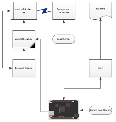

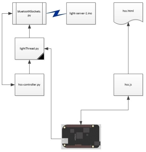

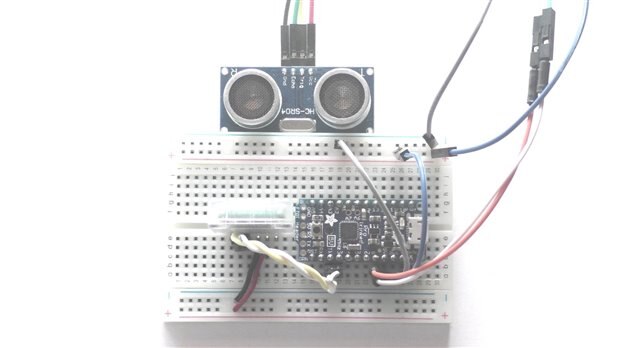

Section II - Smart Plug Design
I only made two minor changes to the design to implement the second smart plug. I changed the name for the python file from light1Thread.py to lightThread.py (Figure 1). I also renamed the function to light1 and added the function for the second smart plug, light2.
Figure 1.

lightThread.py
Lines 17-26 were added for the second power relay switch function(Figure 4). The only difference from the light1 is the pin number. It uses P8_10 instead of P8_9.

There were several changes made to the bluetoothSockets python code. The changes were made so that threads can share data and to make sure one thread's data is not overridden by another thread's data. The changes are as follows (Figure 5):
Line 3 contains the import statement for the common.py file. common.py contains the data that is shared between threads.
Line 4 contains the code to parse the data sent by the Bluetooth modules.
Extensive changes were made to the ReceiveData function, Lines 14-28. Line 18 contains a switch to determine when all of the data as been received from a give Bluetooth module. Lines 20-28 are executed until all of the data as been received from a given Bluetooth module. Data from the Bluetooth module is put into the receiveBuffer (Line 20). Data is accumulated into the bluetoothdata buffer (Line 21) until a "$" is received in the receiveBuffer (Line 22). The dataNotReceived switch is set to "false" so that received data can be parsed (Line 27) and populated into the appropriate Bluetooth data variable (Line 28).
Lines 30-37 populate the received Bluetooth data into the appropriate Bluetooth data variable. If the received source_Adapter_Id is "001" the received Bluetooth data is parsed into the variables for the PIR sensor (Lines 32-34). If the received source_Adapter_Id is "004" the received Bluetooth data is parsed into the variables for the PIR sensor (Lines 35-37).

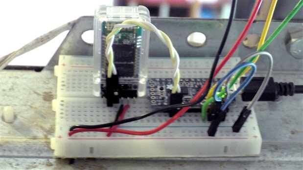

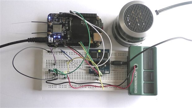

Section IV – Garage Door Sensor Design
The design for the Garage Door Sensor is basically the same as the other modules (Figure 9). There are some differences. The Arduino Pro Trinket polls the sonar Sensor (HC-04) every ten seconds and sends the status to the BeagleBone Black (Figure 10). The other difference is that there is a garage door opener attached to the BeagleBone Black (Figure 11 & 11A). It is attached to the breadboard with Velcro straps. The garage door opener is controlled by an electronic switch built with a 2N2222 transistor. Note the use of a 2.7k resistor (Figure 11A). Without it, the transistor may overheat and fail.  The HC-04 is attached to the garage ceiling. The HC-04 has a beam width of 15 degrees which allows me to place the sensor close to the door opening. Placing the sensor close to the garage door opening helps ensure the garage door is closed when the sensor is triggered. I placed the breadboard on top of the garage door motor (Figure 12).
   Figure 9.
  Figure 10.
  Figure 11.
  Figure 11A.
  Figure 12.
Section V – Garage Door Sensor Code
garage-door-server.ino
It uses the softwareSerial module instead of the hardware serial port for communicating with the Bluetooth module. SoftwareSerial uses pin 3 as the receive port and pin 4 for the transmit port. (Lines 1 & 42).
NewPing.h is a library used to process data from the HC-04. The library allows you to use the same pin for the trigger pin and the echo pin (Lines 6-8).
Line 8 defines the maximum distance, in centimeters that the sensor will detect an object.
Line 9 creates the sonar object.
Lines 12-15 defines the variables for the sketch.
The setup code is contained in Lines 17-31. Initializes the serial ports. BTSerial is used to communicate with the Bluetooth module. I initialize the Serial port in case I want to add debug code. Line 21 clears the dataBuffer. Lines 23-28 waits for the BeagleBone Black to connect to the Bluetooth module. Line 29 waits ten seconds before continuing. This is the amount of time it takes for my garage door to open or close.
Lines 33-39 contains the code for the main loop. Line 35 gets the distance to the nearest object (garage door or floor) and line 36 calls the SendStatus function which sends the status (open or closed) of the door, to the BeagleBone Black. Line 37 waits ten seconds before continuing.
The ClearBuffer function (Lines 41-47) sets the data buffer to nulls.
Lines 49-67 contains the code to read the sonar sensor. Line 52 gets the current distance from the nearest object. Lines 54-57 sets the distance to 100cm, if the distance read from the sonar sensor is out of range.
Lines 59-66 adds the status of the garage door (open or closed) to the door variable. If the distance of the nearest object is greater than 61cm the door is considered open. Otherwise, the door is considered closed.
Lines 69-81 sends the status of the door to the BeagleBone Black. If the door variable equals "open" a status of one is sent. Otherwise, a status of zero is sent.

Section VI –Unix Tips
One of the commands that I use quite a bit is the find command. To get it to do what I want it to, I use several options. I like the find command however, I get tired of keying in the options for the command. I tried saving the command in a file and copying and pasting it on the command line. However, that also takes too long for me. So I wrote a one line shell program to execute the command for me.
Here is an example of the find command I use:
sudo find . -depth -name *file-to-search-for*  -print
I use the sudo command because I often search directories that require root access.
There is a period after the find command. The period tells the find command to start searching in the current directory.
The -depth option tells the find command to search all of the sub-directories.
The -name specifies the name of the file to search for. The string after the -name option tells the find command what to search for. The putting asterisks (*) before and after the file-to-search-for tells the find command to search for anything and contains the string in between the asterisks.
The -print option tells the find command to display the full path name of the results.
All you need to do is create a file and add the line below to the file.
sudo find . -depth -name "*$1*"  -print
The $1 in the string "*$1*" tells the shell to replace the $1 with the first parameter on the command line. Note that the command itself is considered the 0th parameter. Therefore you can access the name of your shell program by using $0.
Also, you need to make it executable. Enter, at the command line (I called my shell program findit ):
chmod 755 findit
This will make the file read/write/executable by the owner and read/executable by everyone else (figure 17).
Example of a search using the findit shell program:
If I enter, on the command line (Figure 18):
. findit Data
I get the results shown in Figure 18. Remember I need the period followed by a space before the program name, since the program is in the current directory.
   Figure 17.
   Figure 18.
