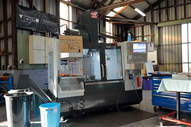

So last week I was over on the West Coast looking at Vertigo Technologies CNC Routers. (https://vertigotech.co.nz/ )
I do like their Haas Vertical Mill, and while it has nothing to do with this challenge, as a maker you can't help be in awe of it.

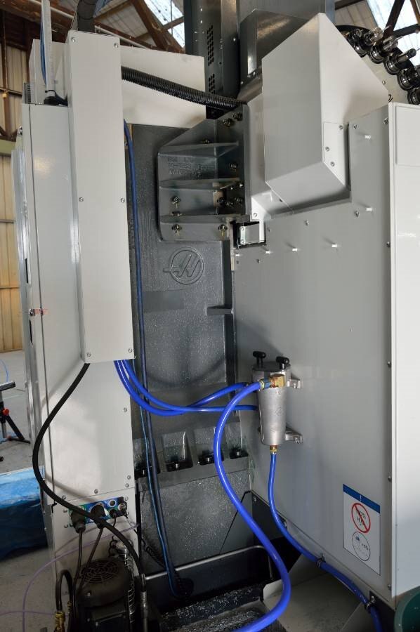

The rear shows just how serious it is. and below ....

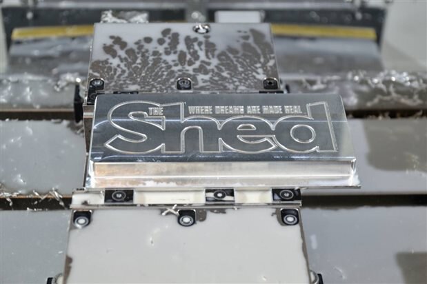

A few minutes on Fusion360 and Brett knocked up this for the publisher ... he even double sided it while he was removing the excess material.

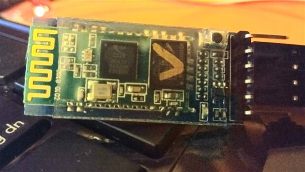

HC05 Modules
While I was ordering parts, I ran across some HC05 and HC06 Bluetooth Modules.
They appear from different vendors, but this particular one was rather quick at getting them here.
https://www.aliexpress.com/item/HC05-HC-05-master-slave-6pin-JY-MCU-anti-reverse-integrated-Bluetooth-serial-pass-throug…
https://www.aliexpress.com/item/Free-shipping-1PCS-HC06-HC-06-Wireless-Serial-4-Pin-
These modules operate as if they are a modem.
You issue Hayes style commands (AT <parameter>) and they respond, or in some cases come back with an error.
In order to issue commands, you need to put them into command mode, and in the case of the HC05 I have, press and hold the button, while applying power.
It should flash at a 2 second rate.
Not so easy for the HC06 modules I received, and despite many attempts, I gave up.

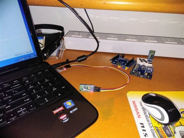

I searched the internet for some sketches, and found that in command mode, they use 38400 baud, while in data mode they use 9600 baud .... great.image
I ran across several posts that simply use the Arduino as a serial to serial buffer by using softserial and the terminal.
While I tried that, in the end I connected it to an USB to FTDI and simply plugged that in instead of the Arduino, pointed the IDE at that port, and used the terminal windows in the IDE to talk directly to the HC05 via the USB to FTDI.
Wiring them up and making them communicate is a bit of luck, hope and the odd frustration.
