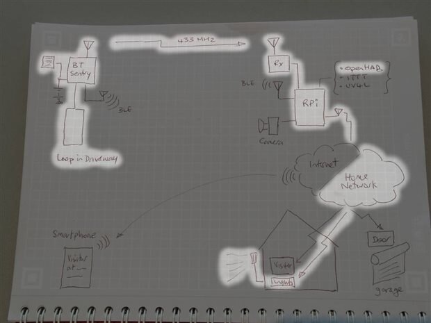

Concept
The idea is to detect the bluetooth transmitted from the vehicle and signal other Home Automation functions.
If the vehicle is known then it can open the garage door, and inform the home owner that xx is home.
Hardware
The detection point needs to be at the start of the driveway, and because there is no power source, this will need to be low power with solar charging.
The PSOC range seems a very good fit, but because of the timeline and my need to upskill, the inital design will be Arduino based and some form of RF transmitter/transceiver.
Adding a vehicle detection loop or beam is necessary to ensure those vehicles without bluetooth will also trigger the system.

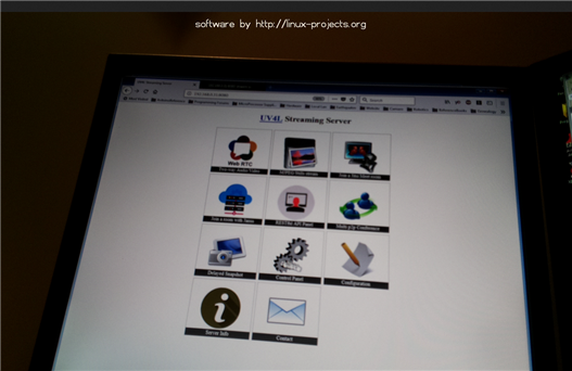

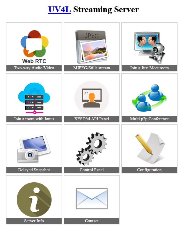

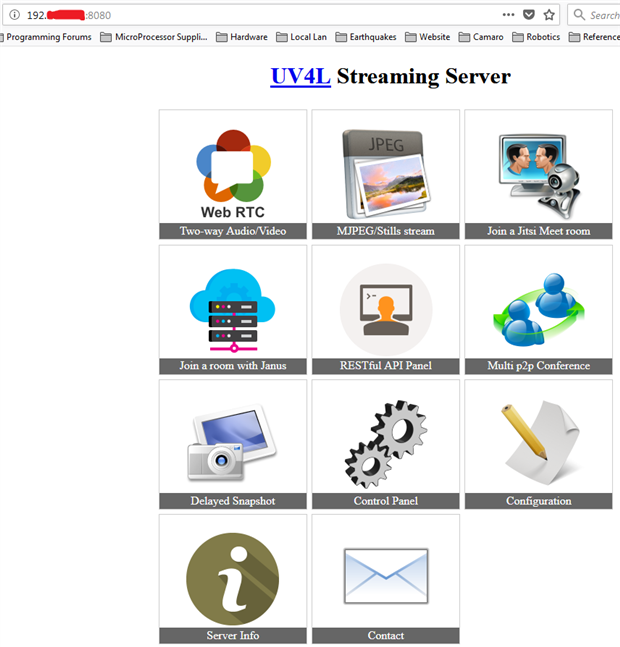

You can use ps -ef to check if the driver is running or simply force it by typing
uv4l --driver raspicam --auto-video_nr --width 640 --height 480 --encoding jpeg
You can control the UV4l by pointing your browser at http://<Rpi-address>:8080 and you should get this picture
If you click on Delayed Snapshot, it should open a new tab and display a snapshot taken from the camera (in this case another tab)
This checks that the camera and the necessary drivers are working correctly.

Using my original concept drawing, I've highlighted the parts used for turning on the outside Lights.
Somewhere within the design I probably need to add a light sensor, but for now it's just a bit more power, and with the rain we've been having the hydro dams will be full.

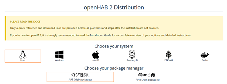

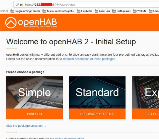

The install instructions for OpenHAB are here https://www.openhab.org/download/
You even get a very nice graphic
I'm going to do it using the Raspberry Pi so once again open a terminal windows and type in the following

BUT this is not going to work, since the UV4L server is also pointing at that port (8080) so we need to redirect one or the other.

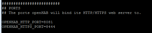

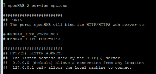

A bit of searching and I discovered that the setting for OpenHAB are held in /etc/default/openhab2
The first thing to do is copy it by typing in a terminal window
cp /etc/default
sudo cp openhab2 openhab2_org
We can edit it with
sudo nano openhab2
You can see the first few lines are the ones we want to modify
Remove the # and change the 8080 to read 8081
Remove the # and change the 8443 to 8444
For nano, you save by pressing Ctrl X and Y to confirm.
note this means to access it you'll need to use
http://<RPi-address>:8081  or https://<RPi-address>:8444

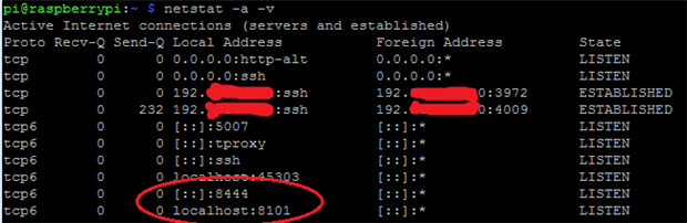

You can check that it is running the revised port by typing
netstat -a -v

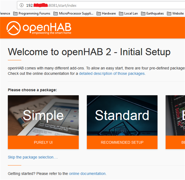

You can try browsing by typing
and to prove they both work (even at the same time)
and finally just to be sure
http://<RPi-address>:8080
