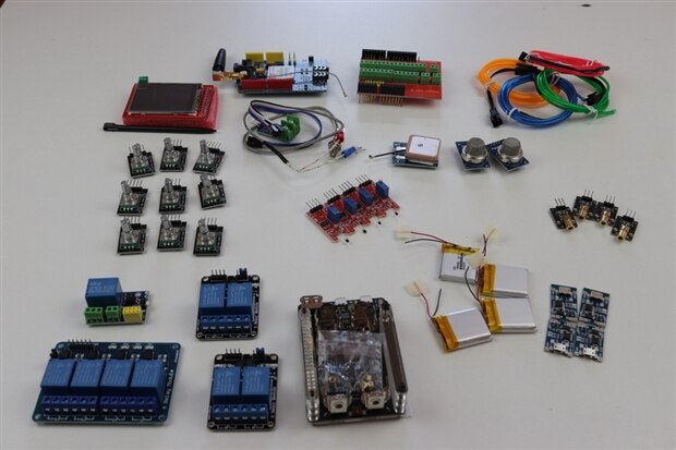

Together with the not very good news, there are also a couple of good ones: the projects of the challenge have been sponsored – together with the challenge sponsors Element14, Cypress, and AWS – by Elegoo and Digitspace. Elegoo providing 3D printing support (printers, resin, and filament) and Digitspace providing sensors, shields, and microcontrollers, and actuators. Who follows my posts knows that the brands that sponsor my projects have always something special. Well, the thing that I most appreciated in Digitspace is that their entire catalog is made of Open Source hardware. This means easy to find documentation and related software, as well as the possibility to access and share the knowledge in the great makers' community.
Below: some of the material sponsored by Digitstpace to develop the projects to transform a home in Super Smart Home.

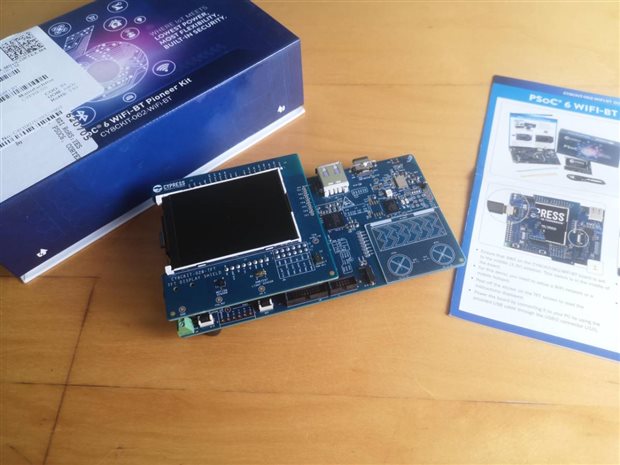

The other good news is that, after a troubled shipment, thanks to e14phil cstanton and danzima together with the efforts of the E14 staff today UPS has delivered the Cypress kit to my door.

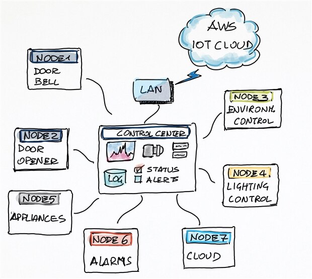

The Project
What is "Super Smart Home"? the idea is to create a network-based distributed system that can keep under control all the aspects that may be strategical in a private home following three main rules:
  • Energy saving
  • Security
  • Control
These three rules cover all the aspects that we find in a home.
We can save energy optimizing gas, water, and current consumption; we keep the home secure not only with good hardware to keep the door closed but also with a good networked system. The third rule serves the other specialized nodes in which the project architecture is divided. In this first version, I plan to simplify some of the aspects of the project in order to avoid to go too much in-depth. For example, in a normal home LAN connected to the Internet a good WiFi/Ethernet router with a strong WPA password can be considered relatively secure so the option of a dedicated firewall can be excluded; the standard firewall provided by the Internet provider router can be sufficient. Instead, inside this same network, the aspects related to IoT security are a strategic aspect of this project.
Another important aspect Super Smart Home aims to reach is creating a reliable and adaptable system at a very low price.
The above scheme shows the proof of concept on how the Super Smart Home has been divided into a series of nodes: every node identifies a series of sensors and IoT devices locally connected and operating autonomously. A Control Center, based on a Raspberry Pi 4B 4Gb shows local updates on the nodes, keeps a detailed log of all the events occurring during the day, and can react automatically with the nodes, as well as sending alarms to the user. The Control Center is also the gateway to the cloud where a set of information and controls is replicated for remote monitoring and setting.
Take into account that at the actual date I have not yet had time to explore in practice the features offered by the Cypress PSoC6 WiFi-BT Pioneer Kit so some aspects of the project strategy discussed here may be subject to changes during the development. Every node is a sub-project of the Super Smart Home developed independently, according to the role that should cover.

Node 1 - Door Bell
The doorbell is a double-way  password system covering several functions:
  • Signal the presence of a person to the outside door entry
  • Giving the possibility to open the door with an electronic key
  • Giving the possibility to an authorized guest to open the door on a double-way password system
  • giving the possibility to leave a message or speak with the owner, even when he is not at home
Node 2 - Door Opener
The door opener is exclusively operated by the Control Center, upon an authorized request of the doorbell or directly from the Control Center "Open Door" button.
Node 3 - Environmental Control
For now, the definition of Home Environment is limited to temperature and humidity but can be extended. The environmental control node has direct feedback on the fans for the air circulation and the heating system. The temperature and humidity are taken by several sensors in different home locations and the values are mediated. The temperature feedback is regulated according to the season, the presence of persons, and the rooms where the persons are.
Node 4 - Lighting Control
The lighting control is not only a way to control remotely the lights but is also possible to power off the lights in a room when there are no more persons, check if some light is powered from remote and other features.
Node 5 - Appliances
Depending on the availability in a decent time of some components I am still waiting for delivery, some of the kitchen appliances will be controlled automatically and can be activated from the remote. If I receive in time the water pump and some other parts the appliances node should also be able to control the plant humidity and watering system.
Node 6 - Alarms
Alarms node takes care of those aspects that may pose on the risk the home security, like gas detection and alerting. The alarms node should also provide direct feedback to stop the risky condition and keep the alarm condition high until it has not been reset by the Control Center
Node 7 – Cloud
This is the implicit node coincident with the Control Center machine with the role to publish on the AWS cloud the strategical information collected locally from the other nodes.
