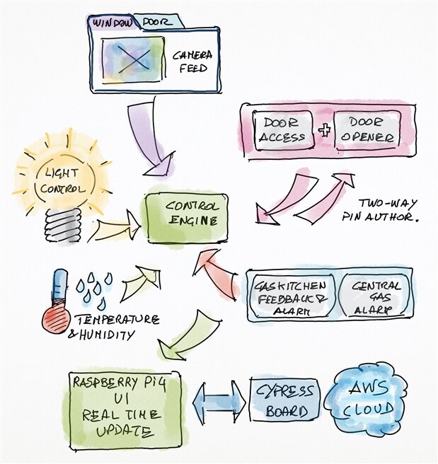

The Control Center is the core engine of the entire Super Smart Home. It is based on a Raspberry Pi 4B 4Gb configured as a desktop with many other features onboard. The  Control Center Desktop covers two important roles: keeps the real-time contact with the other nodes and collect data as well as alarms by one side and shows an interactive UI on the monitor by the other. Most of the tasks of the Control Center are accomplished in the background, including the communication with the Cypress PSoC6 WiFi BT Pioneer board that is the gateway with the important task to connect to the AWS Cloud for monitoring and controlling the Super Smart Home from remote. Going ahead with the design and development of the parts, the design of the nodes become more clear, as well as the kind of communication they should maintain with the Control Center.
We should note that a node of the Super Smart Home is not a simple device but is an autonomous structure acquiring local information and generating automatic feedback, as well as connecting to the Control Center to update the global status of its activity.

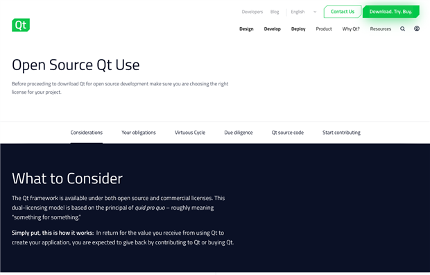

Below: the Qt open source version download page
Qt is available for all the platforms in two versions: Open Source and Commercial. The Open Source version is released under an LGPL (GNU Lesser) license so - if an entire application is developed with Qt - the developer has the obligation to include the libraries and mention the use of Qt in the same application. Some other minor limitations are related to paid license components we are not interested in this context. After downloading the universal installer it is sufficient to launch the standard installation to have the IDE - including the Qt designer - and all the essential Qt libraries to be able to design a UI and also compile the project to show immediately the effect.

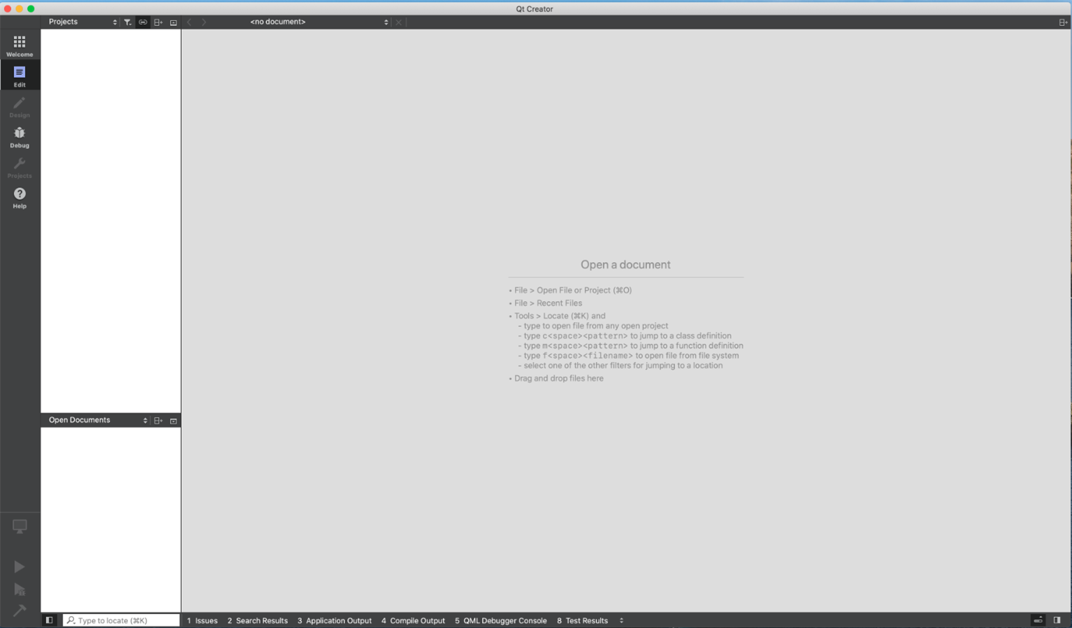

Above: the Qt Creator IDE where we should crate the projects and design the UI
Who has experienced the use of different development environments, especially on the Windows operating system knows how sometimes it is difficult to have on the same machine many different environments as some of them uses concurrently drivers and resources; the problems arise when installing an IDE another previously installed become unusable due to some component conflict. Qt instead is self-contained: after the installation of Qt Creator the libraries, compiler, meta compiler, and the IDE application are all included in a single "Qt" folder that can be moved everywhere in the computer without problems. When you run the Qt IDE all the environment settings are temporarily changed to create a good development environment without impacting other applications installed on the same machine.

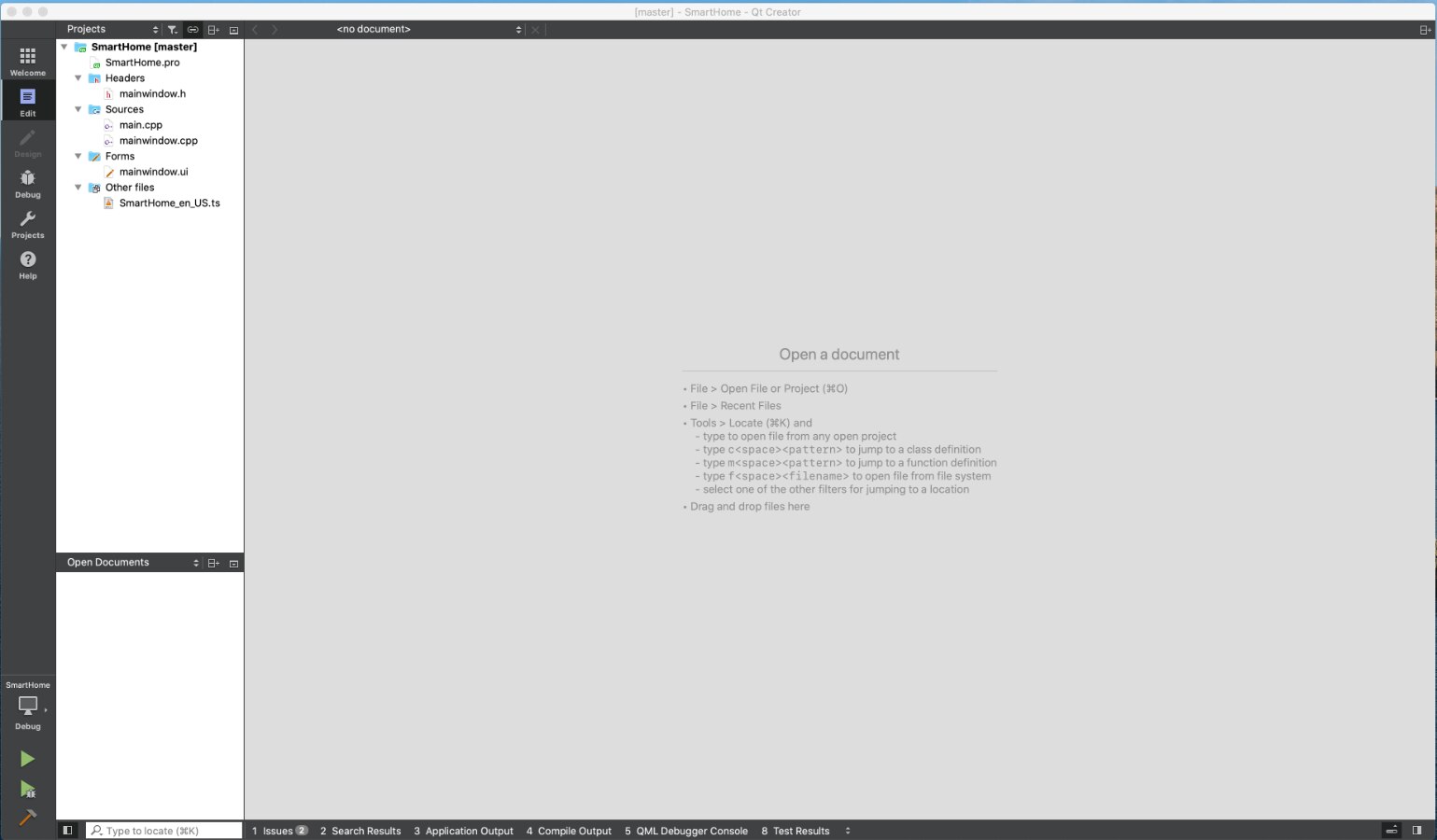

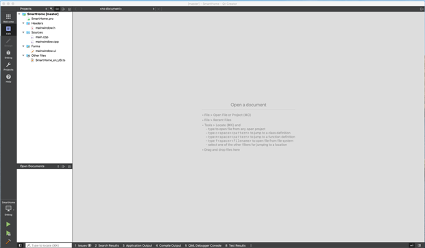

It is sufficient to create a new project of type Desktop main application to have all the basic components set and ready to support our MainWindow UI design.
Above: the Qt Creator with the basic files created automatically when the Super Smart Home MainWindow project has been generated.

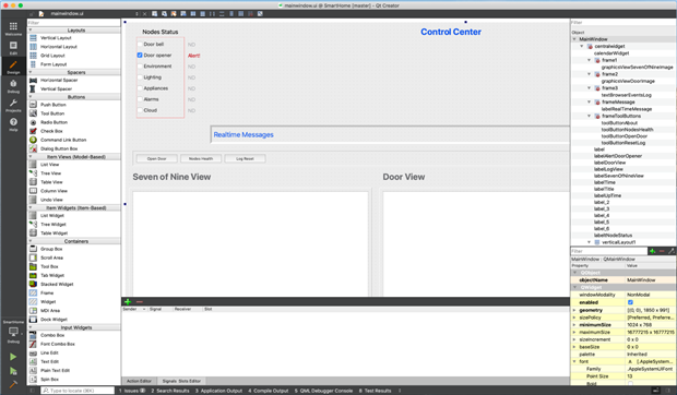

At this point, we can open the file "mainwindow.ui" and we automatically access to the UI designer. The image below shows the interface designed for the Desktop Control Center.
Note that despite we are interested in the interface design only, this file is part of a basic application whose sources have been created by the Qt Creator; this means we can immediately test the interface aspect in every moment simply running the project from the IDE. The image below shows the UI in the Max OSX environment.
Note that, as mentioned before, where possible Qt inherit the characteristics of the host operating system (fonts, window decorations, etc.) so the same interface may have a different aspect when running on a different platform.

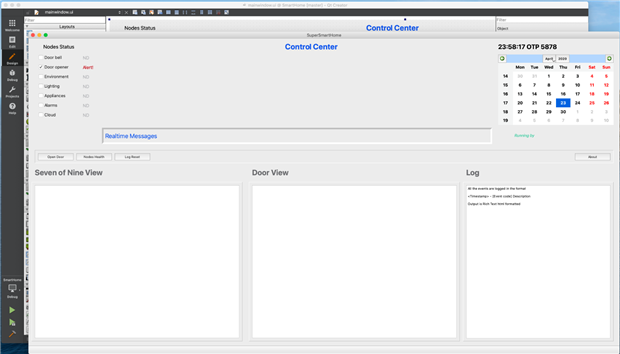

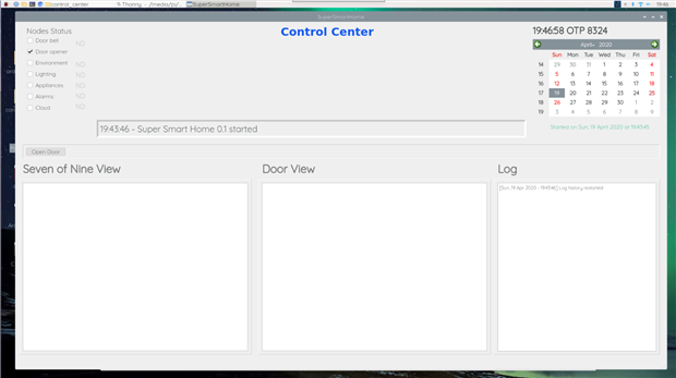

Above: the UI designed with the Qt Designer on Mac OSX rendered on the desktop screen of the Raspberry Pi 4B.
The next step in the UI creation workflow consists of making the interface available as a Python class in the Raspberry Pi environment. This is possible using PySide, a Qt-Python framework that can also compile the XML format or the UI files creating a Python class. A detailed tutorial on how to install the PySide framework on the Raspberry Pi is described here.
Warning on the Raspberry Pi 4B the standard repository includes the PySide UI files compiles mentioned above. Use the command
$>sudo apt-get install pyside-uic
To convert the Qt Ui file the process is easy; copy the mainwindow.ui file to the Raspberry Pi folder where you are developing the application and launch the command
$>pyside-uic mainwindow.ui > ui_mainwindow.py
That's all. The Python code below shows the Control Center interface Python class.

        self.checkBoxAlarmsStatus.setToolTip("")
        self.checkBoxAlarmsStatus.setCheckable(False)
        self.checkBoxAlarmsStatus.setObjectName("checkBoxAlarmsStatus")
        self.verticalLayout1.addWidget(self.checkBoxAlarmsStatus)
        self.checkBoxCloudConnectionStatus = QtGui.QCheckBox(self.verticalLayoutWidget)
        self.checkBoxCloudConnectionStatus.setMouseTracking(False)
        self.checkBoxCloudConnectionStatus.setToolTip("")
        self.checkBoxCloudConnectionStatus.setCheckable(False)
        self.checkBoxCloudConnectionStatus.setObjectName("checkBoxCloudConnectionStatus")
        self.verticalLayout1.addWidget(self.checkBoxCloudConnectionStatus)
        self.frameToolButtons = QtGui.QFrame(self.centralwidget)
        self.frameToolButtons.setGeometry(QtCore.QRect(20, 350, 1811, 41))
        self.frameToolButtons.setFrameShape(QtGui.QFrame.Panel)
        self.frameToolButtons.setFrameShadow(QtGui.QFrame.Sunken)
        self.frameToolButtons.setObjectName("frameToolButtons")
        self.toolButtonOpenDoor = QtGui.QToolButton(self.frameToolButtons)
        self.toolButtonOpenDoor.setGeometry(QtCore.QRect(10, 10, 111, 22))
        self.toolButtonOpenDoor.setFocusPolicy(QtCore.Qt.StrongFocus)
        self.toolButtonOpenDoor.setObjectName("toolButtonOpenDoor")
        self.toolButtonResetLog = QtGui.QToolButton(self.frameToolButtons)
        self.toolButtonResetLog.setGeometry(QtCore.QRect(250, 10, 111, 22))
        self.toolButtonResetLog.setFocusPolicy(QtCore.Qt.StrongFocus)
        self.toolButtonResetLog.setObjectName("toolButtonResetLog")
        self.toolButtonNodesHealth = QtGui.QToolButton(self.frameToolButtons)
        self.toolButtonNodesHealth.setGeometry(QtCore.QRect(130, 10, 111, 22))
        self.toolButtonNodesHealth.setFocusPolicy(QtCore.Qt.StrongFocus)
        self.toolButtonNodesHealth.setObjectName("toolButtonNodesHealth")
        self.toolButtonAbout = QtGui.QToolButton(self.frameToolButtons)
        self.toolButtonAbout.setGeometry(QtCore.QRect(1690, 10, 111, 22))
        self.toolButtonAbout.setFocusPolicy(QtCore.Qt.StrongFocus)
        self.toolButtonAbout.setObjectName("toolButtonAbout")
        self.labeltNodeStatus = QtGui.QLabel(self.centralwidget)
        self.labeltNodeStatus.setGeometry(QtCore.QRect(30, 11, 130, 30))
        font = QtGui.QFont()
        font.setPointSize(16)
        self.labeltNodeStatus.setFont(font)
        self.labeltNodeStatus.setObjectName("labeltNodeStatus")
        self.frameMessage = QtGui.QFrame(self.centralwidget)
        self.frameMessage.setGeometry(QtCore.QRect(230, 280, 1221, 51))
        palette = QtGui.QPalette()
        brush = QtGui.QBrush(QtGui.QColor(246, 250, 10))
        brush.setStyle(QtCore.Qt.SolidPattern)
        palette.setBrush(QtGui.QPalette.Active, QtGui.QPalette.Button, brush)
        brush = QtGui.QBrush(QtGui.QColor(255, 255, 255))
        palette.setBrush(QtGui.QPalette.Active, QtGui.QPalette.Base, brush)
        palette.setBrush(QtGui.QPalette.Active, QtGui.QPalette.Window, brush)
        palette.setBrush(QtGui.QPalette.Active, QtGui.QPalette.AlternateBase, brush)
        palette.setBrush(QtGui.QPalette.Inactive, QtGui.QPalette.Button, brush)
        palette.setBrush(QtGui.QPalette.Inactive, QtGui.QPalette.Base, brush)
        palette.setBrush(QtGui.QPalette.Inactive, QtGui.QPalette.Window, brush)
        palette.setBrush(QtGui.QPalette.Inactive, QtGui.QPalette.AlternateBase, brush)
        palette.setBrush(QtGui.QPalette.Disabled, QtGui.QPalette.Button, brush)
        palette.setBrush(QtGui.QPalette.Disabled, QtGui.QPalette.Base, brush)
        palette.setBrush(QtGui.QPalette.Disabled, QtGui.QPalette.Window, brush)
        palette.setBrush(QtGui.QPalette.Disabled, QtGui.QPalette.AlternateBase, brush)
        self.frameMessage.setPalette(palette)
        self.frameMessage.setFrameShape(QtGui.QFrame.Panel)
        self.frameMessage.setFrameShadow(QtGui.QFrame.Sunken)
        self.frameMessage.setLineWidth(5)
        self.frameMessage.setObjectName("frameMessage")
        self.labelRealTimeMessage = QtGui.QLabel(self.frameMessage)
        self.labelRealTimeMessage.setEnabled(True)
        self.labelRealTimeMessage.setGeometry(QtCore.QRect(10, 10, 1201, 31))
        brush = QtGui.QBrush(QtGui.QColor(172, 173, 8))
        brush = QtGui.QBrush(QtGui.QColor(246, 250, 10, 128))
        self.labelRealTimeMessage.setPalette(palette)
        font.setPointSize(19)
        self.labelRealTimeMessage.setFont(font)
        self.labelRealTimeMessage.setObjectName("labelRealTimeMessage")
        self.label = QtGui.QLabel(self.centralwidget)
        self.label.setEnabled(False)
        self.label.setGeometry(QtCore.QRect(170, 50, 58, 21))
        self.label.setFont(font)
        self.label.setObjectName("label")
        self.labelAlertDoorOpener = QtGui.QLabel(self.centralwidget)
        self.labelAlertDoorOpener.setEnabled(True)
        self.labelAlertDoorOpener.setGeometry(QtCore.QRect(170, 80, 58, 21))
        self.labelAlertDoorOpener.setFont(font)
        self.labelAlertDoorOpener.setObjectName("labelAlertDoorOpener")
        self.labelUpTime = QtGui.QLabel(self.centralwidget)
        self.labelUpTime.setGeometry(QtCore.QRect(1520, 280, 301, 41))
        brush = QtGui.QBrush(QtGui.QColor(22, 175, 129))
        palette.setBrush(QtGui.QPalette.Active, QtGui.QPalette.WindowText, brush)
        palette.setBrush(QtGui.QPalette.Inactive, QtGui.QPalette.WindowText, brush)
        brush = QtGui.QBrush(QtGui.QColor(0, 0, 0, 63))
        palette.setBrush(QtGui.QPalette.Disabled, QtGui.QPalette.WindowText, brush)
        self.labelUpTime.setPalette(palette)
        font.setPointSize(12)
        self.labelUpTime.setFont(font)
        self.labelUpTime.setObjectName("labelUpTime")
        self.label_2 = QtGui.QLabel(self.centralwidget)
        self.label_2.setEnabled(False)
        self.label_2.setGeometry(QtCore.QRect(170, 110, 58, 21))
        self.label_2.setFont(font)
        self.label_2.setObjectName("label_2")
        self.label_3 = QtGui.QLabel(self.centralwidget)
        self.label_3.setEnabled(False)
        self.label_3.setGeometry(QtCore.QRect(170, 140, 58, 21))
        self.label_3.setFont(font)
        self.label_3.setObjectName("label_3")
        self.label_4 = QtGui.QLabel(self.centralwidget)
        self.label_4.setEnabled(False)
        self.label_4.setGeometry(QtCore.QRect(170, 170, 58, 21))
        self.label_4.setFont(font)
        self.label_4.setObjectName("label_4")
        self.label_5 = QtGui.QLabel(self.centralwidget)
        self.label_5.setEnabled(False)
        self.label_5.setGeometry(QtCore.QRect(170, 200, 58, 21))
        self.label_5.setFont(font)
        self.label_5.setObjectName("label_5")
        self.label_6 = QtGui.QLabel(self.centralwidget)
        self.label_6.setEnabled(False)
        self.label_6.setGeometry(QtCore.QRect(170, 230, 58, 21))
        self.label_6.setFont(font)
        self.label_6.setObjectName("label_6")
        MainWindow.setCentralWidget(self.centralwidget)
        self.statusbar = QtGui.QStatusBar(MainWindow)
        self.statusbar.setObjectName("statusbar")
        MainWindow.setStatusBar(self.statusbar)
        self.actionSystem = QtGui.QAction(MainWindow)
        self.actionSystem.setObjectName("actionSystem")
        self.actionConsole = QtGui.QAction(MainWindow)
        self.actionConsole.setObjectName("actionConsole")
        self.actionLog = QtGui.QAction(MainWindow)
        self.actionLog.setObjectName("actionLog")
        self.retranslateUi(MainWindow)
        QtCore.QMetaObject.connectSlotsByName(MainWindow)
    def retranslateUi(self, MainWindow):
        MainWindow.setWindowTitle(QtGui.QApplication.translate("MainWindow", "SuperSmartHome", None, QtGui.QApplication.UnicodeUTF8))
        self.labelSevenOfNineView.setText(QtGui.QApplication.translate("MainWindow", "<html><head/><body><p><span style=\" color:#6b6c6f;\">Seven of Nine View</span></p></body></html>", None, QtGui.QApplication.UnicodeUTF8))
        self.labelDoorView.setText(QtGui.QApplication.translate("MainWindow", "<html><head/><body><p><span style=\" color:#6b6c6f;\">Door View</span></p></body></html>", None, QtGui.QApplication.UnicodeUTF8))
        self.labelLogView.setText(QtGui.QApplication.translate("MainWindow", "<html><head/><body><p><span style=\" color:#6b6c6f;\">Log</span></p></body></html>", None, QtGui.QApplication.UnicodeUTF8))
        self.textBrowserEventsLog.setHtml(QtGui.QApplication.translate("MainWindow", "<!DOCTYPE HTML PUBLIC \"-//W3C//DTD HTML 4.0//EN\" \"http://www.w3.org/TR/REC-html40/strict.dtd\">\n"
"<html><head><meta name=\"qrichtext\" content=\"1\" /><style type=\"text/css\">\n"
"p, li { white-space: pre-wrap; }\n"
"</style></head><body style=\" font-family:\'.AppleSystemUIFont\'; font-size:10pt; font-weight:400; font-style:normal;\">\n"
"<p style=\" margin-top:0px; margin-bottom:0px; margin-left:0px; margin-right:0px; -qt-block-indent:0; text-indent:0px;\">All the events are logged in the format</p>\n"
"<p style=\"-qt-paragraph-type:empty; margin-top:0px; margin-bottom:0px; margin-left:0px; margin-right:0px; -qt-block-indent:0; text-indent:0px;\"><br /></p>\n"
"<p style=\" margin-top:0px; margin-bottom:0px; margin-left:0px; margin-right:0px; -qt-block-indent:0; text-indent:0px;\"><Timestamp> - [Event code] Description</p>\n"
"<p style=\" margin-top:0px; margin-bottom:0px; margin-left:0px; margin-right:0px; -qt-block-indent:0; text-indent:0px;\">Output is Rich Text html formatted</p></body></html>", None, QtGui.QApplication.UnicodeUTF8))
        self.labelTime.setText(QtGui.QApplication.translate("MainWindow", "23:58:17 OTP 5878", None, QtGui.QApplication.UnicodeUTF8))
        self.labelTitle.setText(QtGui.QApplication.translate("MainWindow", "<!DOCTYPE HTML PUBLIC \"-//W3C//DTD HTML 4.0//EN\" \"http://www.w3.org/TR/REC-html40/strict.dtd\">\n"
"</style></head><body style=\" font-family:\'.AppleSystemUIFont\'; font-size:20pt; font-weight:400; font-style:normal;\">\n"
"<p align=\"center\" style=\" margin-top:0px; margin-bottom:0px; margin-left:0px; margin-right:0px; -qt-block-indent:0; text-indent:0px;\"><span style=\" font-size:24pt; font-weight:600; color:#1358ed;\">Control Center</span></p></body></html>", None, QtGui.QApplication.UnicodeUTF8))
        self.checkBoxDoorBellStatus.setText(QtGui.QApplication.translate("MainWindow", "Door bell", None, QtGui.QApplication.UnicodeUTF8))
        self.checkBoxDoorOpenerStatus.setText(QtGui.QApplication.translate("MainWindow", "Door opener", None, QtGui.QApplication.UnicodeUTF8))
        self.checkBoxEnvironmentStatus.setText(QtGui.QApplication.translate("MainWindow", "Environment", None, QtGui.QApplication.UnicodeUTF8))
        self.checkBoxLightingStatus.setText(QtGui.QApplication.translate("MainWindow", "Lighting", None, QtGui.QApplication.UnicodeUTF8))
        self.checkBoxAppliancesStatus.setText(QtGui.QApplication.translate("MainWindow", "Appliances", None, QtGui.QApplication.UnicodeUTF8))
        self.checkBoxAlarmsStatus.setText(QtGui.QApplication.translate("MainWindow", "Alarms", None, QtGui.QApplication.UnicodeUTF8))
        self.checkBoxCloudConnectionStatus.setText(QtGui.QApplication.translate("MainWindow", "Cloud", None, QtGui.QApplication.UnicodeUTF8))
        self.toolButtonOpenDoor.setText(QtGui.QApplication.translate("MainWindow", "Open Door", None, QtGui.QApplication.UnicodeUTF8))
        self.toolButtonResetLog.setText(QtGui.QApplication.translate("MainWindow", "Log Reset", None, QtGui.QApplication.UnicodeUTF8))
        self.toolButtonNodesHealth.setText(QtGui.QApplication.translate("MainWindow", "Nodes Health", None, QtGui.QApplication.UnicodeUTF8))
        self.toolButtonAbout.setText(QtGui.QApplication.translate("MainWindow", "About", None, QtGui.QApplication.UnicodeUTF8))
        self.labeltNodeStatus.setText(QtGui.QApplication.translate("MainWindow", "<html><head/><body><p align=\"center\">Nodes Status</p></body></html>", None, QtGui.QApplication.UnicodeUTF8))
        self.labelRealTimeMessage.setText(QtGui.QApplication.translate("MainWindow", "<html><head/><body><p><span style=\" color:#1358ed;\">Realtime Messages</span></p></body></html>", None, QtGui.QApplication.UnicodeUTF8))
        self.label.setText(QtGui.QApplication.translate("MainWindow", "<html><head/><body><p><span style=\" font-size:14pt; color:#adaeb2;\">ND</span></p></body></html>", None, QtGui.QApplication.UnicodeUTF8))
        self.labelAlertDoorOpener.setText(QtGui.QApplication.translate("MainWindow", "<html><head/><body><p><span style=\" font-size:14pt; color:#c3000b;\">Alert!</span></p></body></html>", None, QtGui.QApplication.UnicodeUTF8))
        self.labelUpTime.setText(QtGui.QApplication.translate("MainWindow", "<html><head/><body><p><span style=\" font-size:18pt; font-style:italic; color:#19c691; vertical-align:sub;\">Running by </span></p></body></html>", None, QtGui.QApplication.UnicodeUTF8))
        self.label_2.setText(QtGui.QApplication.translate("MainWindow", "<html><head/><body><p><span style=\" font-size:14pt; color:#adaeb2;\">ND</span></p></body></html>", None, QtGui.QApplication.UnicodeUTF8))
        self.label_3.setText(QtGui.QApplication.translate("MainWindow", "<html><head/><body><p><span style=\" font-size:14pt; color:#adaeb2;\">ND</span></p></body></html>", None, QtGui.QApplication.UnicodeUTF8))
        self.label_4.setText(QtGui.QApplication.translate("MainWindow", "<html><head/><body><p><span style=\" font-size:14pt; color:#adaeb2;\">ND</span></p></body></html>", None, QtGui.QApplication.UnicodeUTF8))
        self.label_5.setText(QtGui.QApplication.translate("MainWindow", "<html><head/><body><p><span style=\" font-size:14pt; color:#adaeb2;\">ND</span></p></body></html>", None, QtGui.QApplication.UnicodeUTF8))
        self.label_6.setText(QtGui.QApplication.translate("MainWindow", "<html><head/><body><p><span style=\" font-size:14pt; color:#adaeb2;\">ND</span></p></body></html>", None, QtGui.QApplication.UnicodeUTF8))
        self.actionSystem.setText(QtGui.QApplication.translate("MainWindow", "System", None, QtGui.QApplication.UnicodeUTF8))
        self.actionConsole.setText(QtGui.QApplication.translate("MainWindow", "Console", None, QtGui.QApplication.UnicodeUTF8))
        self.actionLog.setText(QtGui.QApplication.translate("MainWindow", "Log", None, QtGui.QApplication.UnicodeUTF8))
