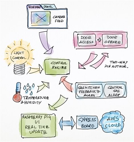

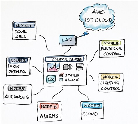

What is "Super Smart Home"? the idea is to create a network-based distributed system that can keep under control all the aspects that may be strategical in a private home.

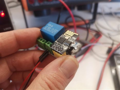

In this second post, I have experimented with the control of actuators using the small ESP8266 designing a door opener controller. This part involved both software and a couple of electronic boards designed from scratch to test and program the microcontroller
3. The Control Center
Super Smart Home #3 Designing the Control Center
Based on the Super Smart Home proof of concept I developed the Raspberry Pi 4B Control Center: a Python application with the UI created with Qt Designer and converted to a Python class using PySide.

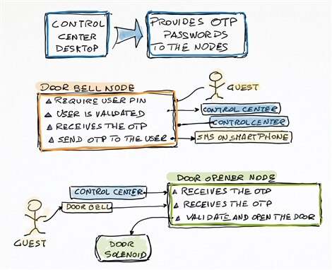

In this post, I illustrate how I implemented an HTTPS server on the ESP8266 controlled through REST APIs from the Control Center. I have also implemented a dual-way pin OTP password authentication.

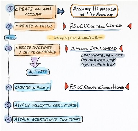

6. Building a PSoC6 IoT Gateway Connected to the AWS IoT Core
Super Smart Home #6 PSoC6 On the Cloud
In this post, I illustrate how I have created an IoT Gateway with the PSoC6, through a secure connection to the AWS IoT Core using strong private/public keys and an authorization certificate.

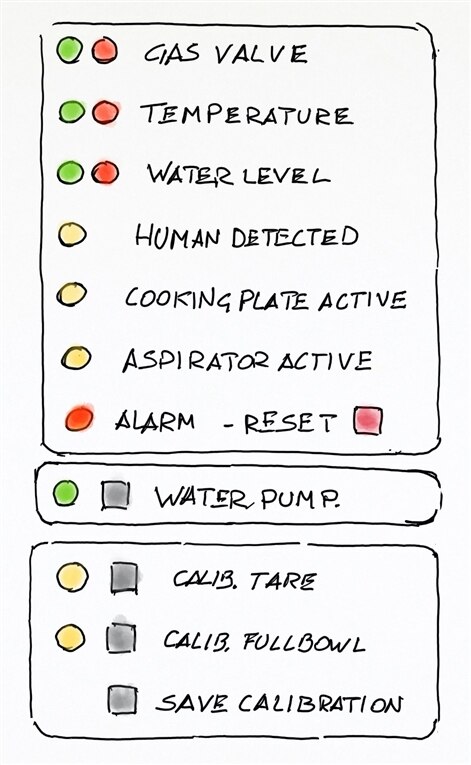

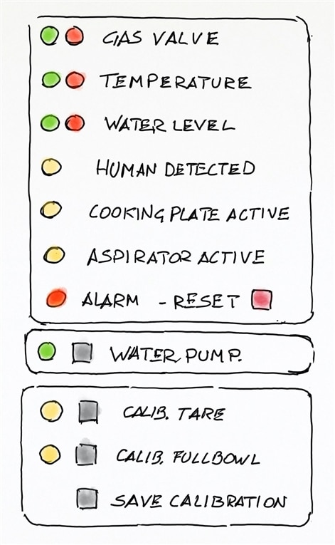

In this post, I illustrate how I have managed a series of sensors and actuators, including temperature measurement and gas monitoring, to control the health status of a complex room as well as implementing efficient feedback to avoid and minimize risky conditions.
9. Managing Actuators, Feedback, Alarms, and Notifications Rising the Status to the AWS IoT Cloud
Super Smart Home #9 The Kitchen Node: Circuit and Software
In this post, I presented the development of a complex C and C++ application for the Arduino Mega 2560: the creation of a state machine that can provide immediate feedback reacting to potentially dangerous situations, as well as avoiding risky conditions. Every meaningful change in the state machine (alarm, events, notifications) is sent upward to the Control Center that update the strategical information to the AWS IoT cloud via the connected PSoC6

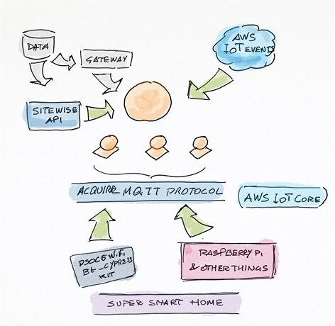

Connecting the PSoC6 WiFi Bt kit to the AWS IoT Cloud

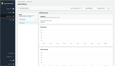

Experimenting just for testing or trying how a certain system works maybe interesting but approaching a complex, geographical architecture to reach a specific goal is really challenging; this is what happened when I had to study how to set the communication between the local PSoC6 device connected to the Internet and the remote AWS IoT Core. And things come more complex when I decided to adopt a flexible and modular platform as the AWS SiteWise assets portal for data representation as I tried to show in the two posts Super Smart Home #6 PSoC6 On the Cloud and Super Smart Home #7 From AWS IoT Core to AWS SiteWise
The aspect I more appreciated of the AWS IoT services features (I only used the IoT Core and SiteWise but there is plenty of other possibilities), is the scalability of the IoT ecosystem implemented by AWS. As much the remote structure grows and expands, as much the AWS IoT architecture can be easily adapted to a modelization optimized for data representation and clustering the information in well understandable structures (graphs and tables).
Above: the Super Smart Home portal created with SiteWise in the AWS IoT ecosystem, connected to the PSoC6, secured with a strong private/public key and certificate.

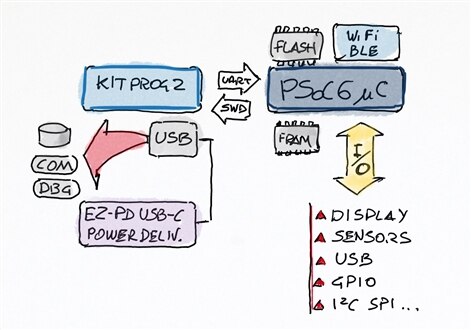

Programming the PSoC6 with both AWS RTOS and Mbed
After trying with success connecting the PSoC6 to the AWS IoT Core using the Cypress version of the AWS RTOS, specific for the PSoC6 (and some other Cypress IoT enabled platforms), I also tried programming the PSoC6 with Mbed OS. And in both cases, the documentation and development environment included excellent documentation. My conclusion is that RTOS is a good development platform but where possible I think I will continue developing with the Mbed OS; the advantage that, in my opinion, this second platform offers – but the investigation is fat to be concluded – is the compatibility with many other devices, including the BBC micro:bit I use frequently in my projects. So, probably, the knowledge and software developed for one platform can be easily adapted and recycled (saving a lot of time) on different platforms as well (see more on Super Smart Home #10 Building IoT nodes with PSoC6-WiFi-Bt and Mbed OS )

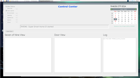

Developing User Interfaces for Python with Qt and PySide
In the past, I have already tried several solutions to design UI for Python programs on the Raspberry Pi. I tried Kivi, an efficient Python library; the approach of this tool is oriented in the creation of dynamics interfaces running on small screens with a lot of possibilities (and complexities) to present efficiently a lot of data on a small screen thanks to fast menus, pop-up windows, list boxes, and many other widgets. Not the ideal choice for a big screen and the kind of interface I had in mind. Another possibility was using the Python library PyGame but in this case, the best performances of this set of graphical features are for making games; using PyGame for a more traditional UI requires some strong customization and considerably reducing the features.
To make a complex interface design in Python for the Raspberry Pi 4B Control Center, instead, I decided to use Qt. I develop on the multiplatform Qt environment by almost ten years but I never faced the problem in these terms: designing the interface using Qt Designer (a component part of the Qt Creator IDE) then converting the design file to a Python class using PySide. I should admit that this was a lucky choice as the result had been efficient and reliable as discussed in the post Super Smart Home #3 Designing the Control Center
Below: The Control Center Python main program and the Qt designed UI running on the Raspberry Pi 4B

ESP8266-01 is the component I risked more selecting the parts; it was the first time I was using this microcontroller and now I should say it has been a good choice: It is small, cheap, and really powerful, obviously with its own challenging issues. I studied the ESP in detail making the design of the Door Opener in the post Super Smart Home #2 The Door Opener In the past I developed hundred of web sites and web applications; before this challenge, the smaller device I worked with has been the Nokia Maemo and the experience of seeing a couple of square centimeters of technology able to connect to the WiFi running an SSL/TLS web server with a lot of possibilities was really exciting.

    I like the way you illustrate... nice sketches!
