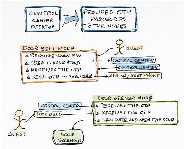

Door Opener Node Architecture and API
After that the Door Opener hardware has been assembled and tested I have developed the final software. The activation of the Door Opener functionality is also the step to create the Control Center's first software parts, covering most of the features that are common to all the nodes. The image below shows the data that should be exchanged between the Door Opener node and the controller. It should also be considered that the Door Opener is operated through the Door Bell node, as well as directly from a button on the Control Center interface.

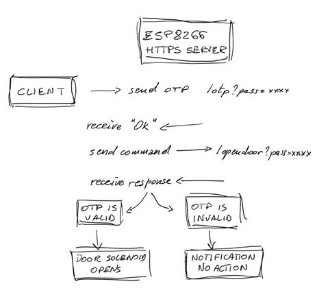

Below: the two-ways door opener APIs implemented in the ESP8266
The APIs
/otp
Description: Expect the OTP password pin that will
Parameter: pass
Value: 4 numeric digits
Return: "Ok"
/opendoor
Description: Activates the door solenoid if the OTP password is the same received by a previous call to the /otp API
Parameter: pass
Return: "ESP8266 Door Opened"
The Two-way Password Implementation
As shown in the scheme above the door opener never receives the OTP password twice from the same device. When the guest pulses his code on the doorbell numeric keyboard, it is sent to the Control Center that validates the user. If the user is recognized, he receives the OTP password on his smartphone. The same password is sent to the door opener via the /otp API. If the guest presses the received OTP password on the smartphone, it is sent to the Door Opener via the /opendoor API. If the password match with the one previously received by the Door Opener from the Control Center, the door opens else the password is deleted and the door remains closed.

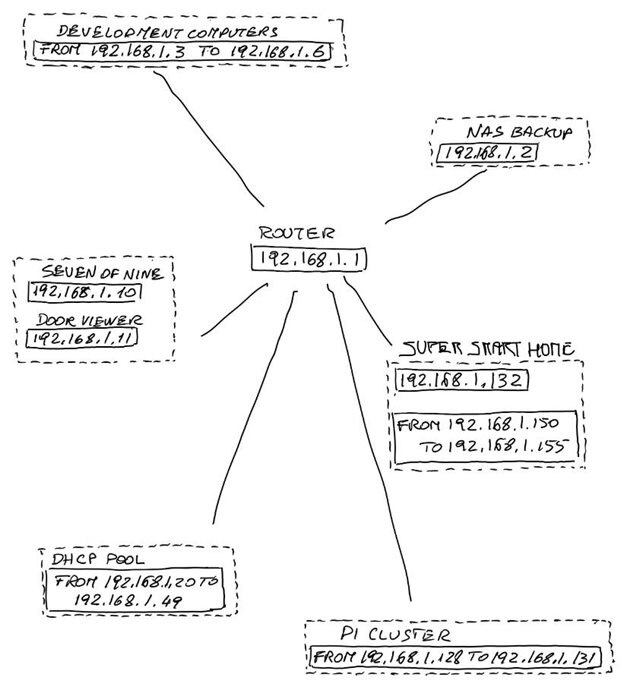

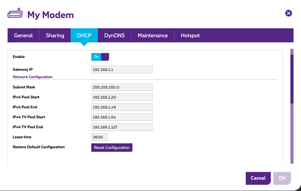

A Consideration on the IP Address of the Devices
In the majority of the examples connecting IoT devices and other physical computing boards (including the Raspberry Pi) to the LAN are always shown strange and complex tricks to detect the dynamics IP address assigned by the Internet router. This approach may work for experimenting and testing but in a local distributed network it is not a good idea. Taking into account that all the Internet routes do not reserve all the available local IP addresses to the DHCP but only a part, in my project I always prefer to adopt static IP addresses, easily to manage a well-structured network map.
Below: as an example, the DHCP settings I have assigned to my router to keep some IP address pools free to be assigned to specific devices.
Based on the DHCP and router parameters shown in the above image the current network map I am using is shown in the scheme below.
Despite the number of devices connected to the network, there are not many different users; for this reason, it is sufficient a simple topology but in the case that some group of IP addresses should not communicate with others (i.e. in a company network with different departments) I had to create isolated subnets.

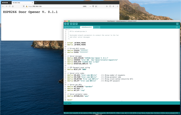

The full source of the ESP8266 server is available on the GitHub repository SuperSmartHome.
The image below shows the test of the ESP8266 Web server using the Firefox browser.
