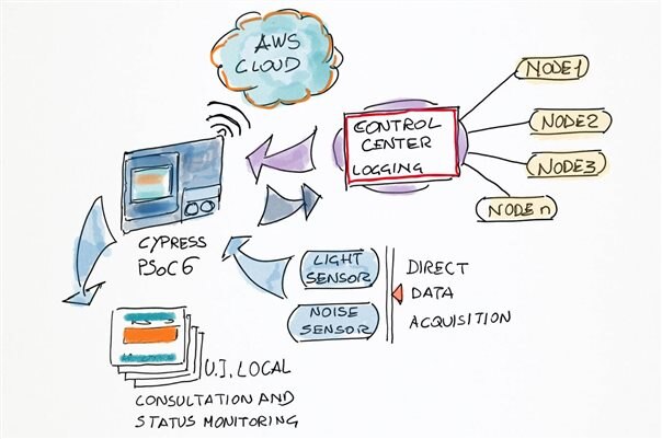

Conditioned by the roled of the PSoC6 Cloud Node the scheme below shows the software skeleton and the UI schema:
While the PSoC6 is one of the endpoints of the Super Smart Home IoT network its UI role is for monitoring and consultation only for which I planned to use the FTF screen included with the PSoC6 Kit. The application active part instead should connect in a secure way to the Raspberry Pi 4B Control Center receiving the log, buffered on one of the monitoring pages of the interface (there is not a story of the log saved locally, as it is already done by the Control Center), as well as sending its status to the Raspberry Pi.
The other active part is dedicated to the timed acquisition of the light level and noise level; these two environmental values are acquired and interpolated by the PSoC6 program while only the alarm triggered values – daylight and dark light changes, and over the preset limits of the noise level – are sent to the Control Center.
Both the logged statuses from the Control Center and the environmental sensor values are updated through the MQTT shadows to the  AWS IoT console to be displayed on the SiteWise web.

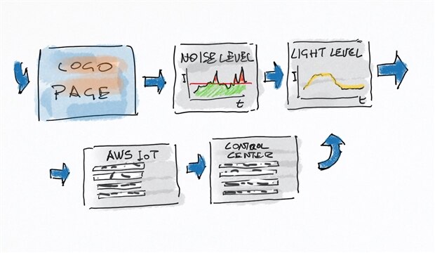

The above scheme shows the strategy I adopted to monitor all the data through a simple user interaction; due to the reduced TFT screen resolution of the PSoC6 kit every group of data has been organized on a page (a single view of the TFT display). The pages are visible in sequence scrolling in both directions with the two Capsense buttons. Also if I plan to add more pages in the future it is not difficult to add others in the middle.

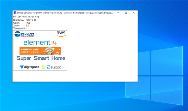

Also in the same site emWin includes a lot of useful software utilities (Window only) to convert images, videos, and fonts in the format accepted by the emWin library. It is possible to access this stuff and download it for free only after registering on the Segger portal. Ther I found the bitmap conversion program to generate the code for the PSoC6 TFT display.
The above image shows the image conversion tool I have used to generate the graphic content shown on the main page of the PSoC6 TFT on boot.

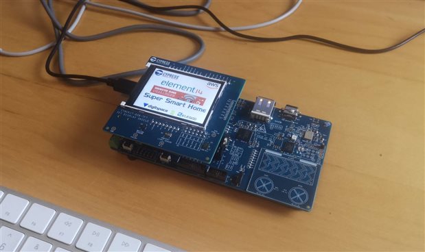

Above: the final result, shown on the TFT display of the PSoC6 WiFi BT Pioneer kit.

    balearicdynamics over 6 years ago in reply to Jan Cumps
    Jan,
    as the same Samyak wrote:
    After analyzing the input file and output file of Image to Bitmap Converter I have created my own code which can be deployed on Server and convert Image files into C-style streamable format.
    as far as I know, he has created his own Python script. This is the reason I have not mentioned it. I suppose there are hundreds of image converters out there, what I mean is that despite the Segger utility instead of making your own code you can dig a while in Google to find many methods. I have just used ImageMagick because it is the one I already use in my cluster.
    Enrico
    Jan Cumps over 6 years ago in reply to balearicdynamics
    balearicdynamics  wrote:
    .... There is the convert command in the imagemagick (version 5 and over if I am not wrong) to which, giving a header file name as the second parameter, it converts the source (png, bmp, jpeg, ...) to an unsigned char array of bytes defined in the generated header.
    There's also a python utility that can do the image to C conversion. Used by Samyak:  Connected Cloud Challenge - IoT based Advertisement BillBoards/Hordings - #BlogPost-10 Image to C-Style Stream Conversion
    phoenixcomm Cris, me too! But I work on Mac and Linux as you know. So emWin is NOT Windows image! It is the Segger library for embedded devices. The whole project (and the PSoC6 software) has been developed on Mac with Modus Toolbox and wmWire is just one of the components of the Mbed OS I compile while creating the elf firmware (then linking, making the hex, etc.)
    The only "application" I mentioned here Windows10 based, is the image converter. I mentioned (and tried) it just for the users that can approach the same problem and solve it in a canonical way. Well, instead I have found another way (maybe I mentioned some comments before), and used it, that is imagemagick running on my four Pi Cluster I use normally to automatically resize the images for the web and assemble the timelapse sequences in videos. There is the convert command in the imagemagick (version 5 and over if I am not wrong) to which, giving a header file name as the second parameter, it converts the source (png, bmp, jpeg, ...) to an unsigned char array of bytes defined in the generated header.
