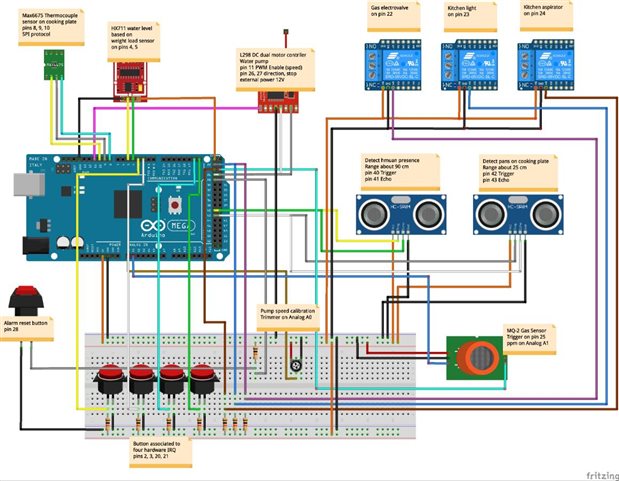

The Circuit
The three relays of the Four Channels Reay board, are used to activate the gas electro valve – normally closed, 12V operated – and power separately the hood light and fan aspirator.
The L298 motor controller can drive up to two DC motors but in this case, it is used only one channel to control the water pump. I have connected the enable signal to a PWM pin of the Arduino 2560 to be able to regulate the water pump speed. In fact, depending on the position of the refill water pipe it is useful to have a fine-tuning setting of the quantity of water per minute. The water pump DC motor speed does not need to be frequently calibrated; it is sufficient a trimmer on the board (connected to the A0 analog input) to set the optimal speed when the system is put in place.
The two HC-SR04 ultrasonic sensors are set one to the bottom of the hood pointing to the area in front of the cooking plate to detect the presence of a person and the other aligned immediately above the cooking plate. This is used to detect if a pan or something is put over the cooking plate, to avoid that there are flames while the plate is empty.
As the MQ-02 gas sensor detects combustible gas only if there is no flame, it will operate in conjunction with the Max6675 thermocouple and the ultrasound pan detector. The interpolation of the status of these three sensors can provide the following information:
  • The cooking plate is active and working correctly
  • The gas is open but there is no flame (ALARM)
  • There is a flame on the cooking plate but no pan, no person present (ALARM)
The circuit includes four buttons connected to four of the six external interrupts of the Arduino Mega 2560. These buttons control priority activities, not impacting the normal sensors checking and monitoring:
  1. Calibrate the weight of bowl the tare (empty bowl)
  2. Calibrate the weight of the full water bowl
  3. Save the current calibration to the Arduino Mega EEPROM
  4. Manual feed water (when the manual operation is needed)
If the water bowl levels are calibrated, during the normal operativity the bowl level is controlled by the HX711 load weight sensor and is automatically refilled when the water level in the bowl reaches 10% or less.
There is a fifth button, not active during the normal activity, used to manual unlock an alarm condition. All the buttons are pulled-up by a 10K resistor.
To avoid making a too complex circuit just adding obvious stuff, in the schematics above I have excluded the ESP8266-01 connected to serial 2 of the Arduino Mega and the notification LEDs connected to some of the still available digital pins. All the LEDs just need a digital pin and a 220 Ohm resistor connected to the ground, while the ESP needs a voltage regulator to sync the signal levels and the power supply to the Arduino 5V. Note that in this case, I don't use the 3.3V available on the Arduino GPIO because ESP8266 needs a few more power to work correctly.
To the Serial 3 instead, it is connected the microSD player used to generate audio messages for alarm signaling.

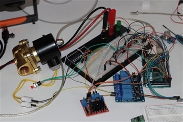

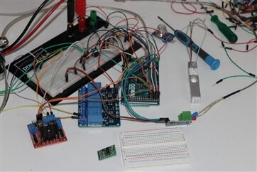

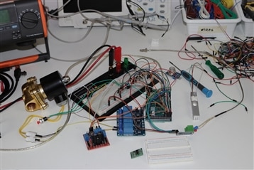

Above: some images showing the first prototyping of the Arduino Mega circuit connected to the sensors and actuators. The final circuit will be assembled on a Mega prototyping shield.

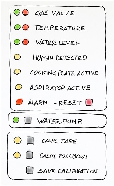

Local Node Status
Notification LEDs and control buttons will be available on the node box, constantly updated by the Alarms and notifications block.
The scheme above shows the panel control of the Kitchen Node:
  • Green LEDs – When On, the corresponding component is active and working. When off, the component is not active.
  • Red LEDs – When On, the corresponding component has generated an alarm condition. When off, the component is healthy.
  • Orange LEDs – The orange LEDs are On when the corresponding component is active or the associated sensor has detected activity.
  • Red square button – When an alarm condition occurs, the general Alarm LED is on and the condition should be manually reset by this button.
  • Water Pump block – When the Water Pump LED is active, the pump is refilling the dog water bowl. For any need, including the calibration, the water pump can also be run manually with the corresponding button.
