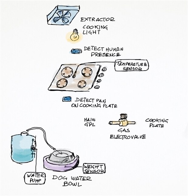

Water Bowl
The doc water bowl should be kept refilled with fresh water pumped from a 10 liters canister profiting water to the dog when he is alone at home.
Gas
The gas last pipe is controlled by a specific gas electro valve. This solution permits to keep under control the gas flow only when needed.
Cooking Plate
The cooking plate is the riskiest part of the kitchen environment and should only work when it is used for cooking. With a few modifications, the module can also be modified to be applicable to glass-ceramic inductive cooking plates.
Cooking Light and Aspirator Fan
The hood light over the cooking plate use should be optimized and powered only when someone is nearby the area. The aspirator fan, instead, should be activated when the temperature reaches a trigger value (I set to 100 C) and should run until the cooking has been completed.

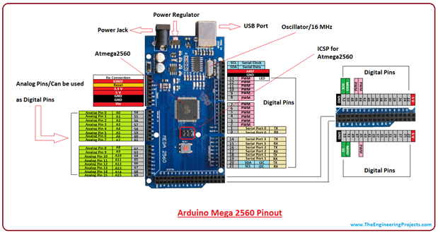

Due to the considerable number of different signals to be managed, I decided to use an Arduino Mega 2560Arduino Mega 2560 as the main microcontroller unit.
I have used a release 3 model (a bit different in the board components disposition) but the pinout above of the previous hardware release is more complete showing the entire pinout. The reason for this choice is not only based on the number of available GPIO pins but also because there are multiple TTL serials that can simplify to include (both connected with TTL serial) the ESP8266 IoT Web Server and the microSD mp3 player used for voice alerts and notifications.

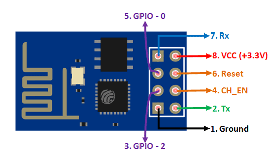

The access to the WiFi local network (all the Super Smart Home nodes are connected to the Control Center Raspberry Pi) is granted by an ESP8266-01 configured as an HTTPS web server.

  • Two HC-SR04 ultrasonic sensors for the activity detection nearby the cooking plate; one sensor is used to detect human presence while the other is targeted a few centimeters above the cooking plate to detect the presence of pans.
  • A MQ-02 gas sensor to detect the presence of gas with no flame.
  • An HX711 load weight sensor to detect the weight of the water in the water dog bowl
  • A Max6675 thermocouple to monitor the cooking plate temperature
