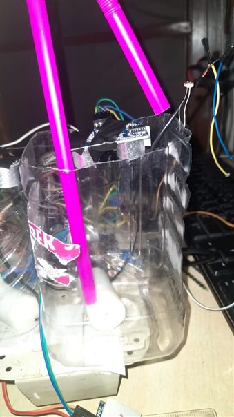

In this blog, we will create the setup for the irrigation system of the farm using our bot.

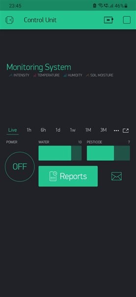

We will use an ultrasonic sensor to measure the water level in the container. Once the water level falls below a certain threshold, we will send an email using the Blynk App. Also we will send level of our water container to the Blynk App continuously so it can be looked at any time. For the automatic irrigation system, whenever the moisture value of the soil is lower than a certain value, the pump would turn on and water the crop. For this, an L293D module was used as before.
I will not go to deeply into each component and wiring as it is almost similar to #03: Setting up the AgroBot
Whenever the distance from the Ultrasonic sensor was less than 3, we sent an email warning to refill the tank.
//sending email when water level falls below 3
  if (cm < 3)
    Blynk.email("Water level alert", "Fill water in the container");
Whenever the moisture level was less than 60(chosen randomly here), we will water the crop using the pump.
//for watering the crop below 60 moisture level
  if(moisture_value < 60)
   digitalWrite(motorA1,HIGH);
  digitalWrite(motorA2,LOW);
   delay(100);
   digitalWrite(motorA1,LOW);
To send data to the Blynk App, I used the below snippet. In the App, I set PIN as V0 and widget level H
  Blynk.virtualWrite(V0, water_level());

//for email warning
  if (cm < 3)
  return cm;
