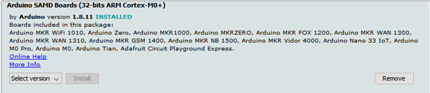

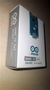

Our main aim for this blog, is to setup the Arduino Nano 33 IOT(the kit). We would need to do a few setup changes to the Arduino IDE for this. As the other boards like the Arduino Uno are a little different from this board.
To use this board, we need to go to the Board Manager and download Arduino SAMD Boards.

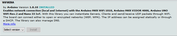

To connect this board to WiFi, we need WiFiNINA library. You can download this from Library Manager.

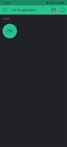

Blynk Setup:
  • To do this, create a new project in Blynk.
  • Name your project.
  • Choose device as "Arduino Nano"
  • Choose connection type as " Wifi"
  • Choose any theme of your choice
  • The authorization token will be sent to your registered email.
  • Using the "+" button in the top bar, add a Button
  • Click on the newly added Button
  • Set Output Pin to "D13"
  • Name the Button as "Led"

Just upload this code to the board. After that open the Blynk App and run the project.
When you press the button, the LED will turn on. Pressing again will turn off the LED.
