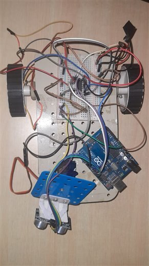

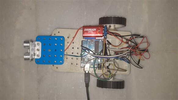

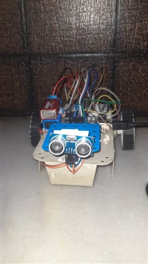

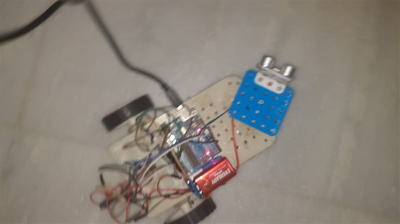

In this blog, we will set up the bot for automatic movement around the farm.
For this part of the project, I used an Ultrasonic sensor to measure distance. The bot moves around the farm and whenever detects an object it is able to find it's own path out. In this way, it can move around entire farm. The motors are controlled using Arduino and L293D IC. I had to use two batteries as my single battery didn't provide enough current to take the load of the bot. Further, the ultrasonic sensor is mounted on a Servo to allow it to measure distance across all directions and find the best path out. This makes it a simple yet fully autonomous bot.
Components:
1. Ultrasonic Sensor - HCSR04
2. DC Motors - 2
3. L293D IC
4. Servo Motor - 1
5. Arduino Uno(or any other version)
6. Wheels - 2
7. 9V Batteries - 2
Some chassis components, wires and breadboard.

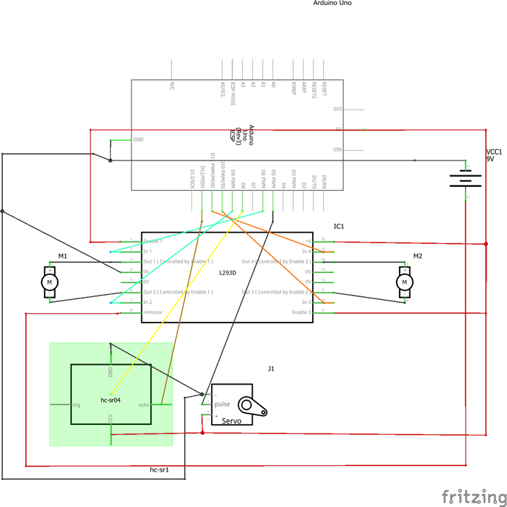

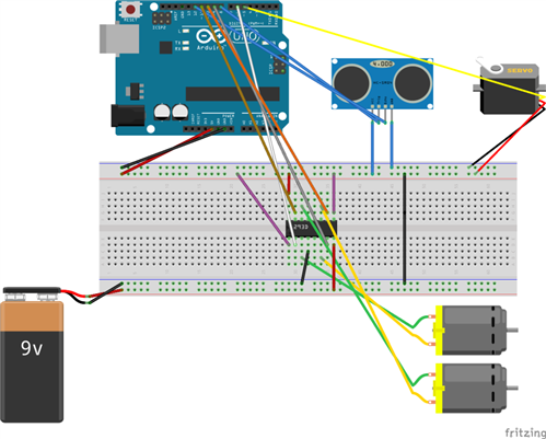

Wiring:
I set the enable1 and enable2 pins of L293D HIGH by wiring them to Arduino 5V, this made the motors run at full speed. The batteries powered the motors while the Arduino managed the control process and the ultrasonic sensor.
The ultrasonic sensor mounted on the servo moved around to find checkLeft and checkRight. Whenever the distance in front is less than 15cm, the bot will check both directions and turn wherever there is more space. Also, if checkLeft and checkRight both are less than 10cm, then the bot goes reverse and turns left to find another route. This can be changed according to your own requirements.
The ultrasonic sensor transmits a sound wave and calculates the time it takes for the signal to come back after getting reflected from an object. Therefore, we divided the time calculated from the sensor by 2 to calculate the distance.
We used this formula to convert duration to centimeters.
cm = (duration / 2) * 0.034;
Speed of sound = 340m/s =  0.034cm/μs
Distance = time*speed
Distance = (duration/2)*0.034 cm
The turnDelay was set to 1100 to ensure the bot made a complete 90 degree turn when calling left() and right() functions. This may be changed depending on different setup changes.
