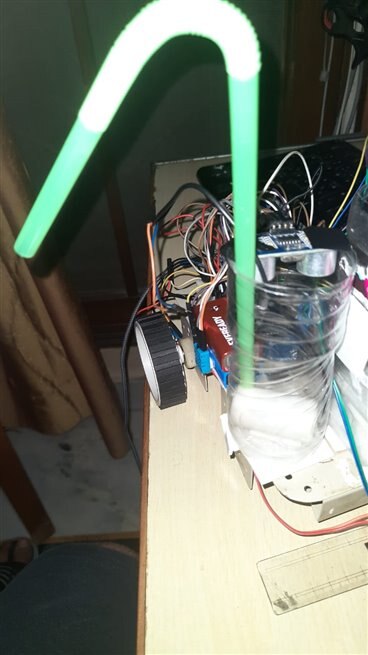

In this blog, we will create the setup for the pest control system.
As we did in the last blog, we will similarly make the same system for pest control.

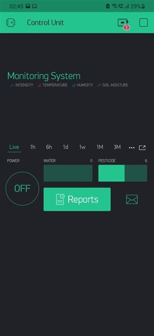

We will use an ultrasonic sensor to measure the pesticide level in the container. Once the pesticide level falls below a certain threshold, we will send an email using the Blynk App. Also we will send level of our pesticide container to the Blynk App continuously so it can be looked at any time. For the pest control system, we will add a button to send signal to Arduino Nano 33 IOT to spray the pesticide using Blynk App. PIN V2 was used for this purpose. The pump would turn on and spray the pesticide. For this, an L293D module was used as before.
Whenever the distance from the Ultrasonic sensor was less than 4, we sent an email warning to refill the pesticide tank.
//sending email when pesticide level falls below 4
  if (cm < 4)
    Blynk.email("Pesticide level alert", "Fill pesticide in the container");
  return cm;
For spraying pesticide based on user input, I used the below snippet of code
  //for spraying pesticide when user calls it
  int value;
  BLYNK_WRITE(V2)
    value = param.asInt();
  if (value == 1)
    digitalWrite(motorB1, HIGH);
    digitalWrite(motorB2, LOW);
    delay(30);
    digitalWrite(motorB1, LOW);

Pictures:
