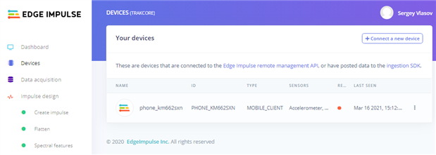

Edge Impulse provides a very convenient tool for data collection on a phone. It is very easy to load and use. It doesn't require any app installation or credentials. I've just scanned a provided QR code. Once a mobile phone load a web page related to QR code it as well loads WebAssembly. After that I've granted permission to access accelerometer it was ready to collect data.

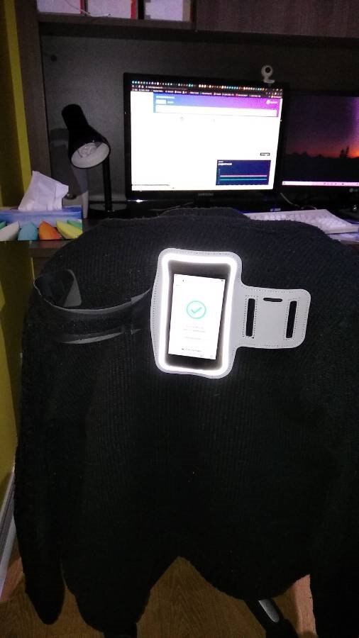

I've attached the phone to my back on a cardigan using a running armband.
But I've got some minor challenges too. My phone was going into lock mode after capturing several 10-seconds samples. Sometimes the size of the sample was 0 seconds. So I've deleted them. Sometimes the WebAssembly was not able to upload data.

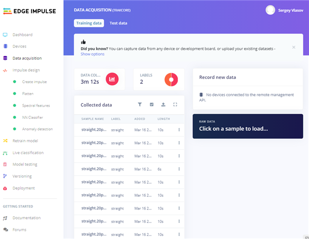

Data collection for Curved vs. Straight position

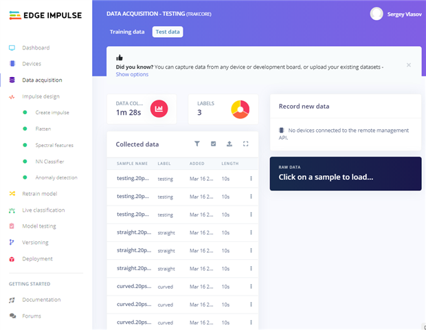

I've collected a training data set for position. This data set is used to build a model. Each data sample must be labeled with a straight or curved position label.
Then I've collected a test data set. This data set is used to validate the model. The size of my test is 30% of the training data set.

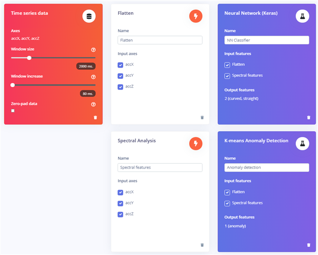

I've selected two components for my model. Flatten to classify and Spectral Analysis for anomaly detection. I've added anomaly detection based on recent recommendation by an engineer Jenny Plunkett from Edge Impulse during recent webcast Industrial-Grade TinyML Applications with Silicon Labs and Edge Impulse! (Win a Thunderboard Sense 2!). I may revisit my choice later.

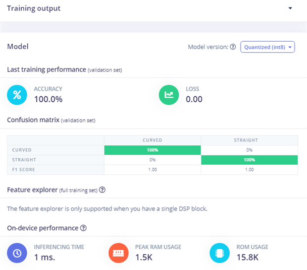

Than I trained model. The accuracy on the training set was 100%. And the size of the model (1.5k peak RAM usage, 15.8kb ROM usage) should easily fir into MCU, which has 256kb of flash and 32kb of SRAM. But I'll still need to account for the network stack.

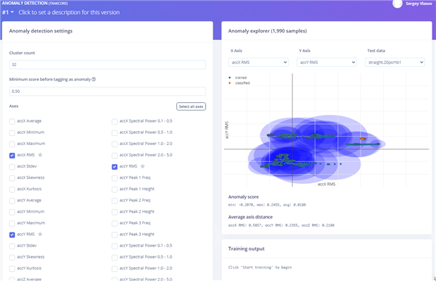

I've decided to add anomaly detection block to account for unclassified cases. After some exploration I've adjusted minimum score before tagging as anomaly to 0.50. And I still need to learn more about it.

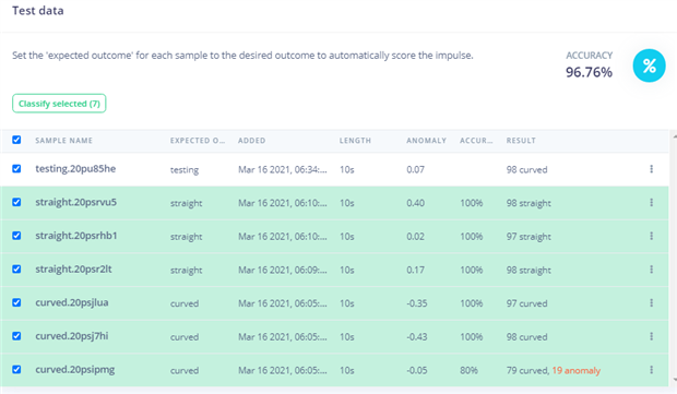

Than I've run the most important test to validate my model on the test dataset. The accuracy as expected went a bit down from 100% to 96.76%.

    Thank you for the question. I've attached it to my back on a cardigan using a running armband. I've updated the post with the picture.

    So do you have the phone in your pocket to gather the data?
