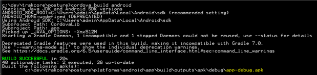

Than I've build the code:
cordova build android
And it created Android apk binary file.

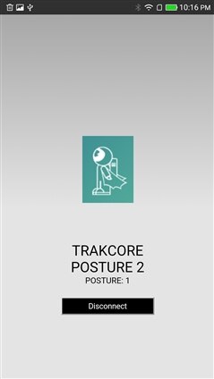

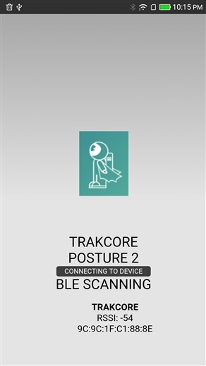

My application got loaded to the phone and automatically got started.

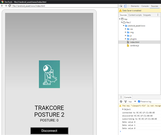

After the app started it scans BLE devices and connects to my Posture Service on Arduino Nano 33 IoT and subscribes to this service for notifications. It transforms received data from the service and displays "POSTURE: 0" if posture is curved and "POSTURE: 1" if the posture is straight,
{gallery} Posture App
I've used Google Chrome built-in debugger during development: It saved a lot of my time and effort.

    Yes,  the following command will generate APK. I've just updated the blog with this detail.
    1. cordova build android
