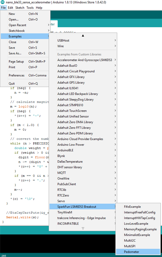

And to get access to this low level function I've switched to another Arduino library and start using SparkFunLSM6DS3 library. The library comes with a pedometer example https://github.com/sparkfun/SparkFun_LSM6DS3_Arduino_Library/tree/master/examples/Pedometer. It made my work a bit simpler.

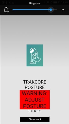

Than I've added additional code in my Android app to read and process this new characteristic. And I added vibration (line 14) , so you can feel when your posture need correction.

        else if (pedometerSteps == oldPedometerSteps) { // no movement - most likely sitting
            resultDiv.innerHTML = "WARNING: Adjust Posture";
            resultDiv.style.backgroundColor = "red";
            // Vibrate for 1s, wait 1s, vibrate for 2s, wait 1s, vibrate for 3s
            navigator.vibrate([1000, 1000, 2000, 1000, 3000]);

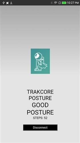

Result
False positives of curved posture has been eliminated and I've added additional field on the app dashboard to show steps:
.imageimage

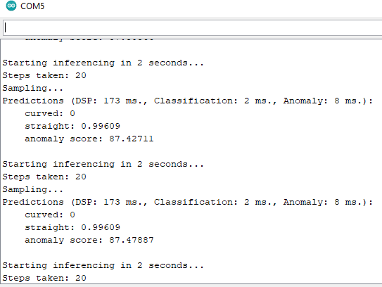

  • After I switch LSM6DS3 IMU library my anomaly score for the posture went up significantly. So I temporary removed it from my rules. I need to identify why it went up.
