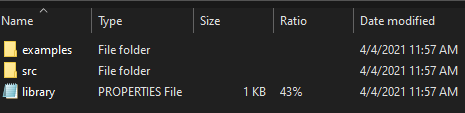

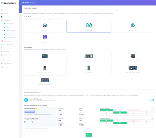

Building Edge Impulse Library
After I’ve built the model to classify posture in my previous blog post Trakcore #2 AI Assisted Posture Modification - Acquiring Data and Designing a Model the next step was to build  an Arduino library. It is very simple process on Edge Impulse. I've selected default options to enable Edge Impulse EONTm compiler (same accuracy, up to 55% less memory and 35% less flash use according to the vendor) and TensorFlow Lite Quantized (int8), 8-bit quantization approximates floating point values, which is the optimization recommended for best performance.

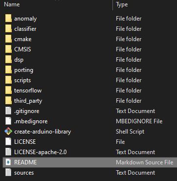

This build process generated a compressed zip file ei-trakcore-arduino-1.0.1.zip (3.54MB). This library can run on any Arm-based Arduino enough RAM, including Arduino Nano 33 IoT.
It includes Edge Impulse DSP and Inferencing SDK, source code for the library, Arduino examples and other metadata.

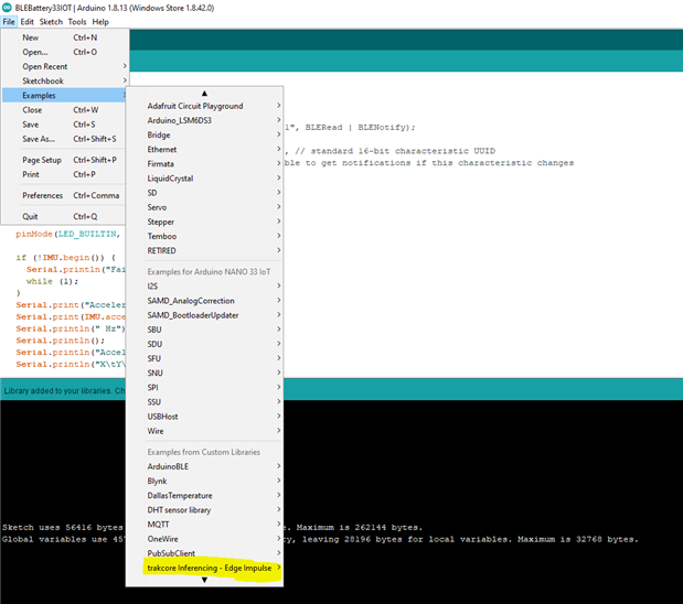

Adding Edge Impulse Library to Arduino IDE and adding sketch example
Than I've added the library to Arduino IDE. Once library was added I was able to use provided example on integrating the model under Files > Examples > Your project – Edge Impulse > static_buffer

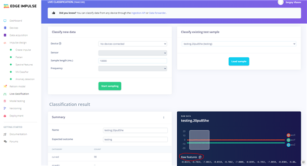

Getting sample
Adding raw feature data to sketch
I've extracted raw data sample from Edge Impulse Studio -> Live Classification -> Raw Data -> Raw Features and added them to my Arduino sketch.

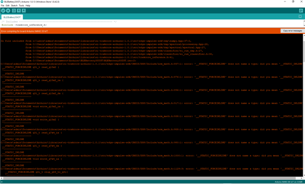

Compiling
It took a lot of time for me to sort out compiling for Arduino Nano 33 IoT as it was failed initially.
So I've looked at Edge Impulse forum.
There are several posts about compilation/build issues:
https://forum.edgeimpulse.com/t/filename-or-extension-too-long-arduino-nano-33-iot/843
But than I found a good document that helped me to resolve all these issues https://docs.edgeimpulse.com/docs/running-your-impulse-arduino#code-compiling-fails-under-windows-os

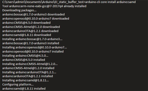

One of steps that helped me resolve compilation problems was to download and use of Arduino CLI Windows 32 Nightly Build instead of Arduino IDE for compilation/build/deployment.
There was additional step to add SAMD platform ( The AtmelRegistered  SMARTTm SAM D21 is a series of low-power microcontrollers using the 32-bit ARMRegistered CortexRegistered-M0+ processor):

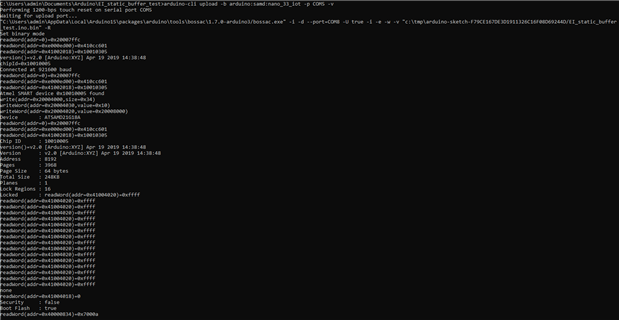

And then I run build
Build failed again. It was complaining on permissions. I've than I run the same command as admin and it was completed without any errors.
Deployment
Deployment process was quite smooth and simple.

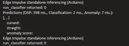

Testing

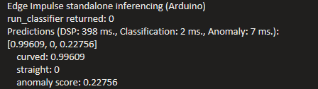

I've connected Arduino IDE serial monitor to MCU and start getting empty output instead of float values.
I was not the first who got this issue and found workaround on Edge Impulse forum https://forum.edgeimpulse.com/t/arduino-33-iot-no-inference/950

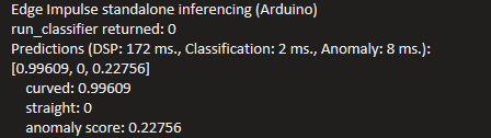

After I followed instruction on the forum it was working as expected. But inference was quite slow and taking 398 ms in DSP.
Again using the same forum post instruction, I've updated my code and it start working twice faster:
