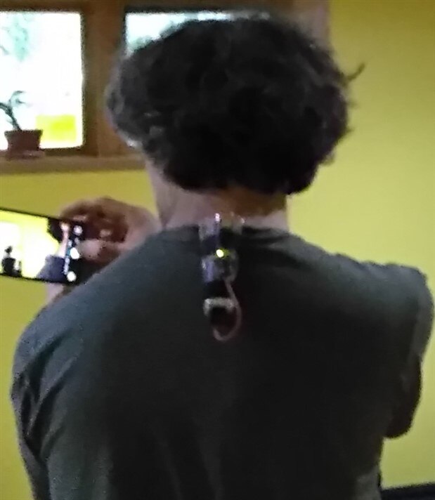

I've described in my previous blog Trakcore #5 AI Assisted Posture Modification - Using Cordova Bluetooth (BLE) Plugin to Connect Arduino Nano 33 IoT with Android Phone steps to build an Android app, which can communicate with MCU. Now I need to validate the app and embedded code in a real-life working conditions.
Requirements
It will be great if Arduino Nano IoT 33 had a wearable accessory available. I was not able to find any. So I came up with my wearable design requirements for Arduino Nano 33 IoT, which should support the following.
  • I can clip it to my back
  • I can walk with it
  • The device should support at least a working day without recharge
  • I can easily recharge it without disassembly
  • I can easily reprogram it without disassembly
  • LEDs on the board must be visible, so I can check its state

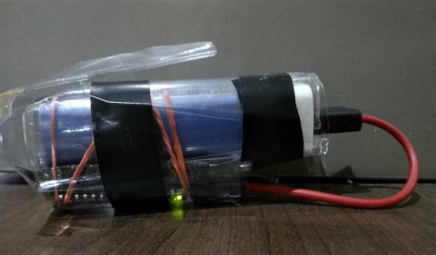

Materials
I've decided to limit myself to materials which I already have to eliminate risks of delays due to supply chain constraints.
I've used the following materials and tools:
  • USB Power bank
  • USB cable
  • Plastic from a packaging
  • Foam (came with MCU)
  • Tape
  • Scissors
Result
It took me around 15 minutes t cut and connect all pieces.
Here is the result

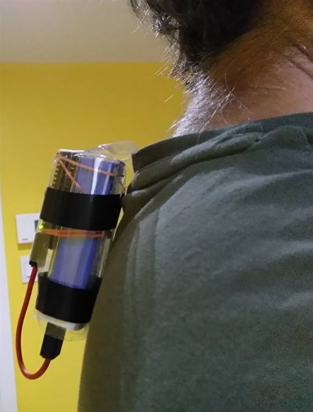

Findings and Future Improvements
Here is my findings after several hours of usage:
  • Easy to use
  • Not reducing my range of movements
  • Bulky
  • Nerdy look
Future Improvements
  • Smaller battery
  • Magnetic clip
  • 3D print
  • Smaller board
