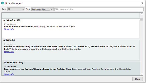

MCU needs to provide posture position inference. I've decided to use BLE due to low power consumption. Arduino provides a ready to use BLE library, which supports  Arduino Nano 33 IoT radio.

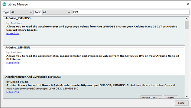

My project requires to calculate position of the device from built-in accelerometer. Arduino provides a ready to use library for LSM6D53.
Both libraries come with easy to use examples.

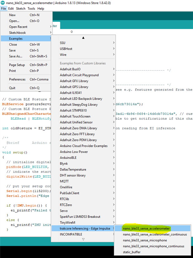

Edge Impulse support Arduino Nano 33 BLE and provides examples of using it with BLE and IMU. So I've decided to use this example to accelerate development instead of improving my previous Arduino sketch. I've imported Edge Impulse Arduino Nano 33 BLE accelerometer example.
I've modified code to include LSM6D53 header instead one that comes with the example. As well I've applied the same modifications to the code as I've dome in my previous sketch.

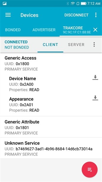

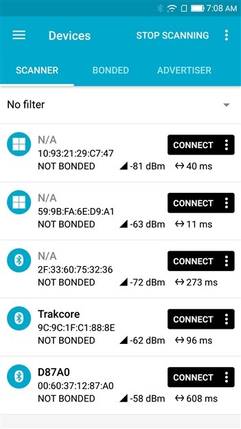

I've installed nRF Connect for mobile from Nordic on my phone. I've started it and was able to see my device as Trakcore on the scanner screen.
I've select my device and on the client screen I've expanded my custom service.

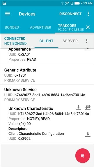

Now I was able to select my custom characteristic of the posture service.
And I was able to read the posture state as a value (0-curved, 1-straight) of my characteristic:
