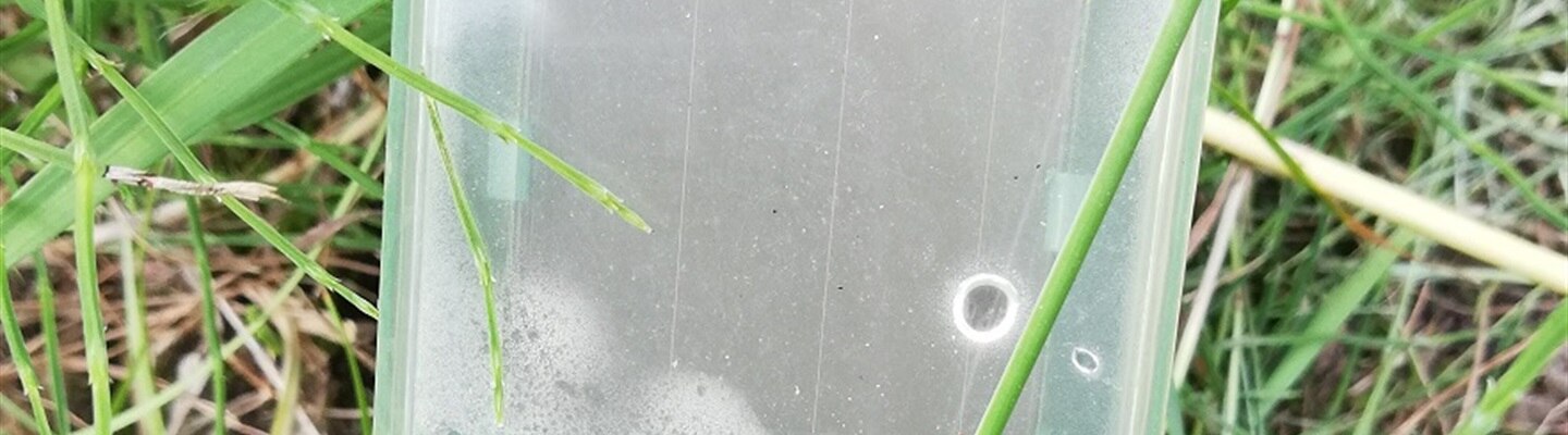

Color influence on solar radiation heating of the enclosure
UV radiation can be damaging to unprotected plastics - prolonged exposure can lead to discoloration and cracking - which will ruin not only aesthetic aspect of the installation but waterproof properties too.
UV damage to the plastic box
One of the most often employed methods of improving UV resilience is an addition of soot - which, as as side effect, changes plastic color to black (so common wisdom says that black cables are for outdoor installations and grey are for indoors). But - as dark colors absorb more solar radiation than the light ones, another test was performed. Four enclosures:
  • light gray
  • black
  • dark red with the transparent lid
  • light grey with the transparent lid
were placed under the direct Sun radiation and the temperature inside was measured.
Maximum temperatures were as follows:
  • light gray: 51.4°C
  • black: 67.6°C
  • dark red with the transparent lid: 78.3°C
  • light grey with the transparent lid: 78.3°C
The conclusion of the results can be that for temperature-sensitive components, enclosure should be light gray (or even white if possible) and without transparent window - fortunately, Hammond manufactures enclosures of light gray color which are UV hardened.
