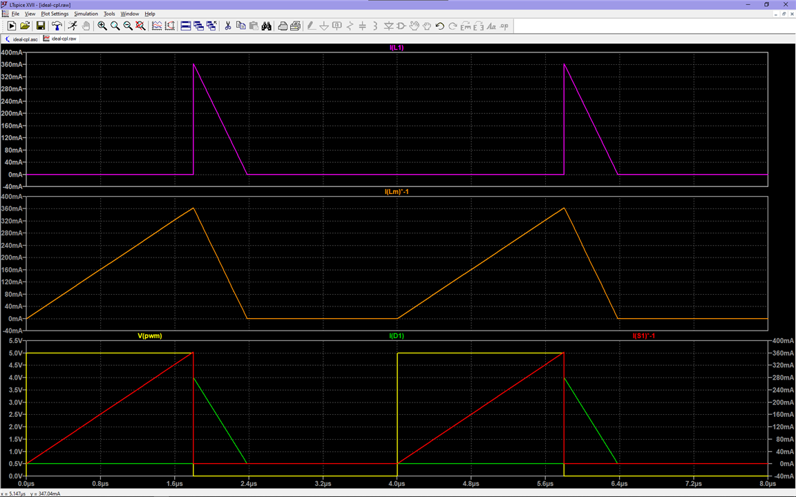

What has been a theme in my electronics journey also became part of the challenge: the simulations. I think that even if they are not as hands on as the physical objects all the components we work with are, they are an amazing tool, useful to teach, to learn, and at least also to get an idea if your circuit will work, or how it is likely to work. Simulations, simulations, simulations!
This was a taste of what was to come, both to real life and to future simulations. Here we saw how the currents in a flyback converter might look like, and was the start of becoming familiar with the topology:

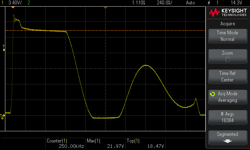

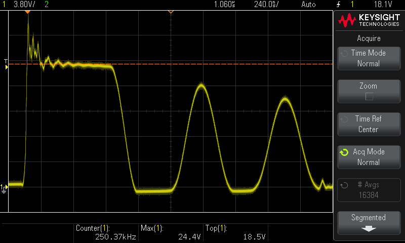

But the equations didn't tell us anything about this bad boy squiggle over here:
So this was the opportunity to research about this phenomenon and begin working on the next blog.

I thought I was going to end with just the practical example, but I couldn't resist running one more simulation, just to check everything was right and this improvement wasn't the result of an unexpected anomaly:
This revealed that while what was covered in the blog did indeed add up, there was still something unaccounted for:

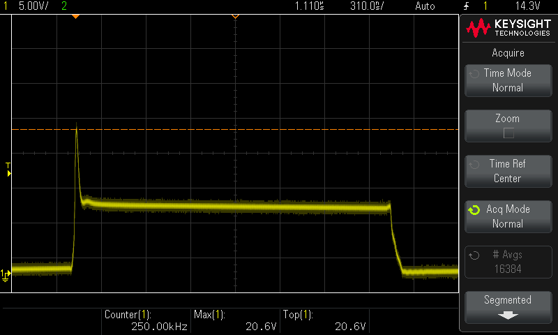

So this clamp subcircuit came into the picture:
And it also came to reality!
Doing a good job!
Its partnership with snubber was flourishing!

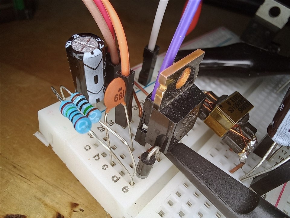

Here's the circuit on a breadboard, well, two, because of the staggered pins:

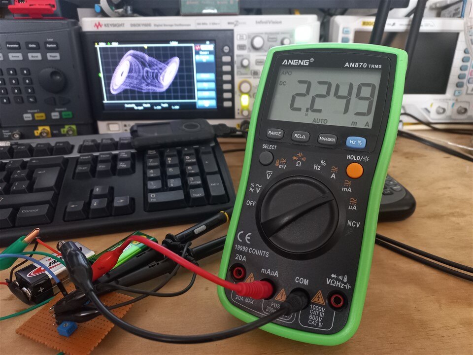

Next I went to rebuild the Chua circuit on a breadboard. I built everything on breadboards thinking this would help me figure out a reasonable layout to then move onto a PCB, but I was unable to do that in time, so the final result will also be presented on the breadboard:
And a demonstration of it working with the +/- 9V supplied by two 9V batteries in series:
Great! now it's time to put it all together:
I intentionally connected each section to the next with big copper arches to have an easier time probing around.

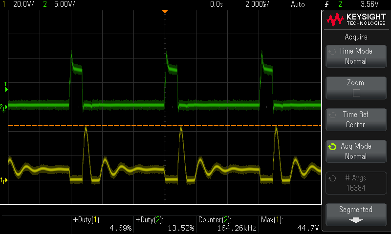

I now wanted to take a look at the supply by itself:
This is Vds in yellow, and Vgs in green, at the working dury cycle, but with no load.
With no load the output voltage between the positive and negative rails is wild!
Now with the Lo-Z load:
Vgs looks a lot more like what we've come to expect from a DCM flyback converter.
I don't understand why the difference is so big. But seeing that unloaded voltage at the lowest setting made me want to experiment further, so i set the duty cycle to the max:
It reached almost 100V at the output! And the waveforms went crazy, but I couldn't capture that in time. Soon after, the MOSFET died:
And that was all that remained.
I found it really surprising that I was able to get almost 100V out of this converter, even if it lasted only a few seconds. But this just goes to show why flybacks are used by so many mad scientist aspirants on youtube. You can get them to work with very few components, and you can get them to do wild things that you might not even expect. I partially achieved my goal of integrating my chaotic attractor with a power supply and feel satisfied with what i learned while doing that.
