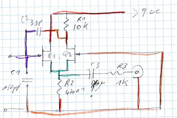

w2aew has made a video (included later in this post) on this little design. The original comes from n4tmi, published in 73 magazine, September 1990). I'm trying it out, only using things I have at home.
The Bourns inductors #2, #7 and #15 of this kit will be used, and the custom one I made in post #8.
Short story: this is an oscillator.
The inductor under test in parallel with a known capacitor will have a resonance frequency.
This circuit will oscillate at that frequency. You measure that frequency at the output, then use a formula to derive the inductance of your unknown inductor.
Schematic, Layout and BOM
image source: drawing based on n4tmi's article in 73 magazine
Strongly simplified explanation. Check w2aew's video and n4tmi's article for details.
The Inductor Under Test and C1 (150 pF) form a resonant tank circuit.
C2 provides positive feedback to keep the oscillator swinging.
R2 puts Q2 in the saturation region. Like w2aew, I used 1K instead of the 470R in the original design.
The output can be checked with a frequency counter or an oscilloscope.

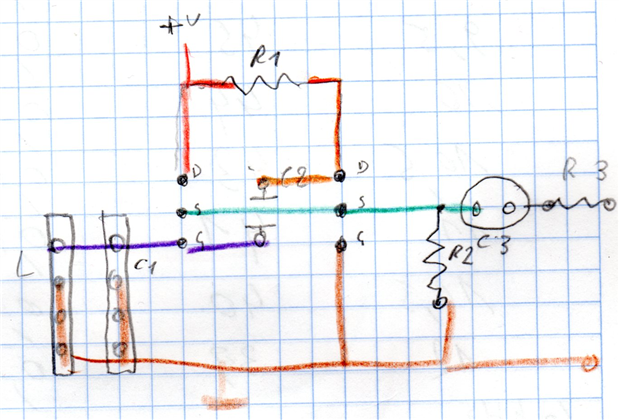

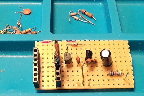

image: layout prepared on a piece of paper

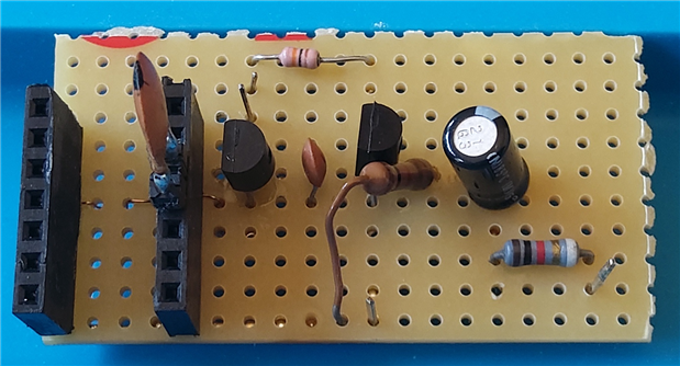

I used perf board (part of a shopping cart I won with Project14). I placed components on a piece of paper first.
image: the circuit built up on a piece of perfboard
You can see that the final layout on the perfboard is a translation of that. I placed C3 the wrong way, may fix that later.
In the left slot you can place the inductor. The upper 3 pins are input, the lower 4 ground. In the right slot you can put the reference cap (C1).
These slots are interchangeable because both sides' inputs and grounds are connecting to the same circuit node.
If you want to measure the frequency of an unknown resonant circuit, remove C1.

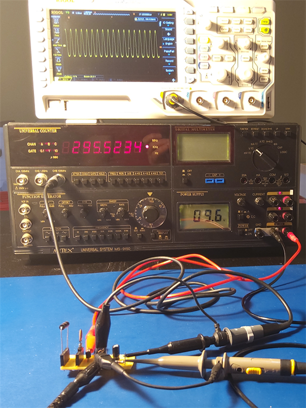

The circuit starts to oscillate when VIN is just over 9 V. I got the best results when the voltage was above 12 V. You can use it with two 9 V batteries in series.
I've tested it with 3 inductors from the Bourns kit, and with one I made myself.
image: device in action, measuring frequency with a counter and an oscilloscope
I got reliable frequency measurements with an oscilloscope, a traditional frequency counter and with the EEVblog 121GW DMM.
The load at the output has little effect on the oscillator circuit, because the input impedance isn't affected by what you connect to the combined JJFET sources.

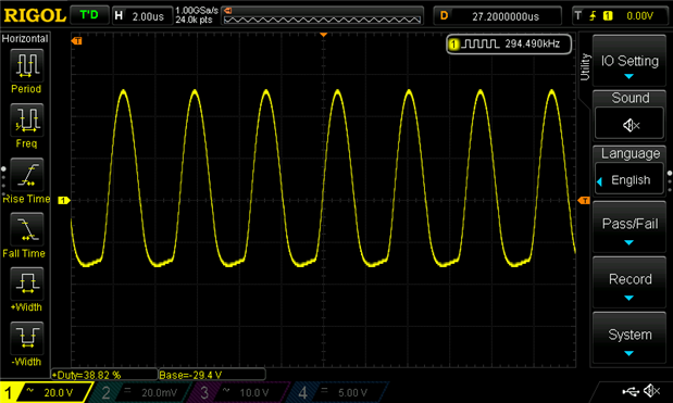

Test 2: Inductor #7, RF Choke, 1.8 mHRF Choke, 1.8 mH.
image: Bourns datasheet
Frequency: 294.490 kHz
Result:
1.9 mH
Check with LCR meter at 100 kHz: 1.7349 mH.

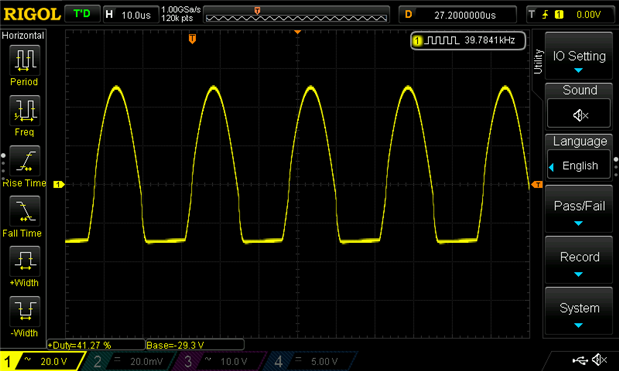

Test 3: Inductor #15, Choke, 100mHChoke, 100mH.
Frequency: 39.8 kHz
Result:
106 mH
Check with LCR meter at 120 Hz: 103.82 mH

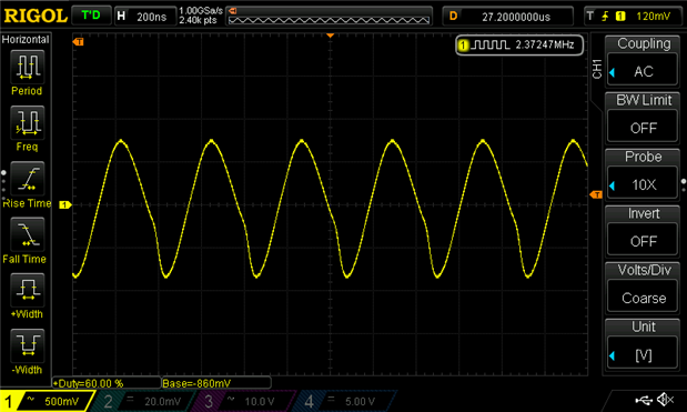

Test 4: Own made, toroid 60 µH.
image: mine
Frequency: 2.4 MHz
Result: (the oscillator wasn't stable like with the Bourns devices)
30 μH (see Jon's comment below)
Check with LCR meter at 10 kHz: 60 µH

    The core you've chosen is intended for EMC use, so it's designed to be lossy from a few tens of megahertz upwards.
    This is the consequence for the permeability
    it's already starting to decline around 1MHz, and by 2.5 MHz it's down from the LF value of 850 to about 750, so I think that's why you see the inductance value changing. I imagine the core will also be beginning to absorb rf, which might be why you have the oscillator problem (if you've set the loop gain low for a good waveshape, the additional absorbtion will be dragging it down to the point where the oscillator would be struggling). Could be more to it than that, but it's a starting point for thinking about what is going on.
    Jan Cumps over 4 years ago in reply to jc2048
    Thank you. Yes, these cores are intended to be put around wires and filter, not as proper toroid kernels.
    That would explain it - my LCR has a max test frequency of 100 kHz.
