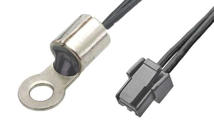

The Mounting Challenge
Measuring temperature is an important thing to do, but have you noticed that ordinary thermocouples and thermistors usually come in bead form? These rounded ends may be cheap and easily manufactured, but they pose a challenge when trying to mount on a flat surface. Simply clamping a round thing to a flat surface results in a concentration of stress which can damage the device, or the potential for the device to slide out of position. Usually, the best way to use beads in a permanently mounted configuration is to use thermal epoxy which “glues” the bead in place, but this makes it hard to replace. It can also crack and work loose over time, as I’ve experienced some very chalky thermal adhesive which has failed me in the past.
One option is to opt for thermistors in the “chip” form, however, often this needs some level of protection from the elements to maintain accuracy, similar to how bare Pt100 elements may be provided as bare chips. The chips still have to be mounted to a substrate, and if that’s by thermal epoxy, the same disadvantages apply.
Perhaps the sensible option is to package the thermistor as an electronic component so it can be handled and mounted in much the same way. This has definitely occurred – Littelfuse has made a TO-220 thermistor, for example, but there is only one standard value. This makes it easy to mount against heatsinks, but it also occupies quite a bit of space on the board and on the heatsink. I’ve seen such devices used in precision power supplies for temperature compensation, but it seems to be a relatively uncommon approach.
A more common and often seen approach is to use a “flag” type mounting such as the USP5510 series from Littelfuse (image from Littelfuse). I’ve seen these used inside lower-end power supplies for monitoring heatsink temperature, with the right-angle design allowing the thermistor to be mounted off the end of the heatsink. This design certainly works – but it’s likely not to be as thermally accurate depending on how it is mounted.
A close relative is the “ring” type which Molex have provided (image from Molex). This type doesn’t have the right-angle approach, which can make them a more compact solution in some instances and shares the need for careful mounting for the best thermal accuracy. Both solutions make mounting easy, by having a flat mounting surface which can be attached by simply screwing or bolting it down. No need to think about the rounded surfaces, no need for thermal epoxy, no need for waiting for it to set and no need to worry about difficult replacement.
