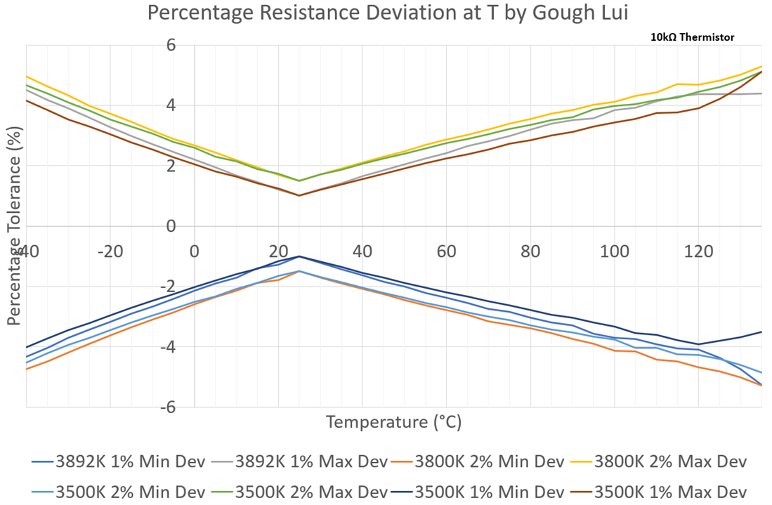

What Does 1% or 2% Tolerance Actually Mean?
When a thermistor is specified with a 1% resistance tolerance, this means that the nominal resistance (usually resistance at 25°C) can vary by ±1%. As a result, a 10kΩ thermistor could measure between 9900Ω to 10100Ω. But does that apply outside of the nominal temperature?
By entering all the drawing data values from 10kΩ thermistors in this design challenge manually into a spreadsheet and plotting the values, it is possible to answer this with an emphatic no. In fact, the resistance tolerance actually increases the further away from the nominal temperature we go. The 2% thermistors are actually 1.5% by the data, but the tolerance increases up to about 5% at the extremes.
Understandably, such a change is not minor – but just because the resistance changes by 5% doesn’t mean the temperature measurement changes by 5% - this depends on the interaction of the change in resistance with the approximation that is used.

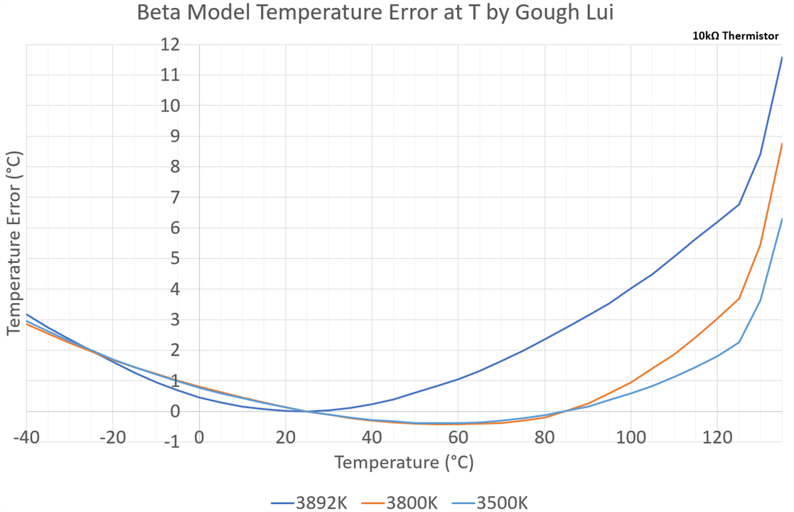

Is the Beta Model Good Enough?
Knowing all of this, the Beta value is still one commonly provided by thermistor manufacturers and perhaps is still very widely used. Looking more closely at the Molex datasheets, the Beta value is provided along with the temperature range, but this is not the same for all products. The ring thermistors give Beta for 25°C-85°C while the bead thermistors give Beta for 0°C-50°C. As a result, the Beta values cannot be directly compared, and the accuracy of the approximation would be better at a different range of temperature values. This had me wondering - how accurate is it across the range using just a single Beta value?
In this case, I plotted the error in estimated temperature based on the single Beta value approximation. The error takes a shape of a paraboloid as it is a second order approximation, the extremes at the high-end of the temperature scale range about 6-12°C which is pretty significant.
The region where the error remains below 1°C range from -10°C to 60°C for the bead thermistor and -5°C to 100-105°C for the ring thermistors. Where the temperature range and level of error is acceptable, it seems that using the Beta value is a reasonable approach which is computationally simple to implement.
However, one has to consider the impact of the thermistor tolerance as well. If the model has an error of 1°C, this is an independent source of error to the error that is introduced by the manufacturing variation of thermistors. Using the Beta model and the listed tolerance boundaries, it seems the thermistor manufacturing variances contribute up to 2.5°C error at the upper extreme. Error contributions of 1°C or less are achieved for temperatures of -40°C to 70-80°C depending on the particular thermistor.
As a result, adding errors in quadrature, I would expect errors to be within 1°C using the Beta model on all three thermistors from around 8°C to 50°C, and within 1.414°C in the -5°C to 60°C range. In practice, it’s likely to be better as the error from the tolerance may not be entirely additive to the error of the approximation.
