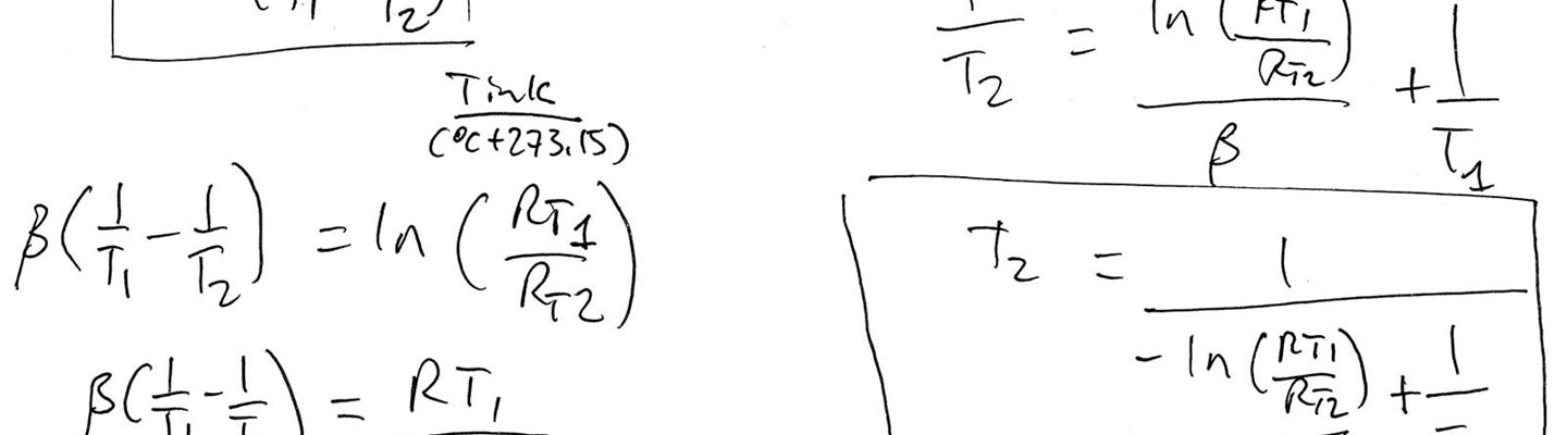

A simplified form of the Steinhart-Hart equation is used which considers the resistance of the material at two points. The Beta value is computed between those two points and is defined by the equation β = ln (RT1/RT2) / (1/T1-1/T2) where all temperatures are given in Kelvin (i.e. temperature in degrees Celsius + 273.15).
Datasheets will often provide the Beta value (in K), alongside the nominal resistance at 25°C. Rearranging the equation allows us to solve for the resistance at a given temperature, or the temperature given a resistance. In a very seldom-used application of high-school math, I decided to do the rearrangement by hand (without simplification) …

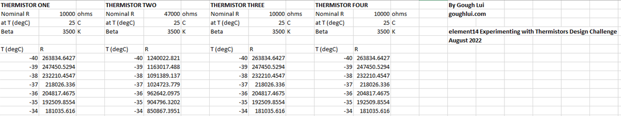

I created two spreadsheets - one to do the basic calculations in more "human-friendly" units, and another to compute the expected resistances at each temperature step for graphing purposes.
For the Molex beads, we can see just how much the resistance varies as a function of temperature. The curve is highly non-linear, dropping rapidly for temperatures below the reference 25°C and slower at temperatures above. This means the resistance of the thermistor can range from tens of kilo-ohms down to just a few hundred ohms across the operating temperature range.
This is more clearly seen on a semi-log plot – I have extended the axes past the operating temperature limit of 135°C just to show how it “flattens out” as the temperature increases. This does suggest that perhaps the nominal resistance value chosen can be a trade-off between the ease of measurement and precision, and the temperature range which is expected to be measured.

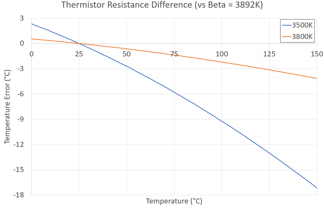

We do have a few other Beta values, so let’s see what the difference is between three different Beta values of 10kΩ nominal thermistors. In the linear plot, the difference is relatively small in resistance, with all curves passing through the same point at 25°C as expected.
Taking 3892K as the reference value, the difference in resistance between 3800K and 3500K is plotted. As expected, the resistance difference between 3800K and 3892K is relatively small above 25°C, as compared to 3500K. The differences below 25°C are much greater, due to the steep increase in resistance as temperature decreases.
But perhaps the more important point to consider is the impact on the derived temperature accuracy using the Beta model. In this case, over 0-150°C, the 3800K thermistor when calculated using a 3892K expected Beta gives an error of +0.5°C to -4.1°C which seems fairly reasonable. The 3500K thermistor has an error of +2.3°C to -17.1°C which is more severe. As a result, we can see just how a Beta value mismatch would introduce a temperature measurement error.
