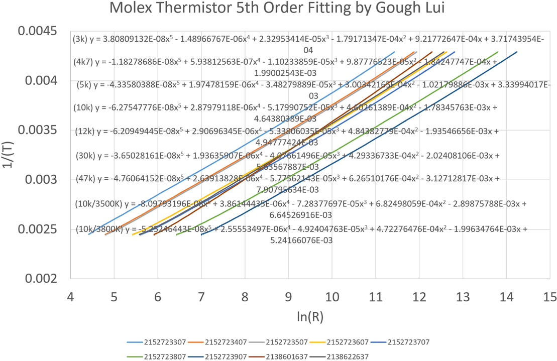

Fitting All the Thermistors to a 5th Order!
In order to convert measured resistance to a temperature, we need to use a model of the thermistor. Knowing that literally everything from ADC errors, reference voltage errors, thermistor tolerances and divider resistor drifts can affect the accuracy of the result, I wanted to minimise the model error contribution and as such, I have settled on the use of the fifth-order model with the Molex-provided rounded resistance values as the best way forward.
To do this required hand-keying all the resistance values from the drawing documents and then using a 5th-order fit to each of the curves where y = 1/T (in Kelvin) and x = ln(R). The resulting coefficients are tabulated below and the worksheet with the raw values is available for download at the end of this blog posting.

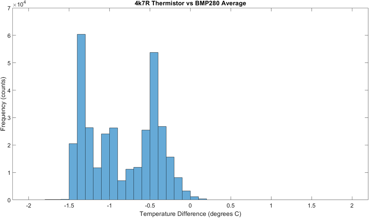

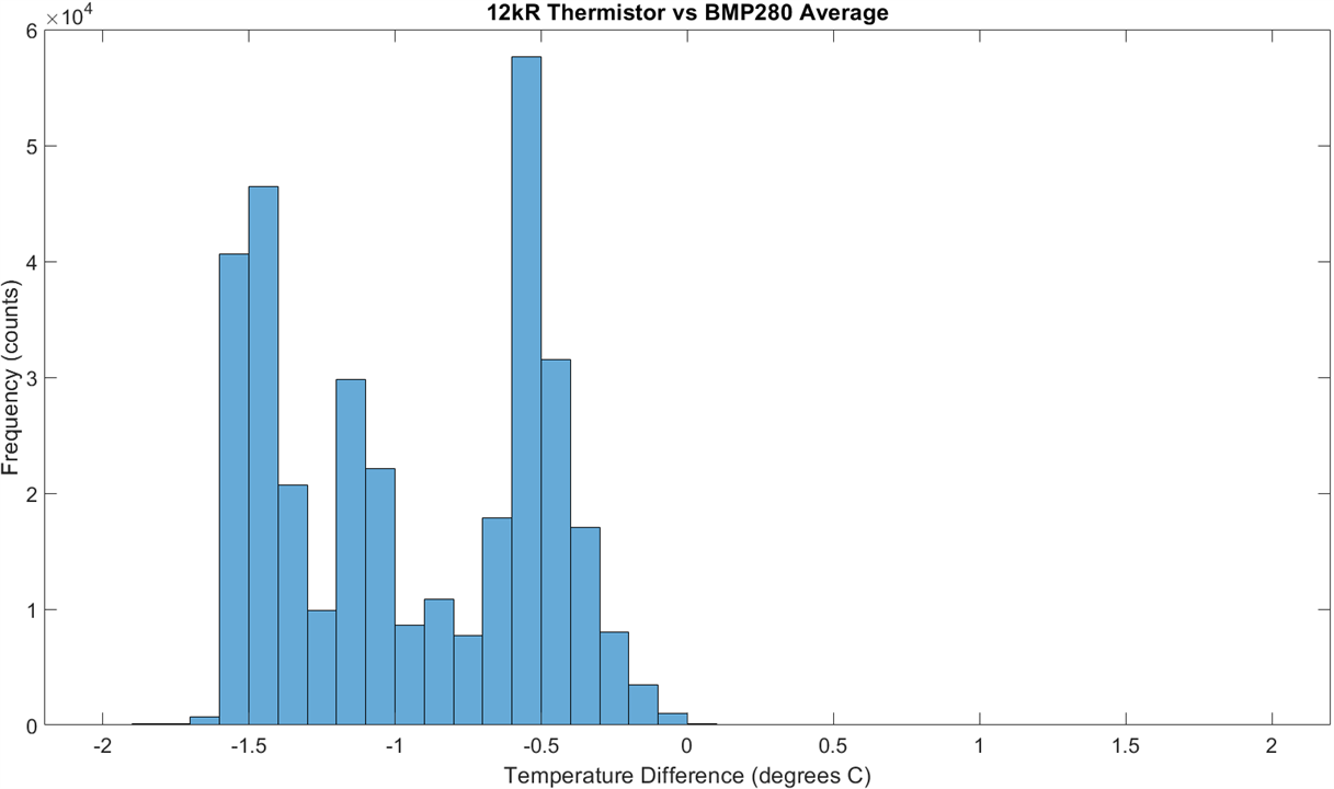

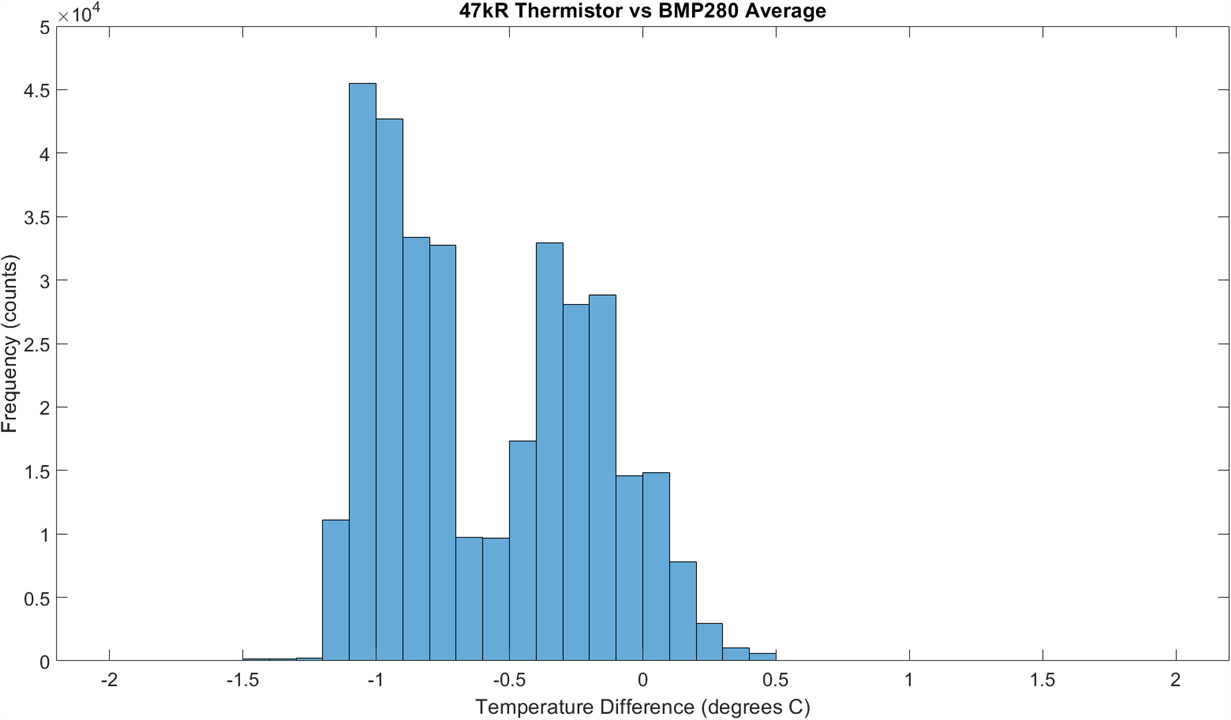

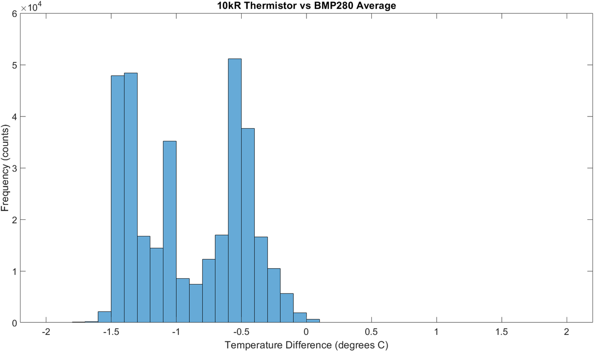

After several days of operation, I decided I had collected enough data to call an end to the multi-thermistor experiment. In total, 334,323 samples were recorded and I analysed them using a mixture of Excel and MATLAB. Instead of using the nominal resistances for the divider resistors, I used the multimeter-measured values as posted in the previous blog.
Looking at the temperature logged by a single BMP280, the temperature varied between 14-23°C or so through the testing period.
However, agreement between the two BMP280 sensors was not as close as expected. Even though they may be ±1°C by datasheet, the resulting average temperature difference is about 0.9°C. This may be because one of the sensors was closer to the MKR WiFi 1010 and receiving some radiated heat from it.
Rather than take any one BMP280 reading as accurate, I decided to average both and use that as the reference value.

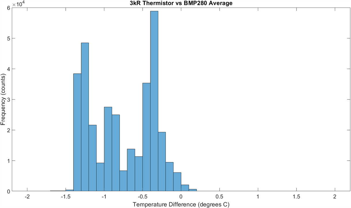

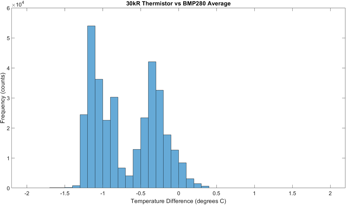

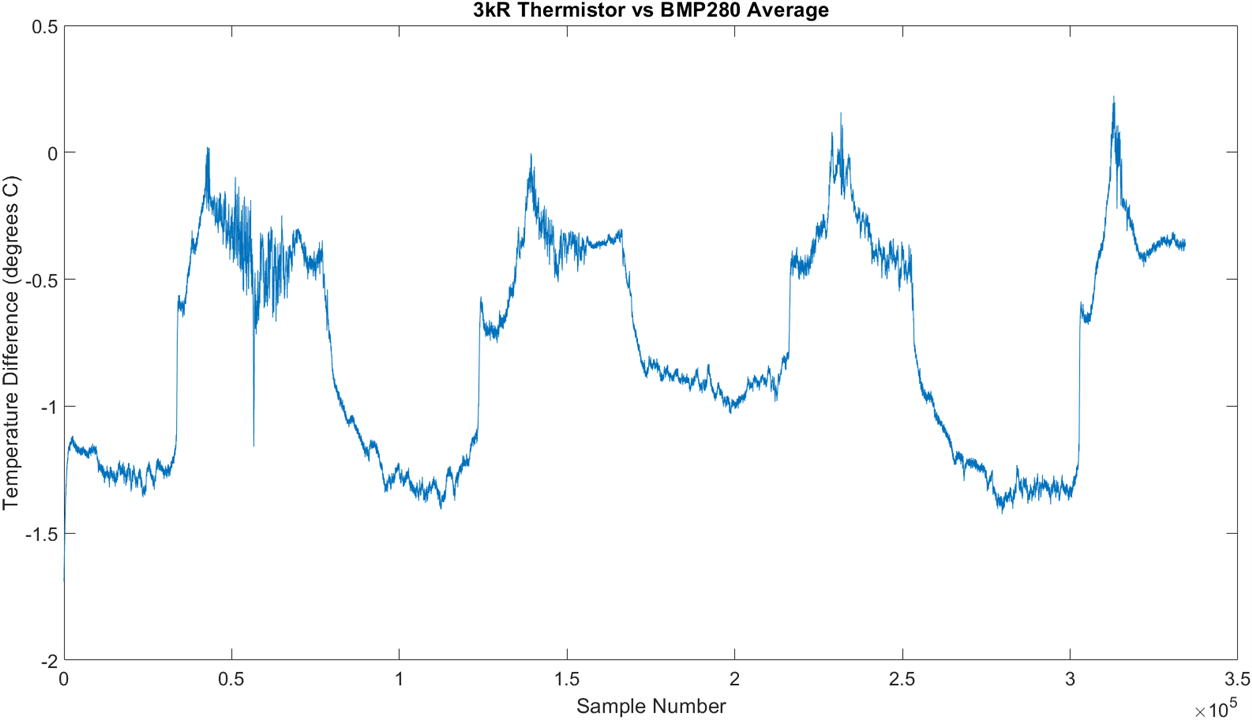

Looking first at the 3kΩ thermistor, we can see an error that has a diurnal pattern – it trends closer to zero during the daytime, with an negative error during night-time. This suggests to me that comparing the BMP280 values with the thermistor values is probably a bad idea because the BMP280 may also have a second source of error – perhaps an internal self-heating.

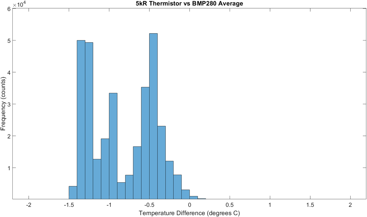

The difference histogram seems to have a double-peak (with a smaller peak in-between), which is probably caused by the durnal temperature error difference, even though most of the difference is confined to 1.5°C.
image image image image image image
Graphs for all other thermistors show a similar trend, with a similar amount of error, suggesting to me that this may well be an issue with the BMP280 itself as well.
The amalgamated plot above shows just how similar the results are, with a slight offset because of individual thermistor tolerances/errors. I’ve previously noticed that such digital temperature sensors will overestimate temperature especially at lower temperatures, so perhaps this is not unexpected to me.
Instead, it seems better to compare thermistors with each other, so I took the 3kΩ reading as the reference and compared the others to it.
This gave a much better-looking plot. Lower-value thermistors appear to provide more “tightly bunched” results, perhaps due to input impedance issues resulting in lower noise readings. Such lower-valued thermistors were able to provide results within about 0.25°C. Higher valued thermistors seem to produce broader spreads of errors, but all variances remained within 0.5°C. Some error will always happen because of the curve-fitting process, but this suggests to me that the thermistors are quite accurate comparing unit-to-unit of different resistances given minimal care (averaging and reference resistances measured, but no compensation for ADC offsets or characterisation of reference resistance drift over temperature).
