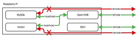

Access
Limit access
If the application allows it, you can limit access of certain applications to localhost, avoiding remote access.
In my project, I've applied this to two applications: motion and MySQL.

Motion
The same applies for motion:
pi@webserver ~ $ netstat -ln | grep 8081
tcp        0      0 127.0.0.1:8081            0.0.0.0:*               LISTEN

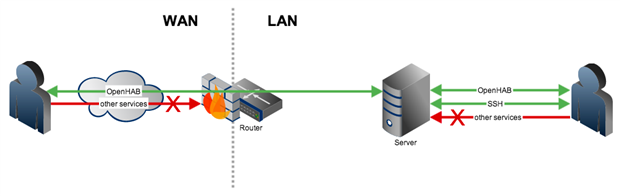

Firewall
Finally, don't expose everything to the internet. If you have a firewall, only enable access to the services you want to be remotely accessible.
In my case, SSH might be accessible from inside the network, but it isn't from outside.
