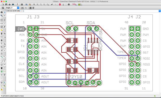

In the past weeks, I experimented with the GP2Y10 dust sensor from Sharp. Using an Arduino all was well, but I was however running into problems when using it with the CC3200. It's not the only issue I encountered with the CC3200. There was also the fact that the I2C pins of the CC3200 and FuelTank did not match.
I've tried to tackle both issues with a custom BoosterPack (my first!).

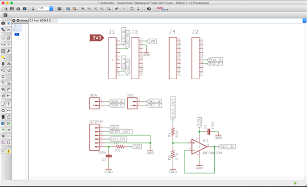

Using Eagle, I created a schematic and board. Now, I don't have much experience with Eagle. I did fiddle a bit with it during the Forget Me Not challenge, but never got to making an actual PCB. Fritzing seems to be more up my alley, but anyway ... let's proceed.
I loaded all the required parts in the schematic and started connecting all the dots. There are four parts to this schematic:
  • the opamp circuit as suggested by shabaz in Week 11
  • the circuit required to hook up the dust sensor
  • the launchpad headers
  • an optional I2C connection to overcome the mismatch between FuelTank and CC3200
This is the schematic:
For the board, I laid out the components across the available space and let Eagle do the routing. This is the resulting board:
Nothing spectacular, but I'll be more than happy if I manage to get it soldered and working image
    DAB over 11 years ago +3
    I remember hand drawing board layouts and then having the graphics folks lay down the traces with ink before we could do a photo transfer to a board. You guys have it much easier today. DAB
    Jan Cumps over 11 years ago +2
    fvan , I've also created a FuelTank-to Standard adapter for the Hercules LaunchPad MK I, Mine was just a pin-rerouting - no additional functionality like your boosterpack . Loaded it to OSHPark, and never…
    shabaz over 11 years ago +1
    Hi Frederick, Great stuff. Looking forward to seeing the assembled board!!

    fvan over 11 years ago in reply to Jan Cumps
    I made a quote from Würth, since we were getting a 50 EUR budget to do that. Unfortunately, that ended up becoming a 75-80EUR thing including shipping for a single board.
    On Seeedstudio, it was 12EUR including shipping for 10 boards, just need to wait a little bit longer ...
    Würth's PCBs will most likely be of (much) better quality, but in this case it's not really relevant as my main purpose is to get a functioning prototype and practice surface mount soldering.
    Jan Cumps over 11 years ago in reply to fvan
    fvan, who did you choose to produce the PCBs?
  • fvan
    Hi guys,
    thanks for the feedback image
    It's true that nowadays everything has become easier through software, but also through hardware like 3D printers and CNC machines. I can see a time come rather soon where even PCBs will be produced at home at the click of a button.
    But in the mean time ...the PCB has been ordered, I hope to get it soon!
    Frederick
    Hi Frederick,
