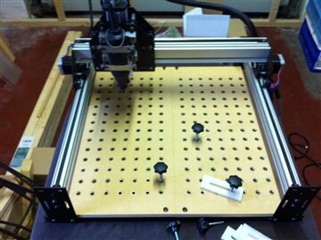

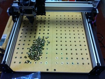

Before getting to the actual milling, I completed a modification to the stock waste board of the ShapeOko2.
I drilled a whole bunch of holes (totally overdid it!) in the waste board and screwed in threaded insert. This will help me clamp down the work piece when milling, instead of using tape like I did until now ... There were about 200 inserts to screw in, so I ended up with a few blisters on my fingers. I'll survive, and I'll spare you the pictures image

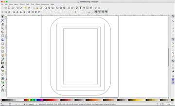

The first thing to do was making the measurements of the screen. The BB View is not symmetrical, a bit annoying but not a problem. Once I had the measurements done and verified, I ported them to inkscape.
The flow is as such:
  • a line drawing is made in Inkscape and exported as *.svg
  • the *.svg is imported in Makercam
  • a milling operation is associated to a line or area
  • gcode of the milling operations is exported from Makercam
  • the gcode file is interpreted by the GcodeSender application
  • GcodeSender passes the commands to an Arduino UNO which controls the stepper motors

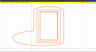

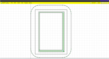

Everything went well in Inkscape, but once I imported it in Makercam, the rounded edges caused a glitch:
Errr, right. I tried various things to get that fixed but nothing helped. So instead, I used rounded corners. I wanted to try something different, but as it didn't work, I had to move on and not waste too much time.

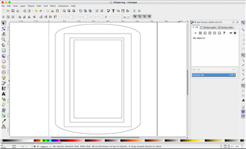

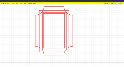

That's when I realized I forgot to mirror my design, as the milling will happen on the back side of the panel. And of course, there had to be another glitch ...
What is it today with things going wrong ?? I removed the outer shape and redrew it unmirrored. That did the trick.

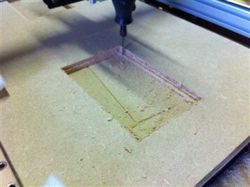

With the drawing finally properly imported in Makercam, I started associating milling operations to the lines.
The inner rectangle needs to be cut out completely. To do this, I used the "follow path" operation which will mill the rectangle for the entire thickness of the piece of MDF.
The second rectangle needs to clear an area for the screen to slide in. This calls for the "pocket" operation.
Finally, the outer edge uses the "follow path" operation to cut out the piece completely.
Makercam visualizes the operations by means of arrows, taking into account the width of the drill bit to determine how many passes are required. With the operations calculated, the gcode was exported and imported in GcodeSender. A simulation can be run to confirm everything is as intended.

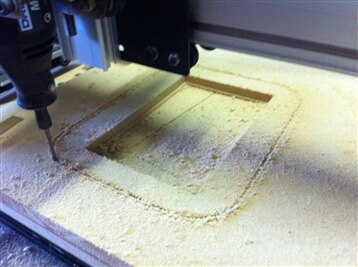

All ready to go, I clamped down a piece of MDF to cut out the shape from, set the Dremel in position and hit the "send" button.
image By the way: when working with a CNC or any other power tool for that matter, wear protection and be careful! Safety first!
Now, back to milling. Here are some "action" shots of the milling in progress. I regularly took the vacuum cleaner to get rid of the material being milled off.

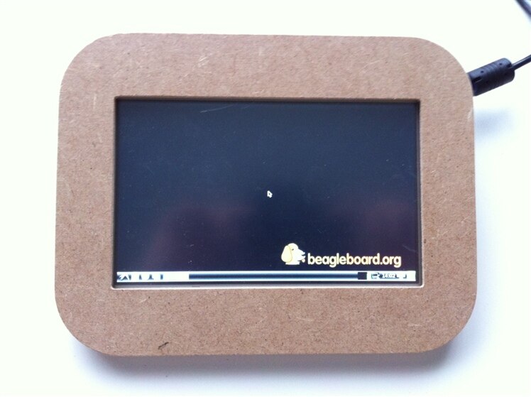

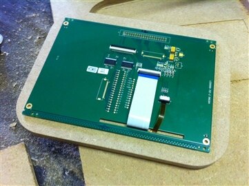

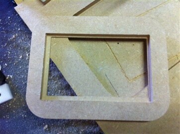

Result
The result is not bad at all (if I may say so myself). The piece came out clean and only required a tiny bit of sanding.
I'll be milling more pieces to make it a "PiBow" style enclosure in which I can fit all the electronics.
