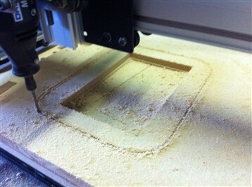

With the drawing finally properly imported in Makercam, I started associating milling operations to the lines.
The inner rectangle needs to be cut out completely. To do this, I used the "follow path" operation which will mill the rectangle for the entire thickness of the piece of MDF.
The second rectangle needs to clear an area for the screen to slide in. This calls for the "pocket" operation.
Finally, the outer edge uses the "follow path" operation to cut out the piece completely.
Makercam visualizes the operations by means of arrows, taking into account the width of the drill bit to determine how many passes are required. With the operations calculated, the gcode was exported and imported in GcodeSender. A simulation can be run to confirm everything is as intended.
All ready to go, I clamped down a piece of MDF to cut out the shape from, set the Dremel in position and hit the "send" button.
image By the way: when working with a CNC or any other power tool for that matter, wear protection and be careful! Safety first!
Now, back to milling. Here are some "action" shots of the milling in progress. I regularly took the vacuum cleaner to get rid of the material being milled off.
Result
The result is not bad at all (if I may say so myself). The piece came out clean and only required a tiny bit of sanding.
