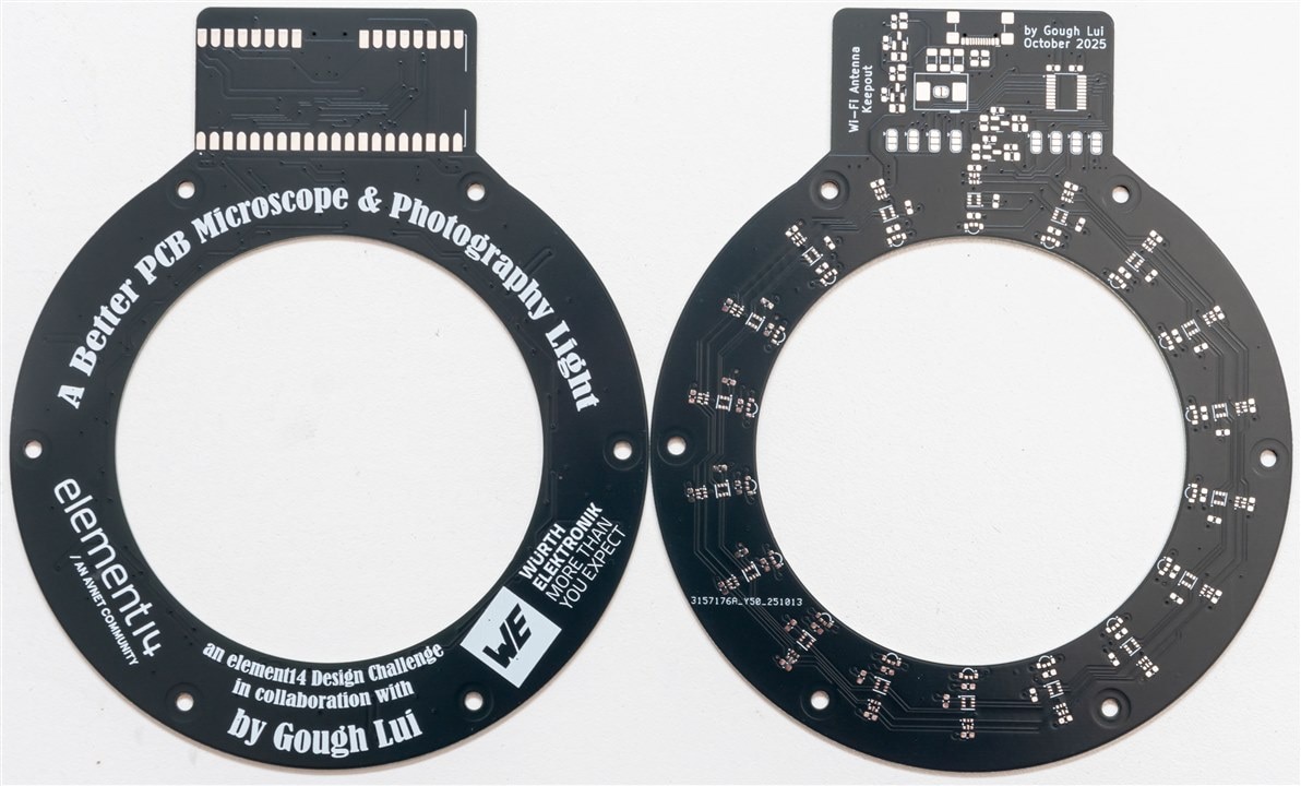

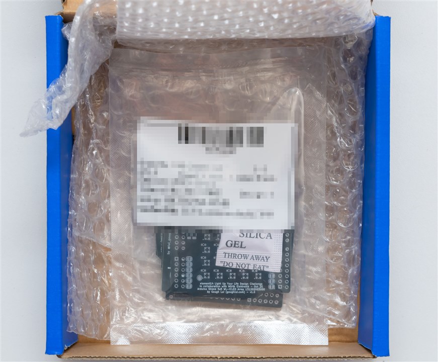

One PCB Arrives
This week, I received my first parcel. Thanks to the modern miracle of express couriers such as DHL, which take advantage of air transport and logistics, and the streamlined processes of Chinese manufacturers such as JLCPCB, it was just under a week from uploading my files to receiving this parcel on my doorstep. It did come at a price though – about AU$22 more than the “economic” shipping option so that’s about the cost of a lunch meal here. It was a choice I made to ensure that it would arrive before the due date – but now that the challenge has been extended by two weeks, economic shipping may have been enough.
Arrgh. It’s happened again! This box arrived upside down … a common issue in Australia. But alas, thankfully, this is something that’s recoverable.
Thankfully, as it was well packed, the boards survived their upside-down journey.
The PCB is the main PCB and I’ve got five of them as that was the minimum order quantity. What I’ll do with the remaining four, I have no idea!
The black solder mask was a bit glossier than I had originally anticipated, but it was purposely chosen to avoid reflecting stray light, rather than maximising output with a white solder mask as other LED projects may use. You can see the silkscreen graphics are quite nice – what a shame much of it will be covered once the whole thing is assembled.

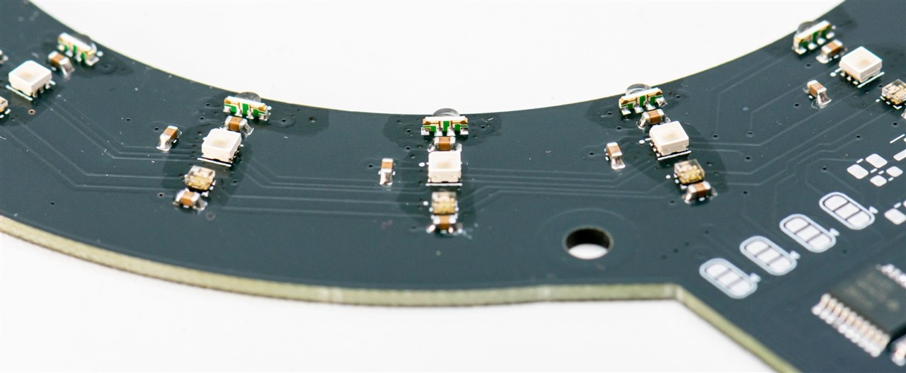

Only after handling the board in-person, did the soldering challenge become truly apparent to me.

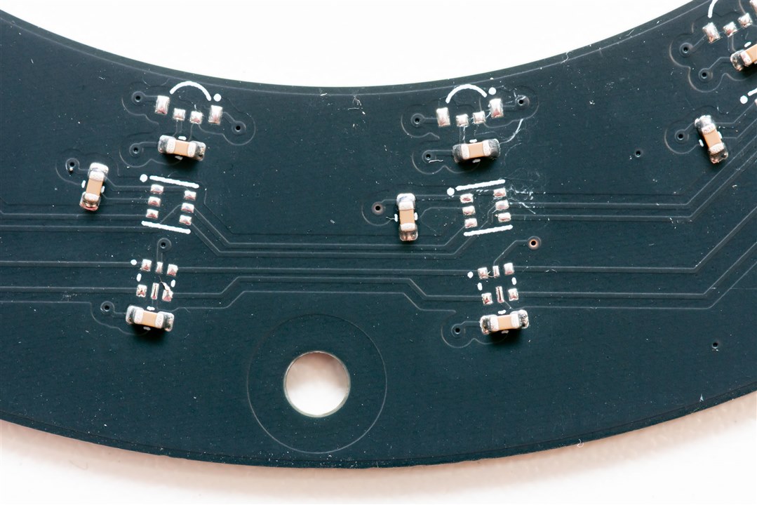

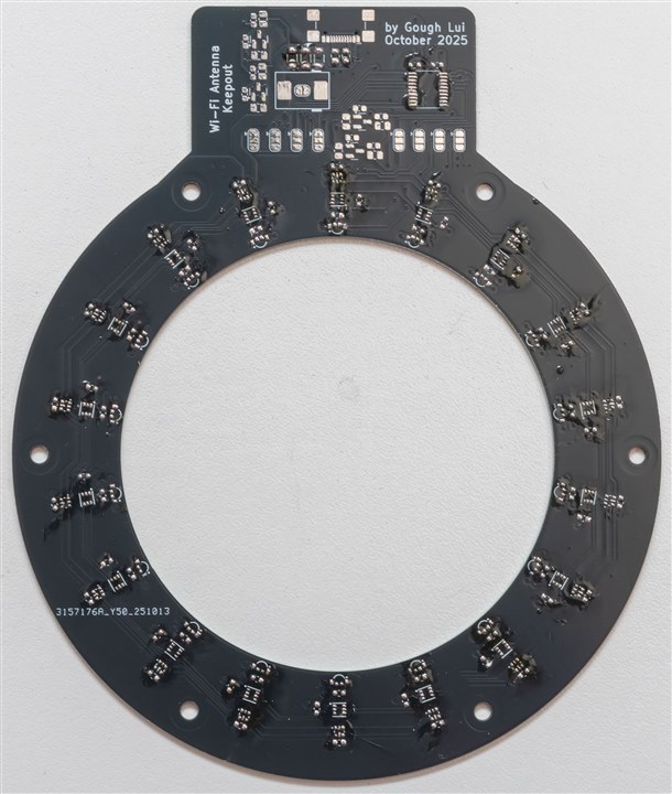

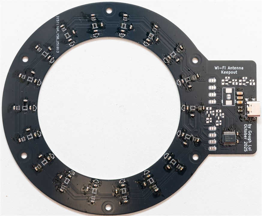

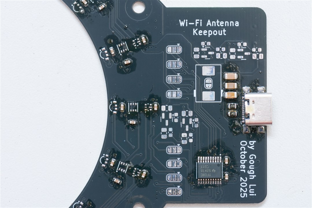

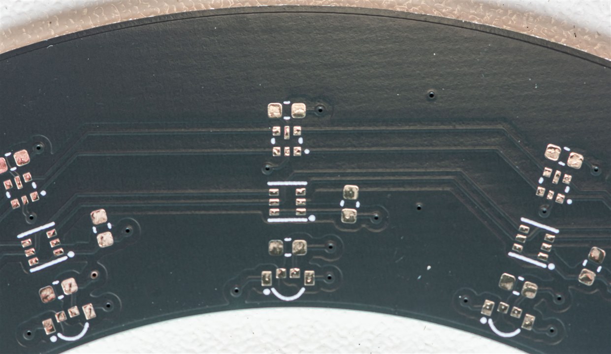

So let me show you how I put those “secrets” into practice. From a fresh board, the first step I do is tin the pads where the heat-tolerant components are to be fitted.

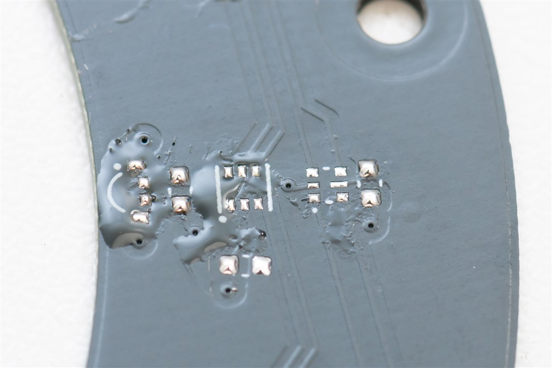

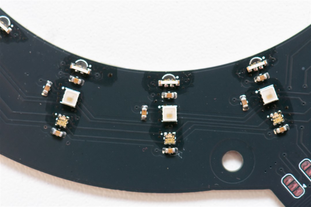

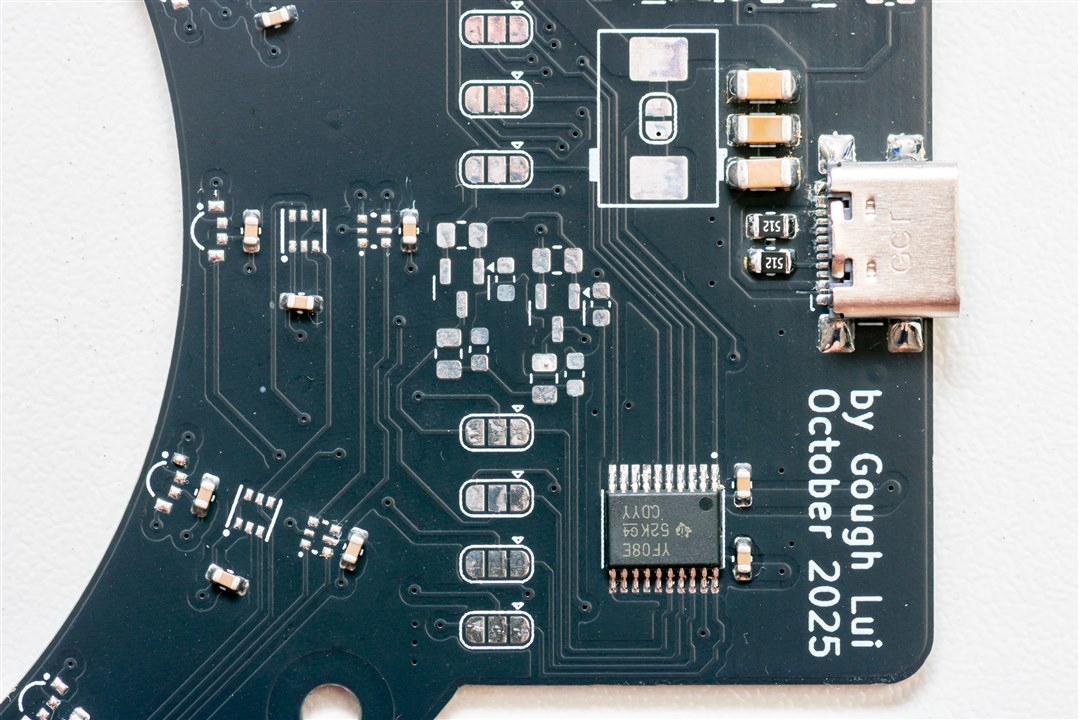

This is because I don’t use solder paste and I don’t order a stencil either. Instead, my method is depending on the solder mask and the geometry of the pads to just “hold” enough solder to make the connection. This works for a range of SMD sizes – but won’t necessarily work for very fine pitch (<0.4mm) which may have insufficient solder and exposed paddles or very large component pads which might get too much solder. In-between seems to work just fine.
After tinning, the remnant water-soluble flux from the solder wire is left on the board. It looks somewhat bad, but it’s a tolerable amount of residue.
I then go over all of the connection points with my flux pen to add fresh flux and hand-pick and place parts into their approximate position. As these are heat-tolerant components, I can heat-gun directly from the top.
After this, the capacitors, resistors and level shifters are fitted just fine. I ran a second cycle for the USB-C connector, but heating from the underside, as this is a heavy thermal mass part which requires a bit more heat and I didn’t want the other more sensitive components to suffer. The result is a partially populated board with a notable amount of flux residue.
It looks dirty, but this is where the magic of water-soluble fluxes come into being. Taking the PCB to my sink, I shove it into a bucket of warm water and agitate it, refreshing the water several times over. Then, I take the board out, give it a good hit with a battery operated air duster to “push” off all the water droplets and then leave it on the bench with a fan pointed at it for a couple of hours to dry out.
It’s not quite perfect – there’s still some residue near the USB-C connector but it’s much cleaner. Removing the old flux is necessary because the flux becomes more viscous and less active – leaving it on the board when populating the LEDs makes it more difficult as the flux might “float” the LED and not allow the solder joints to make.
Clean footprints ready for soldering the LEDs. As they are sensitive, they must be done in one or two goes at the most. As a result, I went over the pads with the flux pen, populated all three types at the same time and hot-air gunned from the underside to secure them into place.
Looking good – those LEDs will “shimmy” into place as the solder liquefies and as long as it looks well aligned with the footprint, there’s no reason to intervene.
If they’re not quite in the right place, you can give it a gentle tiny nudge with a pair of tweezers on the base of the LEDs – never touch the lens though, as that can get soft and separate from the LED, damaging it permanently as it might tear off the bond wires and dies, not to mention altering the optical properties.

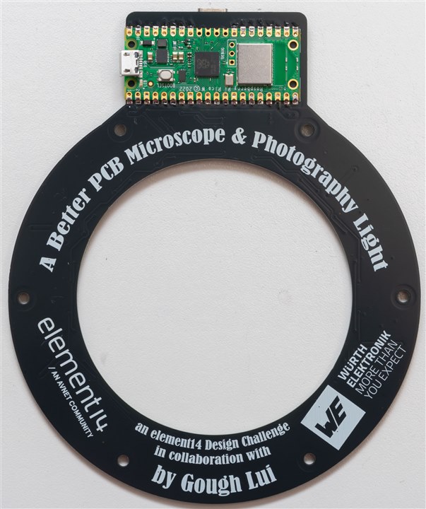

Now that all of the components on the main side are populated, I can hand-solder the castellated Raspberry Pi Pico W module to the back side with a soldering iron. This order of population avoids stress to the Pico W and conflicts where components on the underside might be damaged by heat or restricts your ability to heat from the underside.
One of the main outcomes was no damage to the solder mask or the silkscreen – overheating the rear side of the PCB is a possibility for those not careful in their hot air gun control. This would usually result in discolouration to charring and delamination.

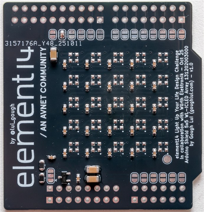

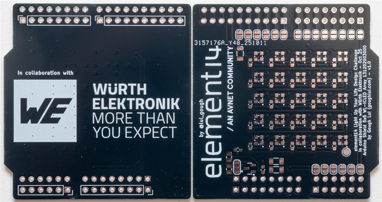

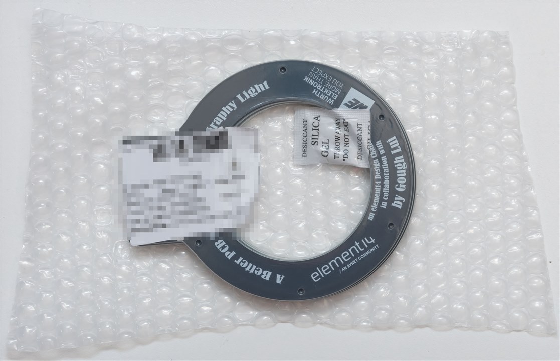

Another PCB Arrives
The second package arrived, also upside down at least on the outside. This parcel took about five more days (considering it was an order that was submitted earlier and arrived later), but the total cost for this one was only about AU$6.50 for the boards and postage combined. Very affordable!
Not only was the postage economical, but the box they used seemed to be a bit economical too with their logo offset from centre.

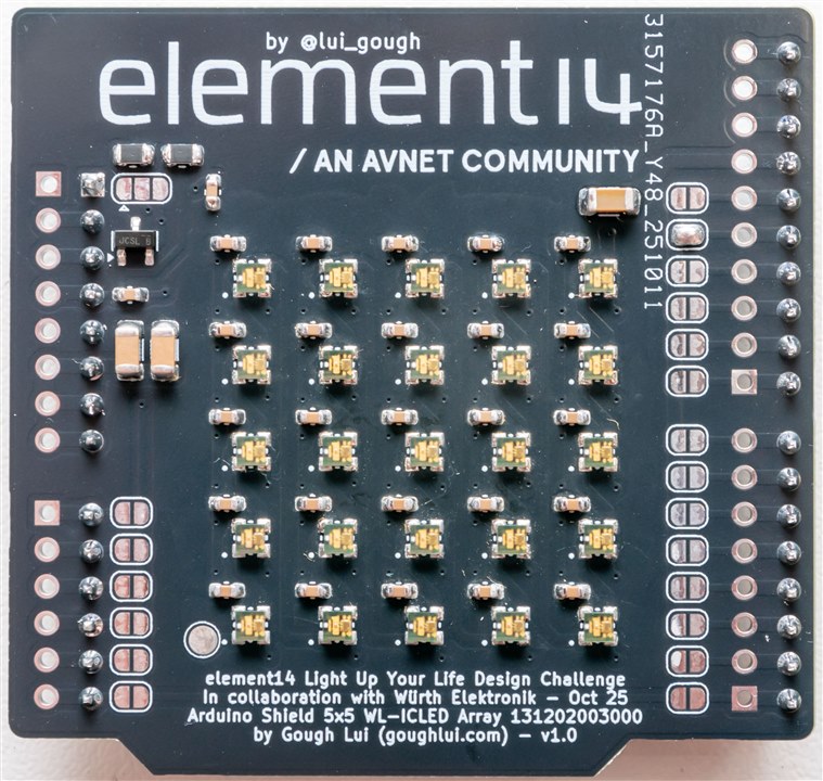

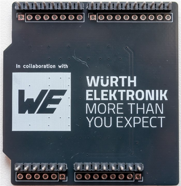

Another five boards, but I’ll only really need one of them.
Just as designed, but made physical.
No Room for Mistakes!

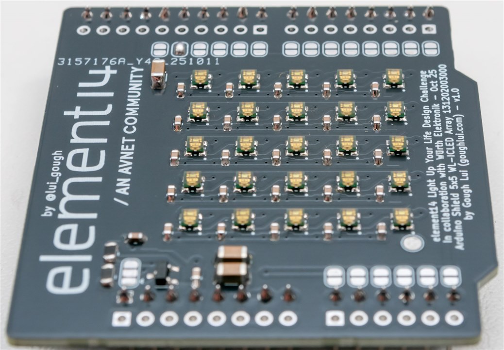

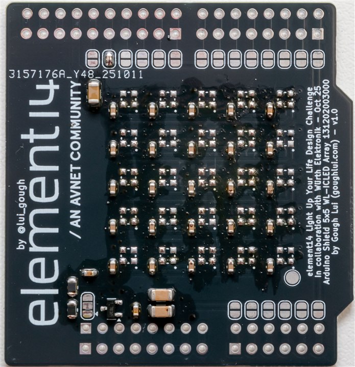

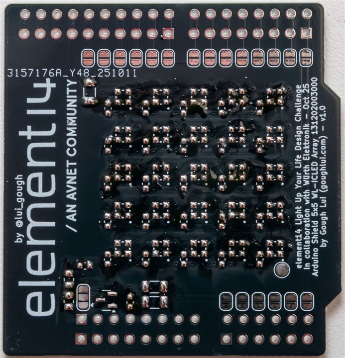

This particular PCB poses a new challenge – a 5x5 array is 25 total LEDs. Well, our challenger kit only gives us 25 of that particular type of WL-ICLED, so there’s no room for mistakes. Don’t get nervous now! Getting nervous is a sure-fire way to make a mistake!
Let’s go about it in the same way – tin the pads.
Place and reflow the heat-tolerant components using top side heating and flux pen.
Wash off the flux to make it clean.
Apply fresh flux, place sensitive components, heat from underside. Then fit the other sensitive through-hole headers, using the Arduino Zero to guide the location of the header pins and hand solder.
Wash the board thoroughly and dry. Job done!
Perhaps a little too much solder as the joints are a hair on the blobby side.
No harm to the underside, even though I heated from the rear to get all those LEDs to solder. That’s just how I like it!

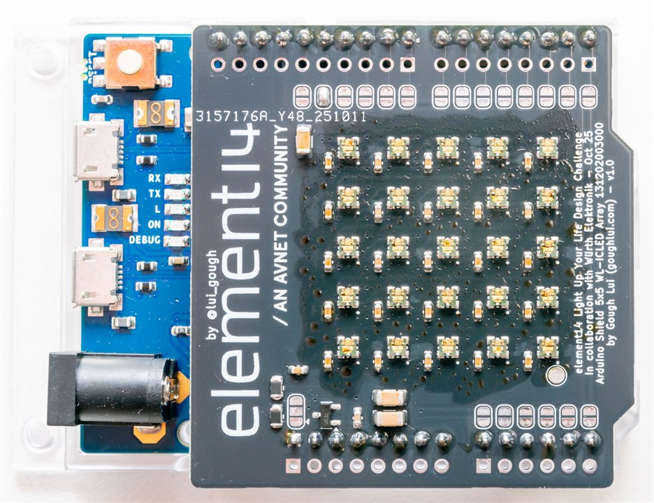

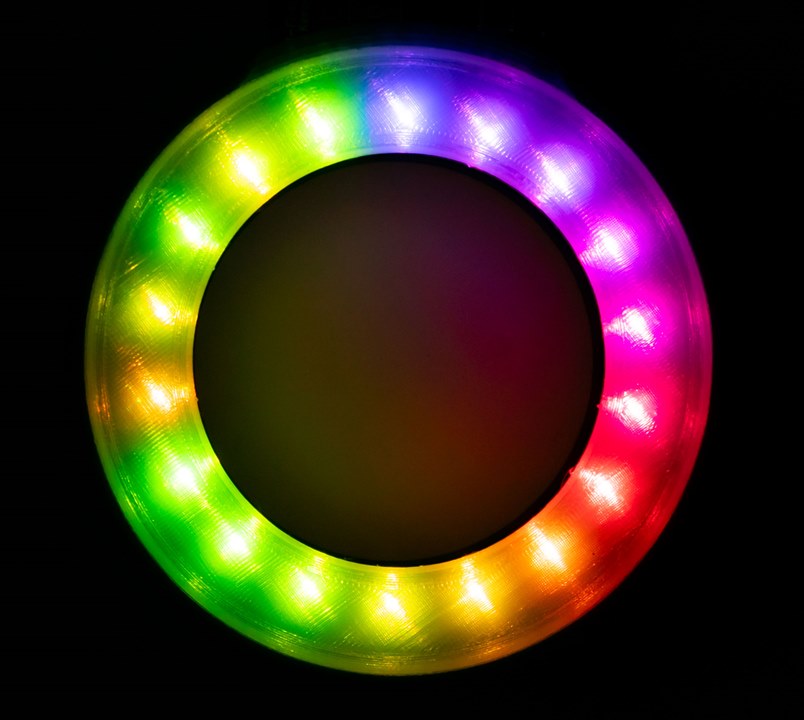

Testing the Boards
I modified the demoreel_100 demo as before, but with the correct settings for these LEDs and by adding a sequence that displays black, red, green, blue, white, black prior to the demo reel for testing. Rather than provide the whole program (as they are trivial changes), I’ll provide just the LED settings used –
Microscope Light Board
// FIRST STRING - EDGE FIRING
#define DATA_PIN    11 // Raspberry Pi Pico W
#define LED_TYPE    WS2812B
#define COLOR_ORDER GRB
#define NUM_LEDS    18
// SECOND STRING  - DOWN FIRING
#define DATA_PIN2    10 // Raspberry Pi Pico W
#define LED_TYPE2    WS2816
#define COLOR_ORDER2 RGB
#define NUM_LEDS2    18
// THIRD STRING – WIDE AREA DIFFUSE
#define DATA_PIN3    3 // Raspberry Pi Pico W
#define CLK_PIN3   2
#define LED_TYPE3    APA102
#define COLOR_ORDER3 GBR
#define NUM_LEDS3    18
Arduino Zero Shield
#define DATA_PIN    12 // Arduino Zero
#define NUM_LEDS    25
As proof of functionality, I filmed a video of the boards running the tests with some commentary about the journey so far:
In all, the boards worked, but the WS2816 high-definition compatible “48-bit” type LEDs exhibited some sort of flicker when dimming up and down with FastLED compared to the 24-bit types. I suspect this may be due to the way that the extra bits are used, but it’s not a big issue as for me, the LEDs will mostly be “static” at various fixed settings. But for artistic applications, perhaps some investigation as to why the flicker occurs will be necessary.

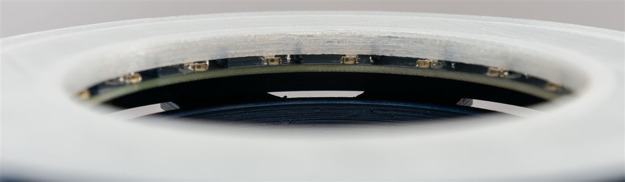

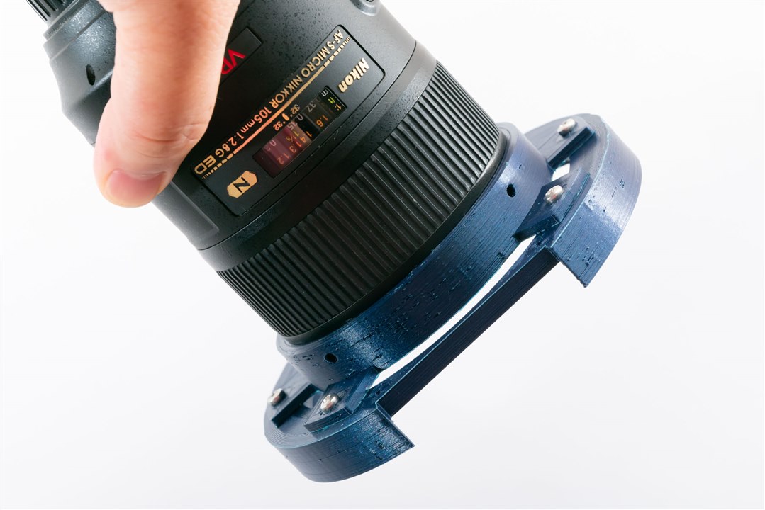

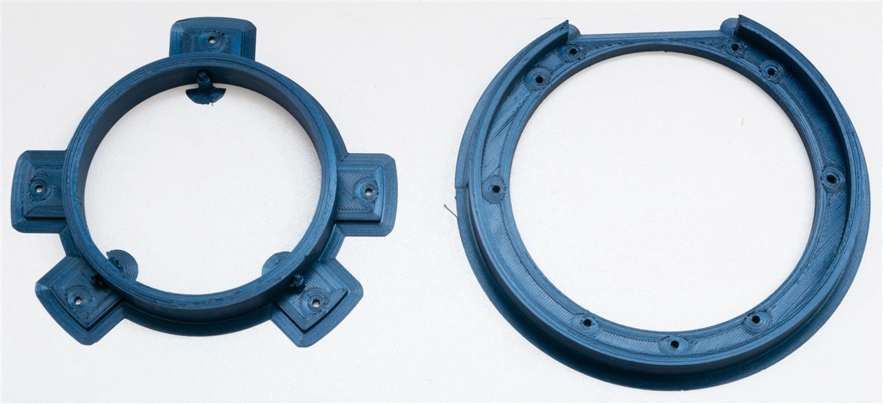

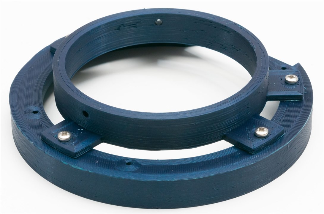

The first thing to be printed on my ailing Anycubic Mega P was the protection ring and the lens connection ring. To do this required a bit of tinkering with the Bowden tube which had torn off from the extruder and cleaning of the textured glass bed as it would seem that accumulated oils had resulted in poor bed adhesion.
For these parts, I chose to use a more premium PLA of a dark colour to avoid stray light reflections. For this, I ended up using my sample reel of Polymaker PolyLite Metallic PLA Pro in metallic blue.
The prints were made with a skirt for adhesion, to avoid any issues with warping on the base. After removing the support, it was possible to assemble these parts together.
I used some short M3 screws to secure the two halves together for a solid connection.

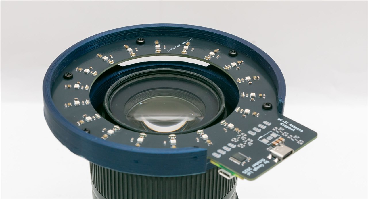

The diameter of the neck is just perfect to slip over the front of my NIKKOR 105mm macro lens and stay in place, just with friction. It is gripping on the coloured “gold ring” on the lens – a part that doesn’t rotate and does not interfere with the focusing ring or the filter threads.

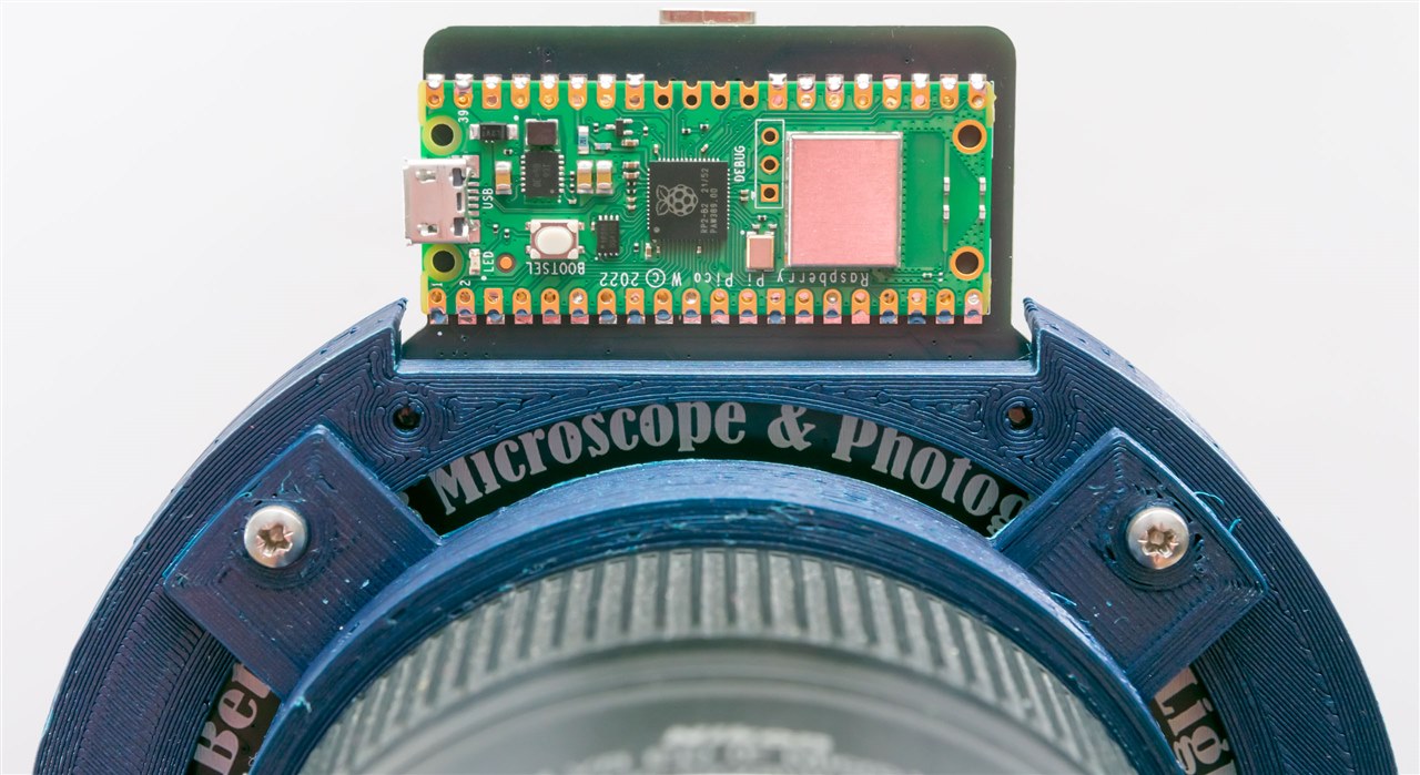

The board was installed into the assembly, with black M3 screws to avoid light reflections. It fit well for the most part, but the “handle” that has the Raspberry Pi Pico W didn’t quite have enough clearance, so I had to use side cutters to cut away some of the plastic to allow the board to sit properly. Because it was a minor bit of cutting, I decided it wasn’t necessary to revise the design.

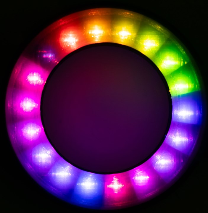

The design has a nice clearance around the Raspberry Pi Pico W. While it’s quite exposed, it’s also quite nicely “featured”. Too bad the silkscreen on the back is mostly covered.

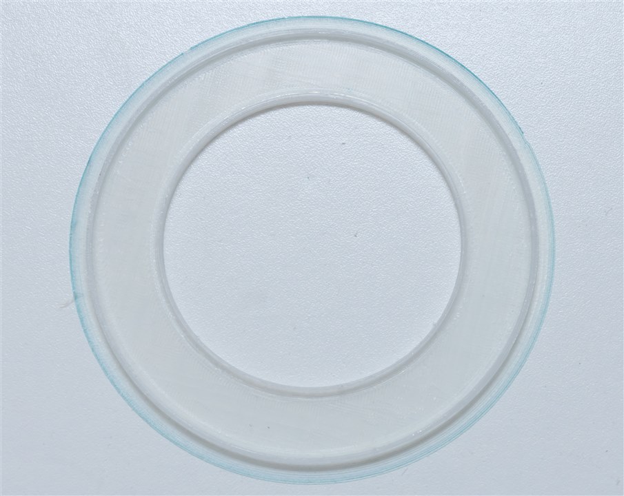

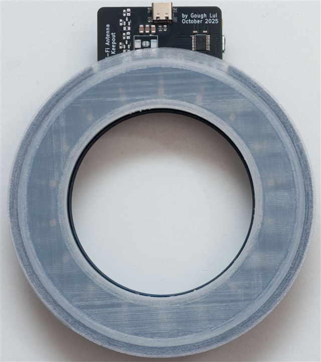

Ultimately, I thought the diffuser is absolutely necessary because some of the LEDs don’t “mix” the light quite well enough for my liking. So I decided to print a diffuser using some cheaper Kingroon Translucent PLA.
The original design was a tad too small for a friction fit, so I decided to make it a bit larger and deeper to make use of the “ribbed” texture of the prints to hold the diffuser in place automatically without the need of any fixing devices.
The result looks quite okay even without removing the skirt on the print.
Because the 3D printed layers are at right angles, there is some enhanced diffusion effects. But the angular resolution didn’t seem quite on the level I had hoped as adjacent LEDs sort of “blended” into one another.

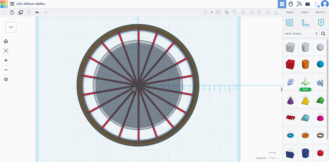

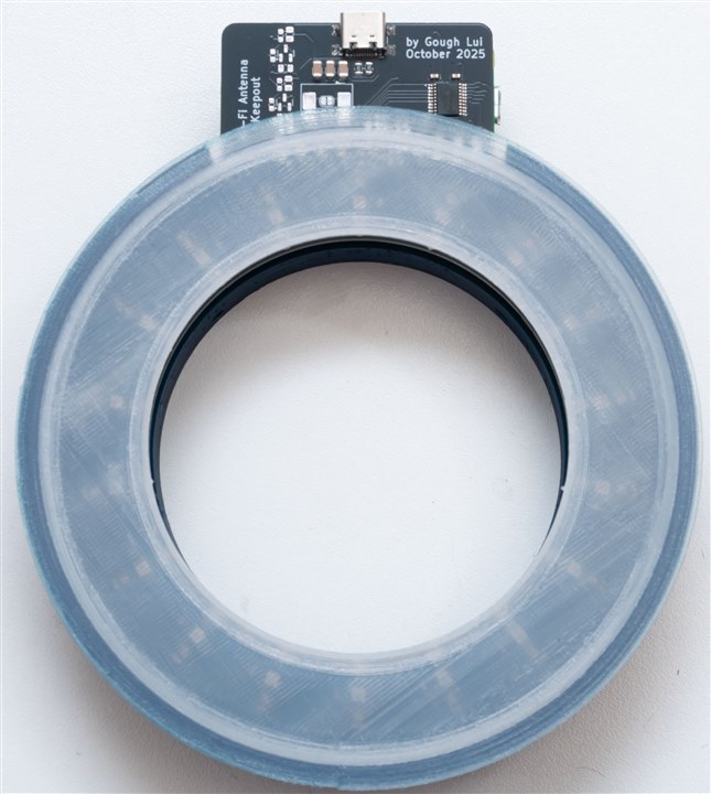

As a result, I had to go back to the drawing board …

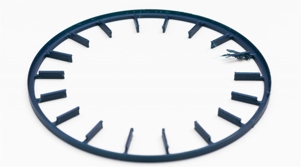

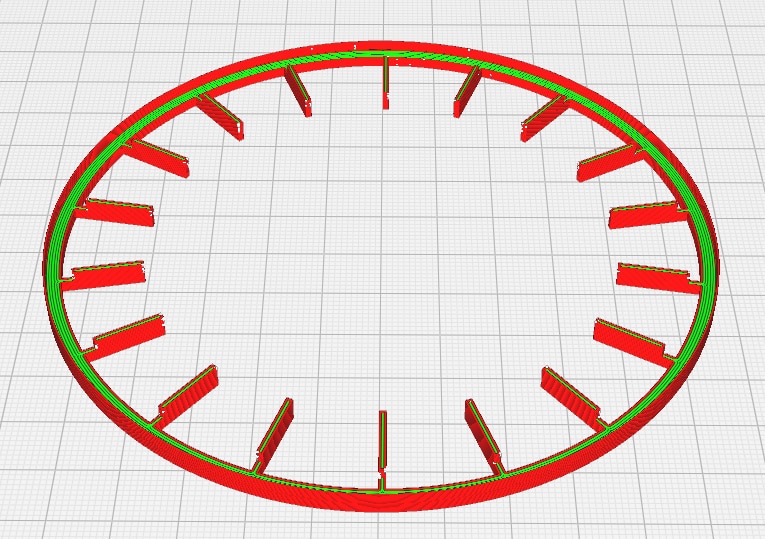

… and developed a baffle that could be inserted behind the diffuser. It would be slightly “big” – pushing from the inside of the diffuser while the outside ring is also pushing in from the outside, making it a nice “sandwich”.
The design needed a bit of fine tweaks to allow for the screw heads to not interfere too much.
My first print wasn’t quite successful because of a loss of bed adhesion on one of the “fins”. But I decided to clean the bed and try again, which was successful. A print without skirts was chosen, as cutting away the skirts would have taken a lot of extra work.
While this isn’t 100% ideal for alignment, it was a design that would work – just being slightly off-set in terms of angle.

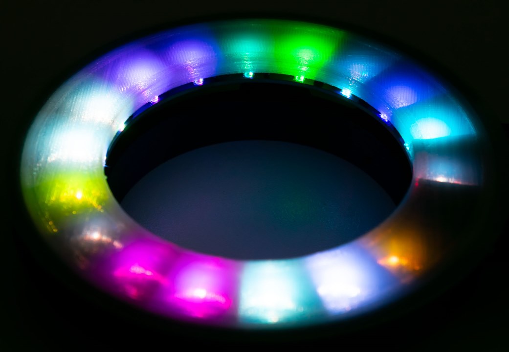

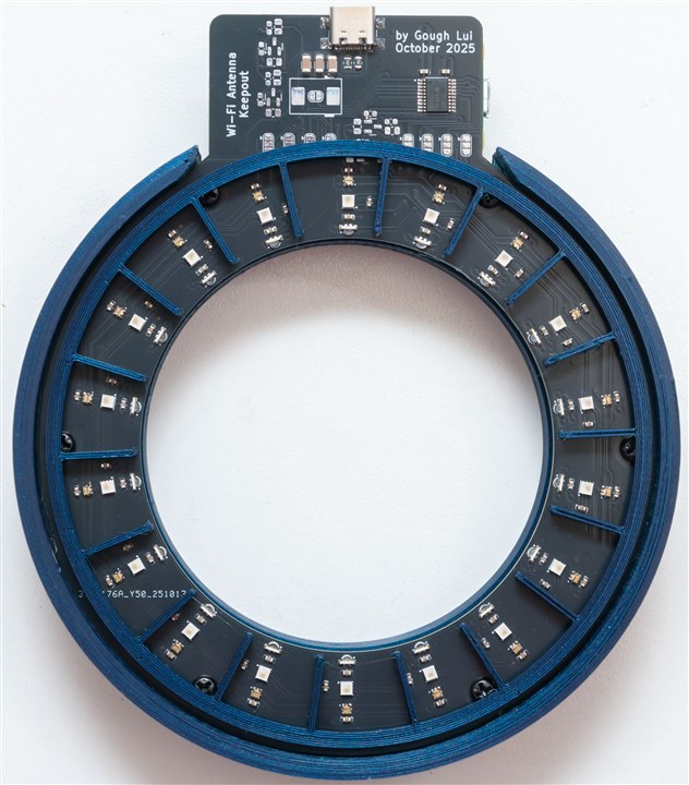

The sandwich with the baffle and diffuser in place …
… it doesn’t affect the clear gap for the edge-lit LEDs.
The light is much more compartmentalised now!
It almost reminds me of the “Wheel of Fortune” game show … but I feel this is much better than my first attempt!

    In each of the pictures with the LEDs lit, there always seem to be one or two that are way darker than the others. Is this a defect in assembly or just a side effect of using a demo code to control the LEDs?
    In the Assembly, Step by Step section, the second picture shows a section of the PCB with an all gray background with some sorts of bubbles, like those one would get when badly applying a window tilting film. I tried rereading the accompanying text but I could not find a reason for this.
    But once again, this is all very impressive and way beyond my skills and patience in soldering.
    This is because the demoreel_100 demonstration is running on the board, dimming and chasing the dimmed LED across the whole array, back and forth. This effect is clearest if you watch the video in this post where the demo is running, but if you take a photo mid animation, you get that result.
    I presume you're referring to this image:
    What you're seeing is not actually bubbles, but is remnant water soluble flux from the solder wire after the pads have been tinned. In my case, I'm using 0.8mm Loctite Multicore soldering wire which contains embedded Hydro-X flux.
    But to explain this further -
    • Soldering wire contains flux which is an agent that works, when heated, to essentially clean the metal surfaces such that solder can effectively "wet" the joint.
    • When you buy a certain diameter of soldering wire, the flux cores inside the solder-wire are arranged such that there is a sufficient amount of flux to make the joint. As it turns out, this can be different depending on the type of flux used but generally, it's not a fixed ratio and is somewhat diameter dependent in my experience.
    • This is something I've observed but, say you have 0.6mm solder wire (cross-sectional area of 1.13mm^2) and 1mm solder wire (3.14mm^2). Based on area ratio, you might expect around three 0.6mm solder wires twisted together will give you the same effect as a single thicker 1mm solder wire. But in reality, what you often get is more flux from this arrangement than a true 1mm solder wire - this just has to do with how the wires are manufactured, so it's possible to end up in a situation of having too much flux if using thinner wires. I learned this because when I was younger, I was wondering why people didn't just buy a very thin solder wire and twist it up to the thickness they needed ... now I know!
    • If you're used to no-clean solder wire, the amount of flux residue (i.e. flux left on the board) after soldering is usually a small amount of a clear, moderately hard substance. But as I've mentioned in the "secrets" chapter - I prefer the use of water-based fluxes as they can be more easily and reliably be removed. When using water based fluxes, it's not uncommon to have more residues, but they are thinner in nature - almost like the consistency of cooking oil.
    • This is not a problem, since water-based fluxes MUST be washed off the board using warm-to-hot water, leaving a clean result.
    So perhaps this might look somewhat alarming, it's actually quite normal for water-based flux use, and because of the use of thin diameter solder wire which would dispense more flux when used to "tin" the pads. I usually "flood" the pads with more than enough solder, picking up a "ball" of stale solder at the end of a row of pads (in the picture above) and dumping it into my sponge. This usually leaves a shiny, low-oxidation solder layer all over my pads which is what I'm after. If I only use just barely enough solder, then it's often likely that the solder could go "frosty" due to oxidation and such solder is likely to form cold joints when reflowed later.
    One of the downsides of this method is that you do end up using more than the necessary amount of solder during tinning to ensure that you don't leave behind stale solder for later reflowing. After all, there's only so much flux can do to "revive" oxidised solder and reflowing in air is essentially like using a soldering iron to re-heat an already-made joint - there's only so much time in air that the solder can be "hot" before it goes stale and is liable to making a "cold" joint.
    Excellent questions and hope this helps explain the process a little more.

    Thanks for the advanced explanation, it clarifies things even further.
    What really surprised me is the difference in hue between the "large" picture where the PCB is black and the "close up" picture that you correctly identified where the PCB is light gray.
    That made me (wrongly) assume that some sort of film had been applied all over the place, with the "bubbles" being air trapped beneath it, just like what happens when applying tinting film on a window or a car.
    But the more I think a bout it, the more it seems related to the close up illumination as the other PCB boards appear in different tones of grays/black depending on the picture.
  • Gough Lui
    Gough Lui over 1 year ago in reply to obones
    Unfortunately, that's mostly because my lighting source is fairly directional (flash illumination) and the glossy black PCB finish means that it can be quite reflective if light is hitting it at just the right angle. A matte-textured solder mask wouldn't have this kind of angle-dependency, but also, the exposure of each photo varies a bit too.
    But rest assured, it's one and the same board ... :).
