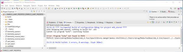

      • I had a few Roadblocks and the design was more difficult to implement than I had expected.
      • I was able to get the Heart rate Sensor BPM values through the PSoC6 onto the AWS MQTT Broker.
Any Problems?
        • I had problems that were resolved.
        • I had problems:
          • With the MosQuiTTo broker working with the Anycloud mQTT Client example, I could not get the example to connect to the broker.
          • With the AWS IoT thing configuration, that I finally figured out.
          • With the PSoc^ series example, Building and executing it
          • With The BSP importing the PSoC6 series Example.
          • The Connection with the UART.

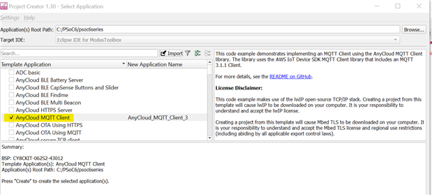

Appendix B - AnyCloud MQTT Client example in ModusToolbox.
This appendix describes my experiences with the example
    • It serves two purposes:
      • you have an example,
      • and it takes care that the dependencies are all available in your workspace.
    • Load the example "" AnyCloud MQTT Client:" from the template Application list
      • If your not sure how to do this, I describe it in my blog#2 section Create a "New Application"
      • image
    • Follow its instructions to connect you to AWS MQTT. You'll need to do the exact same steps with other MQTT projects. If you know it works with the example, it makes the next steps easier.
      • GitHub example READ.me
      • Set up an AWS account.
      • Setup a AWS IoT thing called "ledstatus"
      • Make changes described in Appendix C- Setting up the MQTT Broker -- AWS IoT MQTT
      • Run the example.
      • Observe the results described in the READ.me file.

10/20/2021 - I Ran into a SNAG
The Project Won't build?
  • DETAILS:
  • when trying to follow step 1 above "open the Library Manager and click Update. " I get the following error.
  • image
Solution
  • I worked through this problem with the author of the code with Jan Crumps
  • In short there was a problem with one of the HTTPS libraries used in ModusToolbox 2.3 and the BSP.
  • This caused the author, Jan Crumps to change the Project to work with ModusToolBox 2.4 and the BSP 3.X
  • The project is available on the GitHub repo:
    • version 3.1.0 - adapted to ModusToolbox 2.4 and BSP 3.X
  • I reinstalled ModusToolbox 2.4 and imported the project ino my workspace
  • I was able to build the project
  • I Ran the application.
