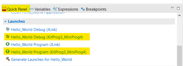

    • Launch the Program.

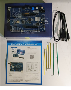

What's in the Box
The blue box contains the following---------------------------------------------------------------------------------------
  • PSoC 62S2 Wi-Fi BT Pioneer Board
  • USB Type-A to Micro-B cable
  • Four jumper wires (4 inches each)
  • Two jumper wires (5 inches each)
  • Quick Start Guide
Front of the BoxBack of the Box

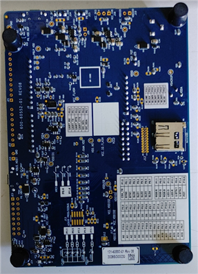

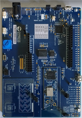

Front Of the boardBack of the board . I like the rubber feet. It's a nice touch.
Quick start guidesame as this link at https://www.cypress.com/file/487011/download
FRONT View
CY8CKIT-062S2-43012 QUICK START GUIDE
PSOCRegistered 62S2 Wi-Fi BT PIONEER KIT
Kit Contents:
1 PSOCRegistered 62S2 Wi-Fi BT Pioneer Board
2 USB Type-A to Micro-B cable
3 Four jumper wires (four inches each)
4 Two jumper wires (five inches each)
5 Quick Start Guide (this document)

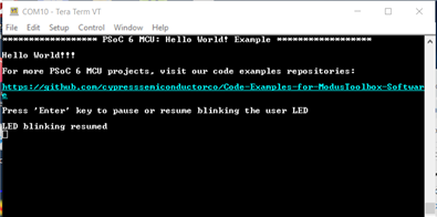

Run the Preinstalled demo
  • In the quick start guide it stats:
    • "Visit the kit website to download and install the required software."
    • on the www.cypress.com/CY8CKIT-062S2-43012 there was no software to be found?
  • So, I tried to follow the rest of the directions and I was not able to get the terminal to work as specified.
  • So, I then downloaded and installed the ModusToolbox.
  • After the install, I noticed a new driver in the device manager and I had a new com port: COM10 in the TeraTerm dropdown that was not there before
    • image
  • My guess is, that the ModusToolbox installs the KitProg3 Driver and assigns it to COM10.
  • Now the demo displays information as described on the TeraTerm screen when I plug in the USB cable
  • Plug the USB cable between the KitProg3 USB connector on the board and your PC used for development.
  • Now observe LED8 blinking on and off every second.
  • Information displayed on the Terminal screen.
    As directed "Press 'Enter' key" will  pause or resume the blinking the LED8

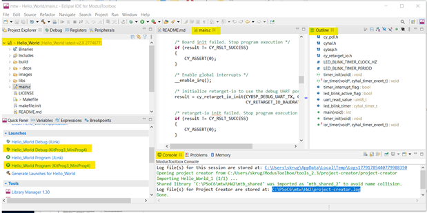

  • I'm assuming this is the code used in the Pre-programmed example, since the output on the terminal is identical.
  • I will experiment with the "Hello World" example to learn more about the workings of the IDE.
  • Follow these steps for Windows,  if your interested, otherwise you could follow along with your Linux or Mac install.
Open ModusToolbox from the windows start menu.
  • Form the "ModusToolbox 2.3" Folder, Select the "Eclipse IDE for ModusToolbox 2.3"

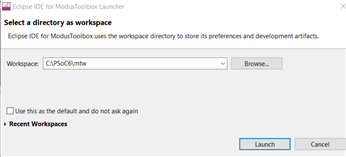

Select a Directory as Workspace
  • Use the "Browse" button on the following dialog box to select a workspace
  • A workspace is the root directory for your project.

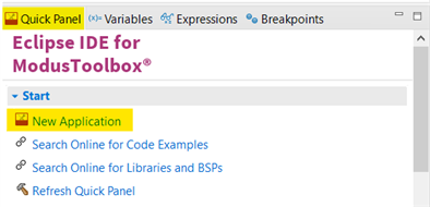

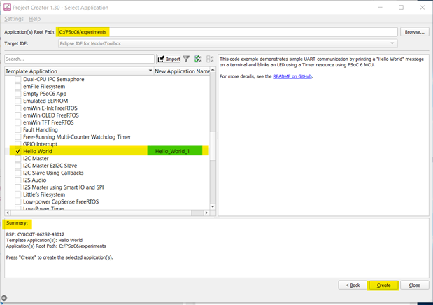

Create a "New Application"
  • There are several ways to start a new project, but go to the panel described below and select " New Application"
ProjectCreator
  • After you have clicked on the  "Run Application" button, the Project Creator GUI pops up.
  • The Project Creator GUI tool provides a series of screens to:

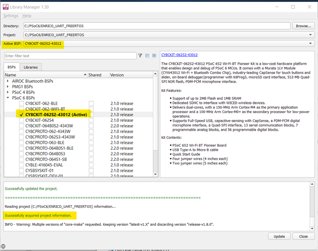

    • Select a Board Support Package (BSP) for the kit (CY8CKIT-062S2-43012) that you will be using.
    • Select code examples
    • specify the application name and location

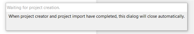

  • The following message dialog appears (on Windows it shows up under the ProjectCreator window)
  • image
  • You cannot go back to the main IDE Window and this will go away after you have created the example project.

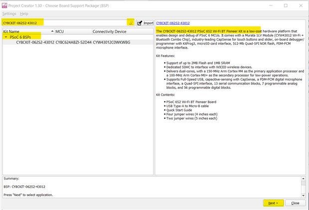

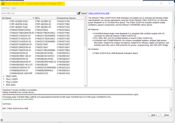

Board Support Package (BSP) Dialog Box
  • The first box to appear is  the "Project Creator 1.30 - Choose Board Support Package (BSP)" dialog box pictured below.
  • image
  • There seems to be a lot of information here, but what you will be doing is selecting the CY8CKIT-062S2-43012 part number as the BSP.
  • You can find the part by placing "CY8CKIT-062S2-43012" in the search box as described below.
  • image
  • Observe the search bar and when the part is entered takes you to the "PSoC 6 BSPs"  CY8CKIT-062S2-43012 part with a link to cypress kit webpage and a description of the product in the right panel.
  • Click ""Next" located in the bottom right of the dialog.
Select Application Dialog box
  • After you select the "NEXT" button", the following "Project Creator 1.30 - select Application" dialog box  appears.
  • image
  • On this dialog box, you get a list of examples you can select from. The examples are retrieved for you from the GitHub repository.
  • You can Rename your location of the project,
  • You can search for an example name or word and the example will show up in the list. For example if I enter "FreeRTOS" all the examples containing it in the description or in the title will be displayed.
  • You can select multiple example Projects and they will be loaded into the IDE.
  • For this exercise, scroll down to "Hello World" and check it
    • It's not apparent, but you can change the name of the project by clicking over the textbox indicated in green in the above picture. Then type in a new name and press Enter.
    • There is also a description of the example in the right window panel.
    • A Summary of the settings is displayed in the bottom panel.
    • Press the "Create Button" to create the project.
    • You will see activity displayed in the bottom panel of the process.
  • The process takes a while but the build is being done and eventually the ProjectCreator dialog closes and you are returned to the ModusToolbox screen described below

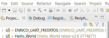

Back on the Main Screen
  • image
    • On this screen there are now several windows that contain information
    • The Project Explorer Window displays the source code.
    • As you double-click on a file, The contents is displayed in the Editor Window to the right
    • To the right of the editor is an Outline Window that displays of the source objects for quick navigation.
    • To the bottom of these 2 windows is the Console Window, that displays where the log files are located if you need to find them.

  • GO to the Launches section located in the "Quick Panel" as described below.
  • image

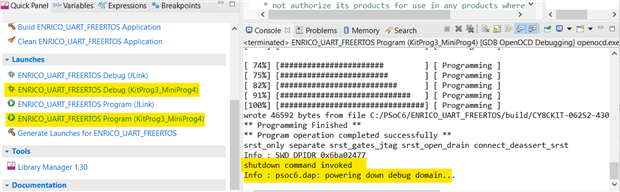

  • Get the TeraTerm Terminal up and running
  • If not already done, plug in the USB cable between the kit and the PC your running ModusToolbox on.
  • Select the  Hello_World Program  (KitProg3_MiniProg4) button. I'll be getting into the debugger later.
  • The compiled code is programmed to the kit.
  • You will see information in the Console window.
  • When finished the program will begin to execute.
  • Congratulations, you have successfully implemented your first example application in ModusToolbox to the PSoC 6 Kit

    • I used CYBCKIT-062S2-43012 as the BSP for all his projects as described  in the photo to the right. All the blogs worked for me

      • PSoC 6 and ModusToolbox: Create a Project with its own Board- and Module configurations
        • I tried this out and was confused at first because the Shared directory for the BSP device was not listed as described in Step 2.
        • What I had to do was make the device  shared in the Library manager. It was unchecked by default. When I checked it and selected "Update", the directory was created. Now you can follow along to the rest of the steps.
        • This a neat feature, but since I'm only using the CY8CKIT, I'm not sure if I'll be using this configuration. I don't plan on changing the BSP at this stage of my development.

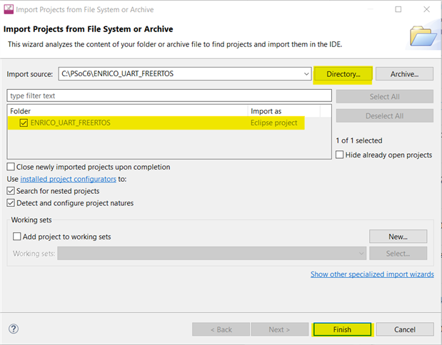

            • Unzip the archive to a temporary directory.
            • All of the the project archive examples in Jan's blogs use the CY8CPROTO board, because he is implementing the software design on this kit.
            • This should not be a problem, since the kits look similar and ModusToolbox has the capabilities to update a project o a different BSP and Library support using the Modustoolboox Library Manager,
            • Refer to Appendix A-Importing and Converting a project to using the CY8CKIT

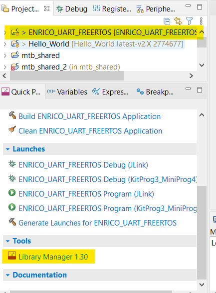

          • After getting the project into ModusToolbox follow the instructions at the end of the blog post to:
            • refresh Quick Panel

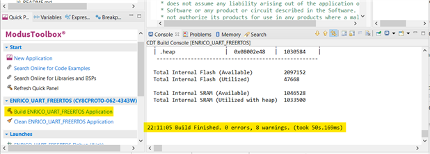

            • Build the Application
              • If it builds , then Run it by using the "Quick Panel" Run commend

Appendix A - Importing and Converting a project to using the CY8CKIT
  • This appendix will describe how to load an existing Project from the filesystem.
  • It will also describe how to convert the project from the kit CY8CPROTO-062-4343W  that is used by Jan Crumps.to the CY8CKIT-062S2-43012
  • use the File/Open projects from file system. The following dialog will appear
  • image
  • image
  • The project is imported viewable in the project tab as shown above .

  • Select the project on the "Project Explorer" and click the Library Manager in the "quick launch" window under tools.
  • image
  • Now the Library manager pops up as describe below
  • Note the BSP tab is displaying CY8CKIT-062S2-43012 in the list.
  • Select CY8CKIT-062S2-43012 and note that it turns bold with an (Active) indication.
  • you can Unselect Y8CPROTO-062-4343W, since you won't be using it.
  • The dialog should look like the picture below.
  • image
  • Select Update
  • The library manager will do it's thing and when it's done, the dropdown for active BSP contains CY8CKIT-062S2-43012.
  • Try to build. the project by selecting the Build <project name>
  • image
  • If successful plug in the USB to Prog3 USB connector
  • From the Launches section in "quick panel" select either <program name> Debug/Program  (KitProg3_MiniProg4))
  • image
  • Congratulations you have imported and converted to the kit to use the CY8CKIT-062S2-43012 Evaluation kit.
