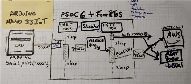

System Level Flow Diagram
  • The System design includes 2 decoupled designs that are connected together over a serial connection.
    • One design is taken from a previous design that I did for an element14 design challenge : Design for A Cause 2021
      • It uses the Arduino Nano 33 IoT Board
      • Python is used in a Bare Metal application.
    • The second design is based on a project by an element14 member, Jan Crumps.
      • I will be using his design to implement my idea.
      • I experimented with Jan's series of blogs in my previous  blog Post
      • These blogs turned out to be using an Arduino connected to a PSoC 6 Kit (a different kit)  UART, so I decided to try and use his design.

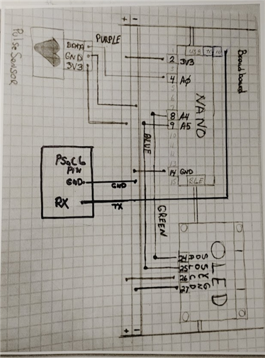

Wiring Diagram

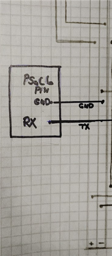

  • This section will shows the pins used on the Arduino and the PSoC6 to make the serial connection. The pins are connected using jumper wires.
  • connect a jumper wire between a 3.3 V Arduino GND to a PSoC6 GND pin
  • connect a jumper wire between the Arduino TX pin to a PSoC6 RX pin
  • A wiring diagram with these jumper connections is described as follows.
    • This diagram was modified from the wiring design diagram from my previous design challenge.
  • imageimage

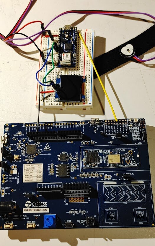

  • Here is a pic of the 2 boards connected.
    • image

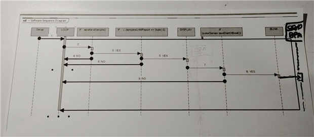

UML Sequence Diagram
    • This section, shows the logic of the flow of the Software used on the Arduino.
    • I modified the sequence diagram in the Arduino design to add the task of Writing the heart rate value to the serial port
    • It's a little messy, I marked the diagram by hand as the last step  in the sequene.
    • It comes after the BLINK action...
    • image

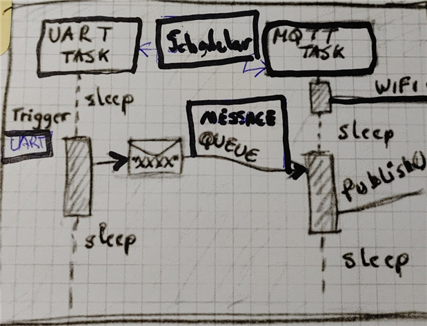

  • The FreeRTOS Scheduler is used to Run the 2 major task
    • UART TASK
      • receives BPM values from the serial connection.
      • And sends the values in a message to the queue.
    • MQTT TASK
      • This task will connect to the cloud
      • The message is read from the queue and published to the cloud.
  • image

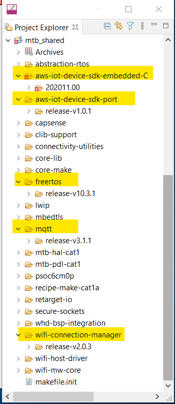

PSoC6 Design
        • For now I've taken a photo of the mdb_shared folder for my project.highlighting the known libraries.
        • image
