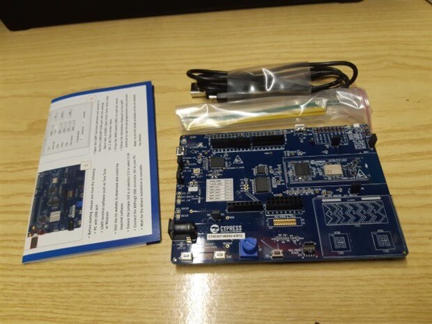

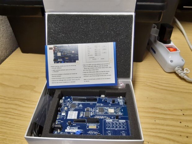

The kit
I recently received the kit for the challengers
and, in the parcel, there was a nice surprise from Infineon
So thanks Element14 and Infineon for the opportunity!
