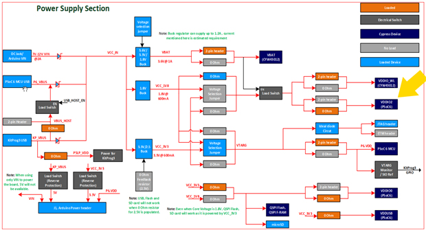

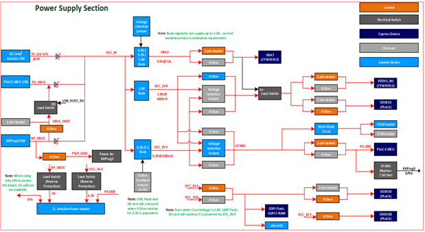

Let's first have a look at the power supply section of the evaluation board
Unfortunately, the board has been designed with the goal of being as easy-to-use as possible, so a 3.3V power supply has not been provided. The only way to switch the board on is to connect a 5V power supply either to the kitprog3 USB port or the MCU USB port.
Even if I did my best to follow the guidelines and best practices suggested by Cypress to save power, probably this is going to be absolutely useless with this evaluation board because there are many external components (power regulators and converters) that are always on and may consume a consistent amount of current
Current measurement points
But, I can at least check if I did a good job by measuring current consumption at any of the test points available on the board. According to the schematics, there are at least three jumpers where current consumption can be measured

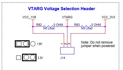

J14
By means of this jumper, you can select the VCC voltage (1.8V or 3.3V) and measure the total current consumption of the PSoC6 MCU plus external components

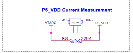

J15
Here the current consumption of the PSoC6 MCU only can be measured

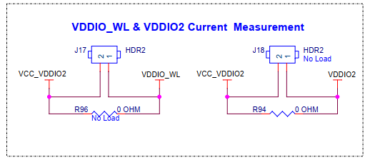

J17 & J18

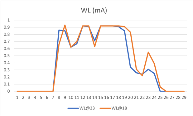

Here the current consumption of PSoC6 VDDIO and WiFi Module can be measured
Measurement results

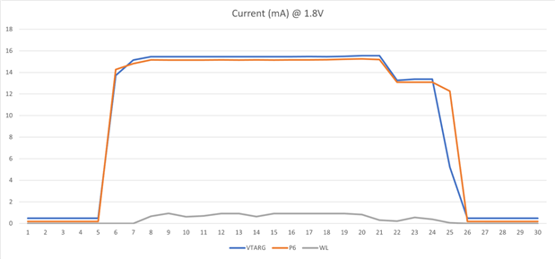

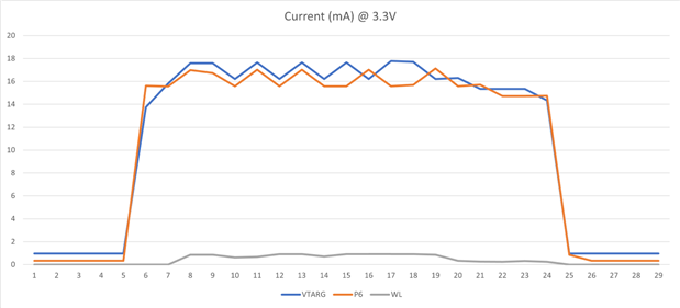

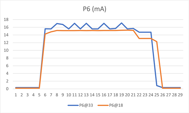

Here are the results of the measurement. All the graphs refers to the typical application cycle, namely
  • hibernation
  • wake-up from hibernation, scan, send scan results
  • back to hibernation

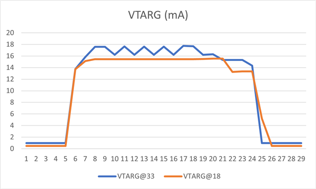

For the above-mentioned test points, two measures have been performed
  1. VTARG = 3.3V
  2. VTARG = 1.8V
This is a table showing power consumption in different conditions
ScenarioVTARG (V)Current (mA)Power (mW)
Hibernation3.30.96
3,168
Hibernation1.80.480,864
Active3.317.7758,641
Active1.815.4727,846
