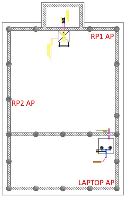

Then, I created a test environment with three WiFi access points: my laptop and two Raspberry Pi. I placed the access points in my garden (because I didn't have enough room in my house to make significant RSSI measurements) and walked along an imaginary grid

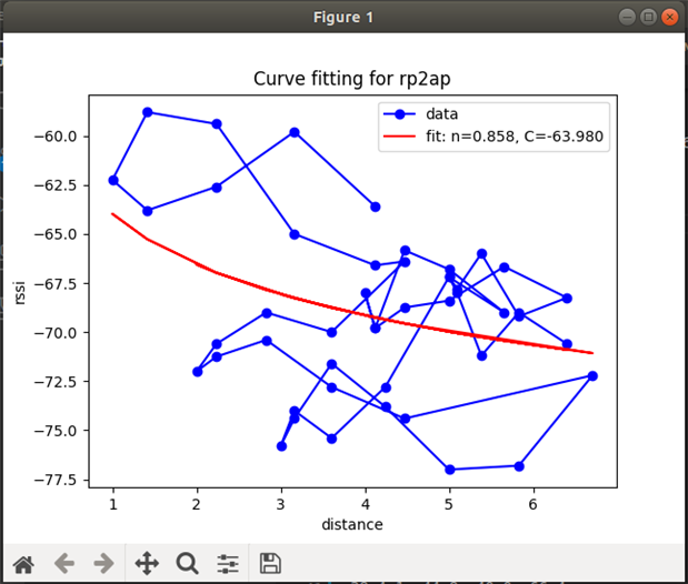

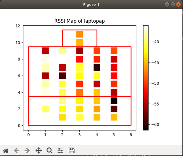

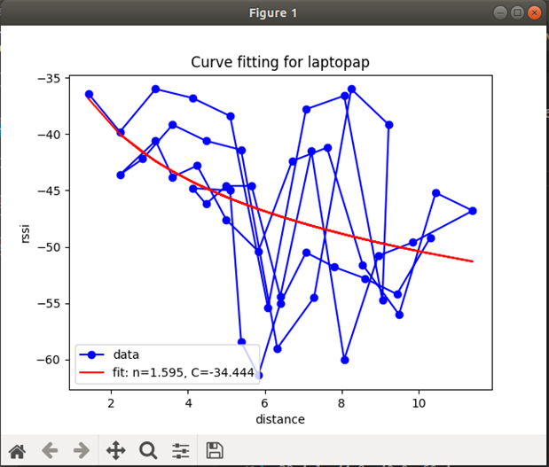

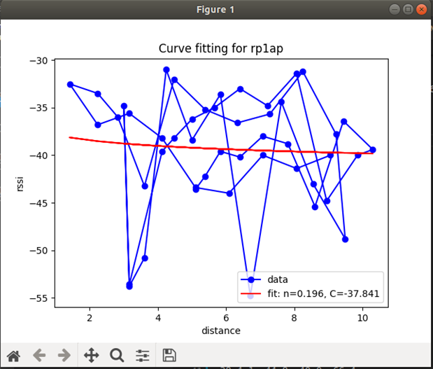

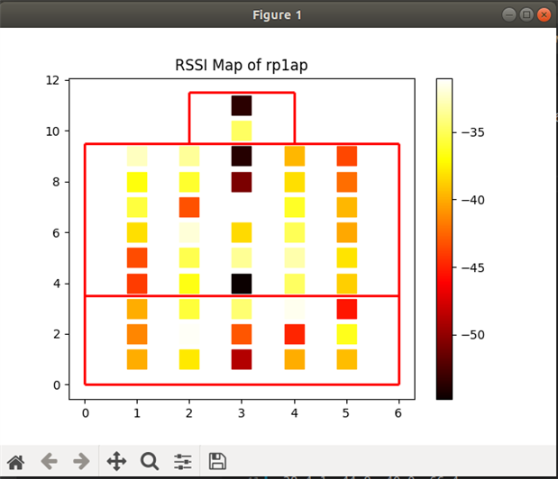

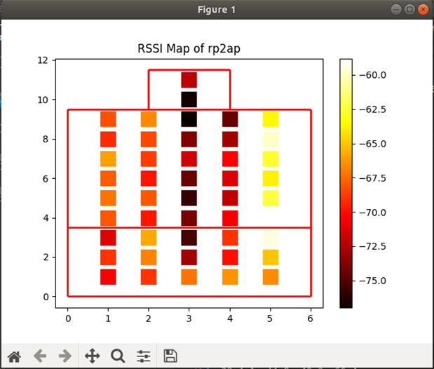

The file has then been processed to create the heatmap. From terminal, I launched
pyhton3 heatmap.py
This Python scripts computes the average of the five RSSI readings for each position and compute the best fitting curve by invoking function scipy.optimize.curve_fit
popt, pcov = curve_fit(func, distances, network_mean_rssi)
where network is the access point's name and network_mean_rssi is the array of RSSI mean values
A color heatmap is also drawn by means of matplotlib.pyplot.colorbar function
minx = min(network_mean_rssi)
maxx = max(network_mean_rssi)
N =  len(network_mean_rssi)
norm = mpl.colors.Normalize(vmin=minx,vmax=maxx)
sm = plt.cm.ScalarMappable(cmap=cm, norm=norm)
sm.set_array([])
plt.colorbar(sm)
heatmap.py finally saves RSSI mean values to a CSV file for later use by localization script

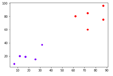

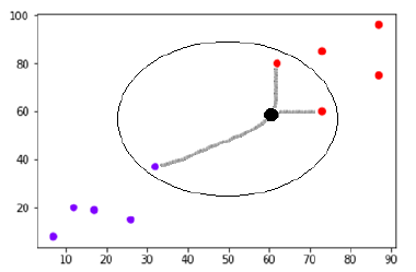

The estimation uses a k-nearest-neighbor algorithm. The concept behind KNN algorithm is quite simple. Suppose we have a dataset that can be plotted as follows
Now, we need to classify new data point with black dot (at point 60,60) into blue or red class. We are assuming K = 3 i.e. it would find three nearest data points. It is shown in the next diagram
We can see in the above diagram the three nearest neighbors of the data point with black dot. Among those three, two of them lies in Red class hence the black dot will also be assigned in red class.
