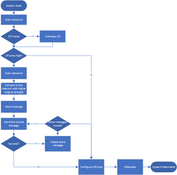

In this post, I will create the skeleton application for the PalletTracker
This is a very basic flowchart of the application
The skeleton will include the following components

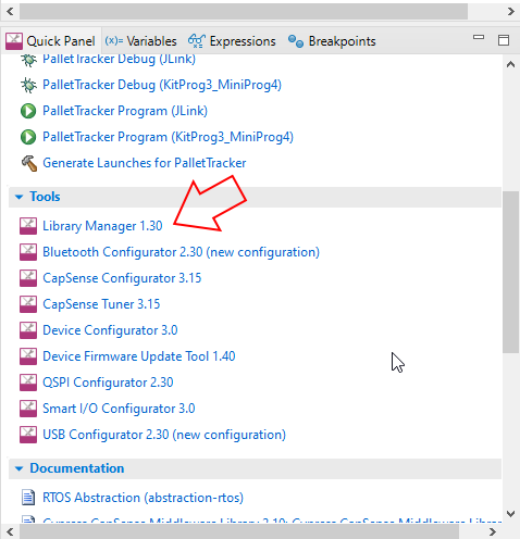

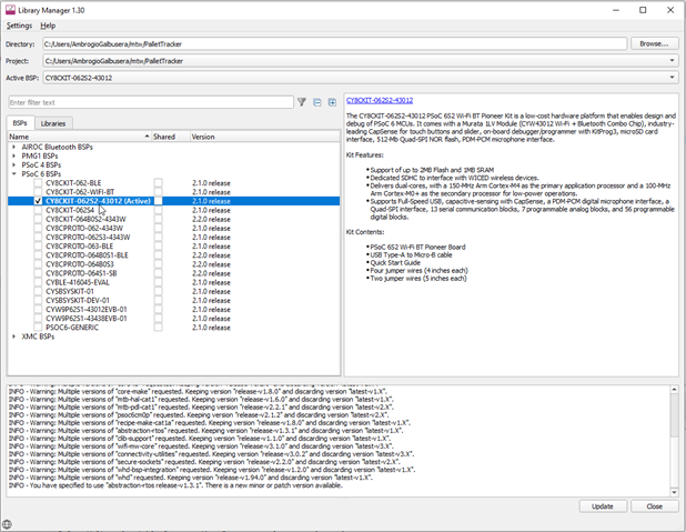

Adding libraries

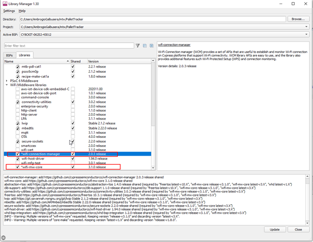

Modus Toolbox provides a very convenient tool to manage the libraries in your project. The tool can be launched from the Quick panel
When launched, the Library manager let you (eventually) change the BSP. I will leave it unchanged and click the "Libraries" tab
Here I flagged the following libraries
NameDescription
wifi-connection-manager
Wi-Fi Connection manager (WCM) provides a set of APIs that are useful to establish and monitor Wi-Fi connection on Cypress platforms that support Wi-Fi connectivity. WCM library APIs are easy to use, and the library also provides additional features such Wi-Fi Protected Setup (WPS) and connection monitoring.
wifi-mw-core
Core components needed for Wi-Fi connectivity support - bundles FreeRTOS, lwIP TCP/IP stack, mbedTLS for security, Cypress Wi-Fi host driver (WHD), configuration files and associated code to bind these components together. These components are bundled as ".lib" entries; each ".lib" points to the respective repositories, where they are hosted. All but lwIP and mbedTLS libraries are hosted on Cypress' Github repository. lwIP and mbedTLS libraries are hosted on their respective external repositories. Includes predefined configuration files for FreeRTOS, lwIP and mbedTLS for typical embedded IoT usecases; and associated glue layer between lwIP and WHD, and mbedTLS and lwIP.
These libraries are part of the Anycloud solution, which provides a ready-to-use framework to implement cloud connectivity
These libraries however has some dependencies, so the following libraries are also automatically selected
NameDescription
abstraction-rtosThe RTOS Abstraction Library provides a generic API that allows Cypress middleware to be written in an RTOS agnostic manner. It also contains implementations of the Abstraction Layer for FreeRTOS, CMSIS RTOS, and ThreadX.
core-libThe Core Library provides device agnostic utilities that all middleware can rely on. This includes a generic result type and some common utility functions.
core-makeCore Make build system provides generic build files and scripts for building and programming ModusToolbox applications.
retarget-ioThe Retarget IO library provides APIs for transmitting messages to or from the board via standard printf/scanf functions using a UART connection which is generally connected to a host machine.
capsenseCapacitive sensing solution (CapSense) enabling a variety of applications such as touch, gesture and proximity detection.
clib-supportThe CLib Support Library provides the necessary hooks to make C library functions such as malloc and free thread safe. This implementation is specific to FreeRTOS.
freertosFreeRTOS kernel, distributed as standard C source files with configuration header file.
mtb-hal-cat1PSoC 6 Hardware Abstraction Layer package, provides a set of APIs to initialize, configure, and use the PSoC 6 MCU resources using the Cypress defined Hardware Abstraction Layer.
mtb-pdl-cat1The Peripheral Driver Library (PDL) integrates device header files, startup code, and low-level peripheral drivers into a single package.
psoc6cm0pPSoC 6 Cortex M0+ prebuilt images enabling flash write services and BLE event handling.
recipe-make-cat1aPSoC 6 Make build recipe provides the make files and scripts for building and programming PSoC 6 applications.
connectivity-utilitiesThe connectivity utilities library is a collection of general purpose middleware utilities. Several connectivity middleware libraries shall depend on this utilities library. Currently, the following utilities are included: JSON parser, linked list, string utilities, network helpers and logging functions, and connectivity middleware error codes.
secure-socketsSecure sockets library provides network abstraction APIs for underlying network and security library. Secure sockets library eases application development by exposing a socket like interface for both non-secure (LwIP) and secure (mbedTLS) TCP connections. The APIs are thread safe and enable both client and server mode operations. Secure sockets provide both synchronous and asynchronous APIs for data transfer. Additionally, socket options are supported to configure send/receive timeout, callback for asynchronous mode, TCP keep-alive parameters, certificates/key and TLS extensions.
lwiplwIP is a small independent open source implementation of the TCP/IP protocol suite. Using this library in a project will cause lwIP to be downloaded on your computer. It is your responsibility to understand and accept the lwIP license.
wifi-host-driverWi-Fi Host Driver(WHD) is an independent, embedded Wi-Fi Host Driver that provides a set of APIs to interact with Cypress WLAN chips.
In particular, connectivity libraries relies on FreeRTOS functionalities. This means you need some additional steps to build the application

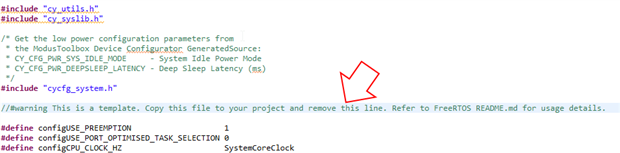

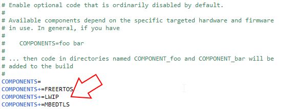

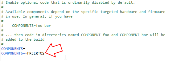

Configuring FreeRTOS
To build a FreeRTOS-enabled application, you need two additional steps
  • add the FREERTOS component. Edit the Makefile in the project and add the line shown in picture (COMPONENTS += FREERTOS)
  • Copy file FreeRTOSCOnfig.h from <workspace path>\mtb_shared\freertos\release-v10.3.1\Source\portable\COMPONENT_CM4 to your project's folder and remove the #warning message

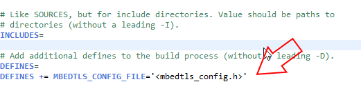

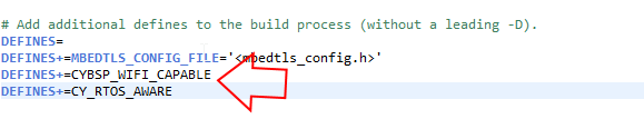

Configuring mbedTLS
mbedTLS is another library automatically included by the Library manager. You need to make some additional changes to include this library (all steps are well documented in the readme files included in the library source code)
  • copy file <workspace path>\mtb_shared\mbedtls\mbedtls-2.22.0\configs\config-no-entry.h to the project's folder and rename the file mbedtls_config.h
  • Add the following line to the project Makefile (DEFINES += MBEDTLS_CONFIG_FILE='<mbedtls_config.h>')
With this changes I was able to successfully build the application
Configuring mw-core
To configure the mw-core library, you can follow the readme file included in the library, which suggests to make the following changes to the Makefile
  • add LWIP and MBEDTLS components
  • add the following DEFINES to the Makefile

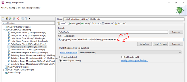

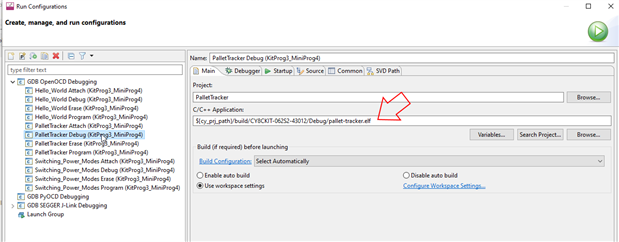

Changing application name
Because I created the application from a template, a default name was given to the application. So I changed the Makefile to use a more significant name for my application
So I changed this line
     APPNAME=mtb-example-psoc6-hello-world
to
     APPNAME=pallet-tracker

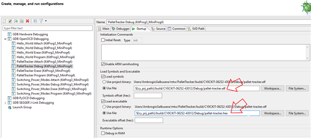

Because I changed the output filename, I also had to change Run and Debug configurations. I chose Debug -> Debug configurations and changed the application name
Then I did the same for Run -> Run configurations

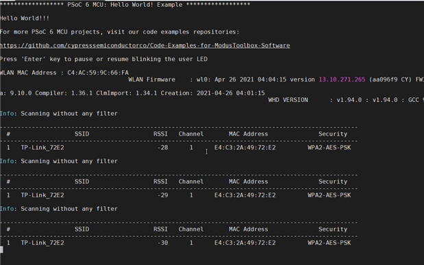

Implementing WiFi network scan
The first function I am going to implement is the WiFi networks scan. This function will give me a WiFi fingerprint that will be analyzed by the indoor location service to provide an approximate position of the tracker. Cypress WiFi Connection Manager provides a convenient way to do network scan.
First, you need to initialized the Connection manager
    cy_wcm_scan_filter_t scan_filter;
    cy_rslt_t result = CY_RSLT_SUCCESS;
    cy_wcm_config_t wcm_config = { .interface = CY_WCM_INTERFACE_TYPE_STA };
    memset(&scan_filter, 0, sizeof(cy_wcm_scan_filter_t));
    result = cy_wcm_init(&wcm_config);
As usual, there is a specific namespace for the connection manager function: cy_wcm_xx
Then, we can invoke the cy_wcn_start_scan function
result = cy_wcm_start_scan(scan_callback, NULL, NULL);
This function class the provided scan_callback function for each WiFi network found
static void scan_callback(cy_wcm_scan_result_t *result_ptr, void *user_data, cy_wcm_scan_status_t status)
cy_wcm_scan_result_t  stores all the information about the WiFi network, for example SSID and signal strength. status says whether there are other networks to be scanned or the scan process has been completed. If the latter is the case, then status is equal to CY_WCM_SCAN_COMPLETE

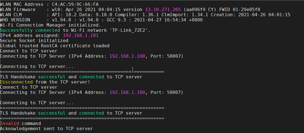

Running the server
The code on github include a python server that can be launched from a terminal by typing the command
python tcp-secure-server.sh
On the terminal connected to the PSoC6, I got the following output
