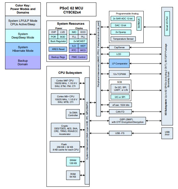

Let's have a quick overview of the PSoC6 internal architecture. Here is a diagram with all the integrated peripherals and buses
There are two Arm Cortex CPUs:
  • The Cortex-M4 (CM4) has single-cycle multiply, a floating-point unit (FPU), and a memory protection unit (MPU). It can run at up to 150 MHz. This is the main CPU, designed for a short interrupt response time, high code density, and high throughput.
  • The Cortex-M0+ (CM0+) has single-cycle multiply, and an MPU. It can run at up to 100 MHz; however, for CM4 speeds above 100 MHz, CM0+ and bus peripherals are limited to half the speed of CM4. Thus, for CM4 running at 150 MHz, CM0+ and peripherals are limited to 75 MHz. CM0+ is the secondary CPU; it is used to implement system calls and device-level security, safety, and protection features. CM0+ provides a secured, uninterruptible boot function. This guarantees that post boot, system integrity is checked and memory and peripheral access privileges are enforced.
The CPUs can be selectively placed in their Sleep and Deep Sleep power modes as defined by Arm.

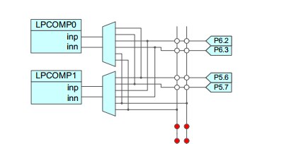

According to power reduction techniques, if the low-power comparator requires pin connections and system deep sleep operation, always choose the dedicated pin connections to the comparator. This allows the comparator to work in system deep sleep and avoid using the global analog muxes, which consume additional current to stay active.
Looking at the datasheet, this is the internal connections of the LPComp

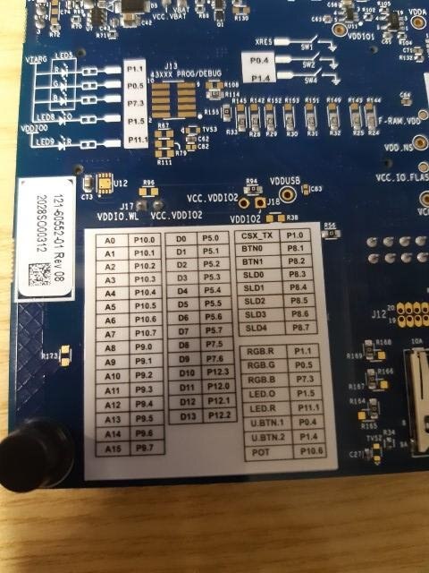

On the back of the evaluation kit, there is a table with the pin assignments
According to this table, pin 5.6 and 5.7 (used by LPComp1) are connected to pin D6 and D7 of the connectors on the front of the board. So I can use these two pins and LPComp1 for my project

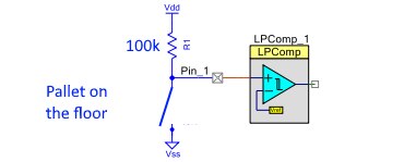

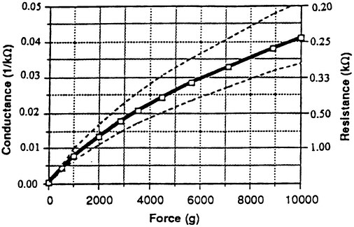

Because most of the time the pallet is on the floor or on a shelf (and not, as an example, lifted up by a forkilft), it's a good idea to limit the current consumption is such condition. My first design idea was to use a Force Sensing Resistor (FSR) to detect when the pallet is lifted up. However, a FSR's resistance diminishes when a force is applied, as shown in diagram below

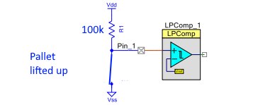

This means that the maximum current would flow just when I want to save energy (i.e. when the pallet is resting on the floor or on a shelf). So I moved to a simpler solution: a normally-closed switch. With a switch, you are completely cutting the circuit, so no current will circulate.
When the pallet is on the floor, the switch is open and there will virtually no current flowing (the current flows through the 100k resistor in series with the very-high opamp input resistor)
When the pallet is lifted up by a forklift, then the switch closes and pin is pulled down to ground. Here we have a limited current flowing through the 100k resistor, but this condition should last significantly less the the other condition.
