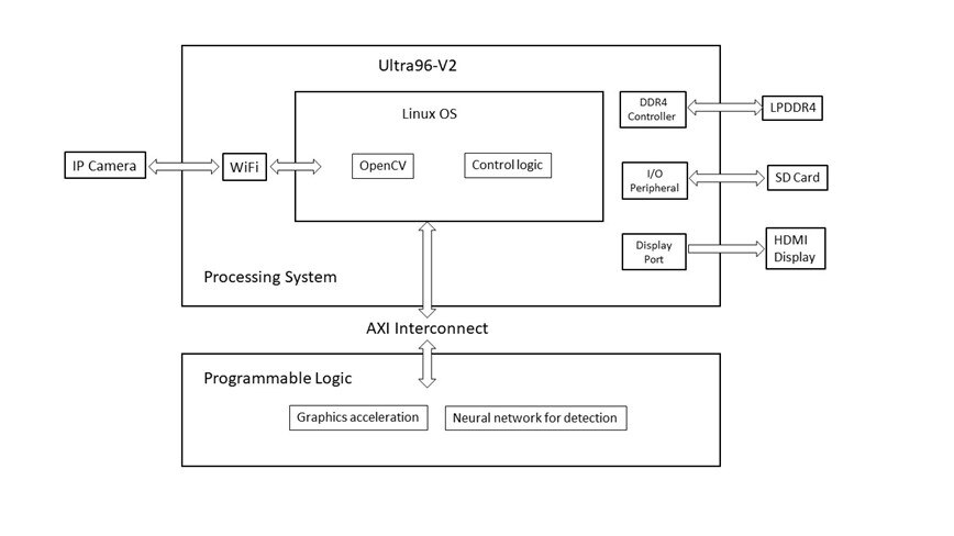

Project: Embedded Vision Processor
Here is the block diagram of the project:
Project features
  • Capture IP camera RTSP video stream using OpenCV
  • Process video stream with neural network implemented in PL
  • Process neural network response in PS
  • Output video stream via Display Port to HDMI monitor
Even with a simple feature set there are many elements involved in implementing this project on the Ultra96, not the least of which is the learning curve for the tools and hardware.  I estimate that it will take me 4-8 additional weeks to fully implement the system that I want.   For the purposes of PIIP, I thought that I would demonstrate some of the features and indicate what I have accomplished and what I have left to do.
This task turned out to take a lot more effort than I expected.  The face detection program was already using OpenCV and the VideoCapture object to capture the webcam stream, so I thought it would be as simple as using the rtsp URL and format as the VideoCapture arguments.  It turns out that the DPU TRD PetaLinux build did not include all the required OpenCV libraries and utilities that I needed.  Both IP cameras that I am using have a max resolution of 1280x720 and my plan is to use the high resolution h264 encoded streams.  I ended up needing to add libav, ffmpeg, and gstreamer to the PetaLinux build configuration.  My next issue was a total surprise.  I was using a Trendnet USB3 to Ethernet adapter for networking but the USB side started getting very intermittent (device not detected).  This adapter still works on my Windows10 box, so I wonder if my Ultra96 has some issues.  I decided at that point just to fall back to using WiFi.  Big surprise -- the DPU TRD does not have the WiFi configured and that was very painful to fix.  I did find some very useful github repositories in the process.  Avnet has repositories for all its hardware platforms, board support packages, and petalinux configs. https://github.com/Avnet/petalinux, https://github.com/Avnet/hdl, https://github.com/Avnet/bdf.  I ended up looking through the ultra96v2_oob petalinux scripts to figure out how to add the WiFi to the TRD design.  After completing that, adding the rtsp source did turn out to be as simple as using the correct rtsp URL and the CAP_FFMPEG format specifier with VideoCapture.  What I am going to look at in the future is whether or not I can get some additional acceleration with xfOpenCV.  I am treading on thin ice here as I really haven't investigated which functions can be accelerated.  It would have been really nice if the Ultra96 had the hardware VCU (codec) for h264 decode and encode but that's only available on EV FPGAs.

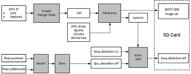

The design flow for the DPU is shown below.  I'd like to implement and train different neural networks for specific image detection and classification.  The key to doing this is in the lower left of the flow.  You need to use the Decent and DNNC tools of the DNNDK to generate the model.elf for the SDK.  I have not tried learning the DNNDK tool yet.  I think I'll play around with the provided resnet50 classifier first, but eventually I'll need to learn the DNNDK to build the correct models.
