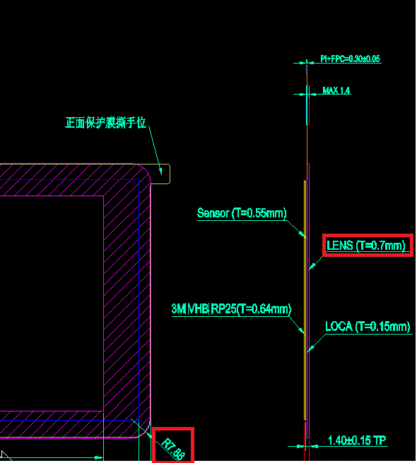

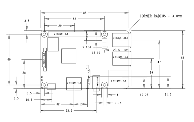

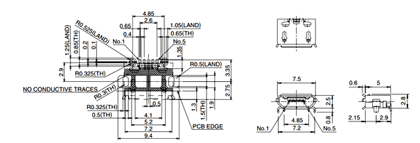

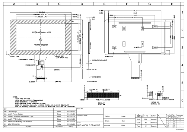

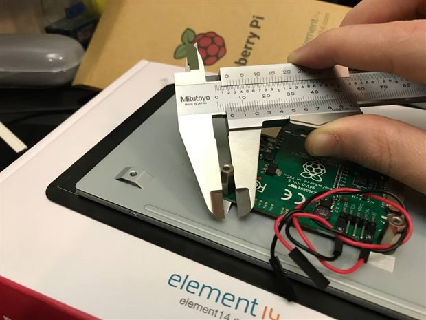

Following up the initial design of the Hologram Pi-ramid, the next step that made sense to me was to start designing the project in a 3D CAD/CAM software; this allows me to get a feeling on how the project should look like, make adjustments, corrections and most importantly, I wanted to measure the dimensions of each side of the Plexiglass pyramid once it was defined within the project.
I started by finding mechanical drawings of the key components like the Raspberry Pi 3B+ and the 7" Touch display, then I replicated them in Autodesk Fusion 360 with high level detail; I was only interested in replicating in the model the most relevant characteristics of the components like the tallest part, location of GPIO and power connections, parameter that may have an impact in the final design of the Hologram Pi-ramid. When an important detail was missing a vernier caliper most likely will do the missing work.
Mechanical drawings
  • Raspberry Pi Touch Display
{gallery:width=960,height=768,autoplay=false} Raspberry Pi and Display dimensions
RPi 3B+: Raspberry Pi 3 B+ dimensions
Touch Display: Raspberry Pi Touch Display dimensions
Touch Display: Raspberry Pi Touch Display radius
Micro USB: Dimensions
Hologram Pi-ramid: Important measurements
