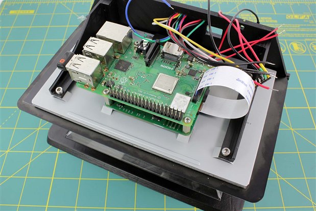

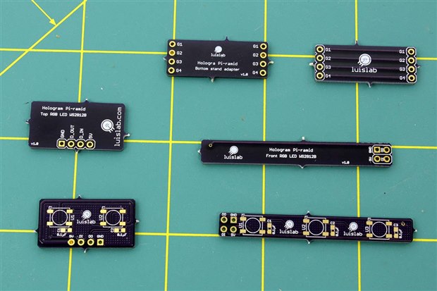

I'm finally heading to the conclusion of this project which I have enjoyed beginning-to-end. Essentially this project will use a Raspberry Pi 3B+ and a Raspberry Pi Touch Display to work, but I've added as a bonus a few custom made PCBs and will add a Camera Module V2 to try making it more interesting.
The custom made PCBs have arrived which means is time to gather all the components needed and to start assembling the electronics!.

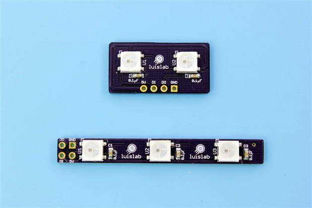

Custom made electronics prep work
{gallery:width=960,height=768,autoplay=false} Custom made electronics

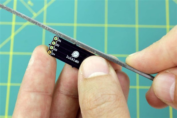

Hologram Pi-ramid: Custom made PCBs

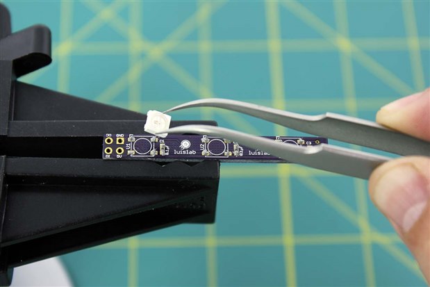

Hologram Pi-ramid: Preparing PCBs

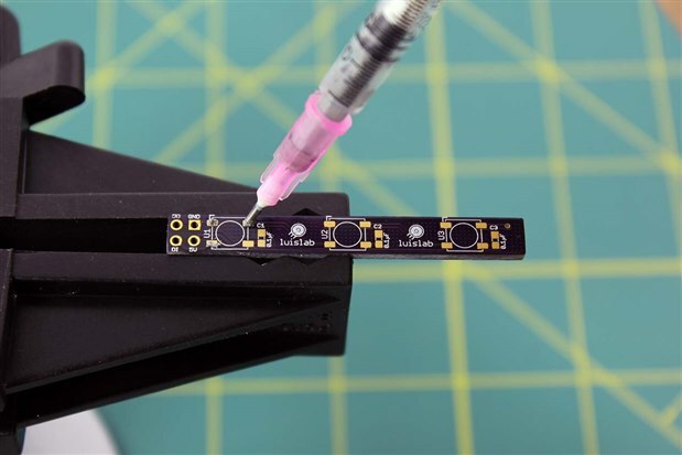

Hologram Pi-ramid: Applying solder paste
Hologram Pi-ramid: Manually placing SMD

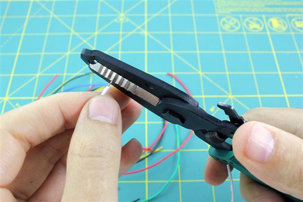

Hologram Pi-ramid: Wire stripping
Hologram Pi-ramid: PCBs ready to install

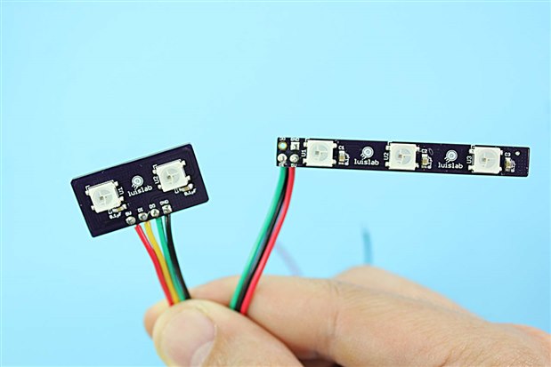

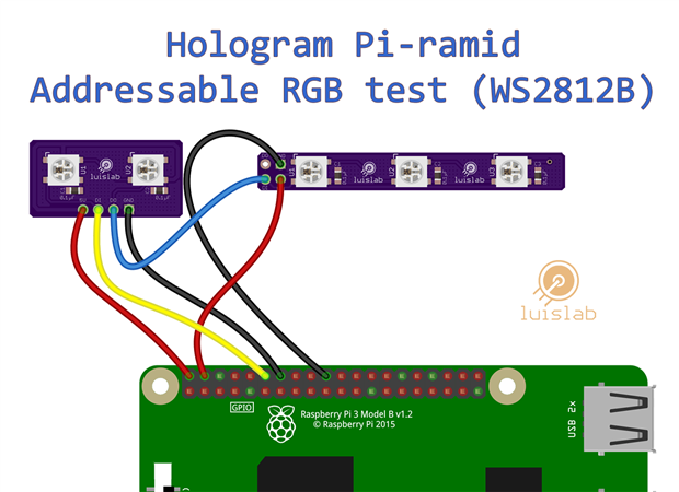

Testing the WS2812B with Python
To make sure the WS2812B Addressable RGB LEDs work correctly (all of them) I wrote a simple Python sketch, that lights every LED with different colors for a fraction of a second, the LEDs should be connected as below picture which is how they will assembled into the project as well.
NeoPixel Library for Python
There are several libraries out there for controlling WS2812B LEDs with Python and a Raspberry Pi, perhaps the Neopixel is the easiest and the most popular library out there.
To install the Neopixel library I ran the following command:
sudo pip3 install rpi_ws281x adafruit-circuitpython-neopixel
Python RGB test code
When I was reviewing the :GAME ZIP 64 for the BBC micro:bit I remember I had this strange issue where a single RGB LED won't light blue -scenario which I accounted for; the script will turn on each RGB channel independently, then it will turn on the RGB channels in pairs and finally will do few random combinations (all RGB channels combined).

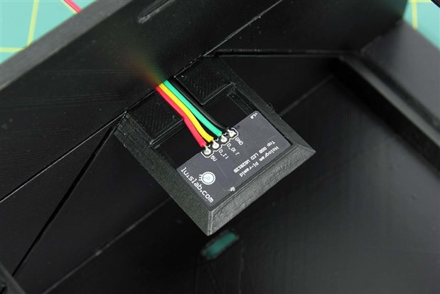

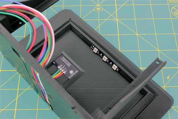

Hologram Pi-ramid assembly: Top and Front ambient RGB lightning
Hologram Pi-ramid assembly: Top ambient RGB lightning

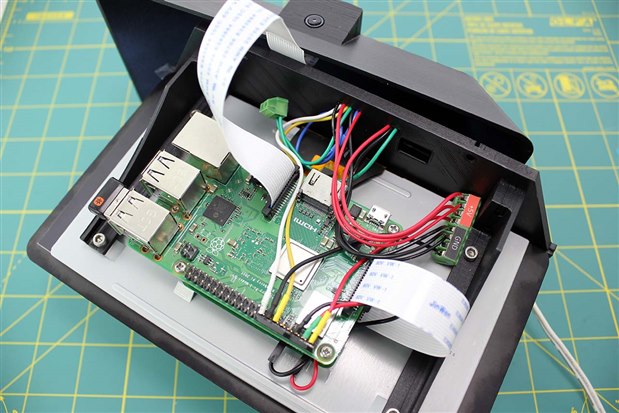

Hologram Pi-ramid assembly: Wires routing

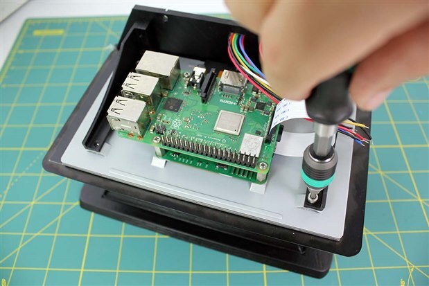

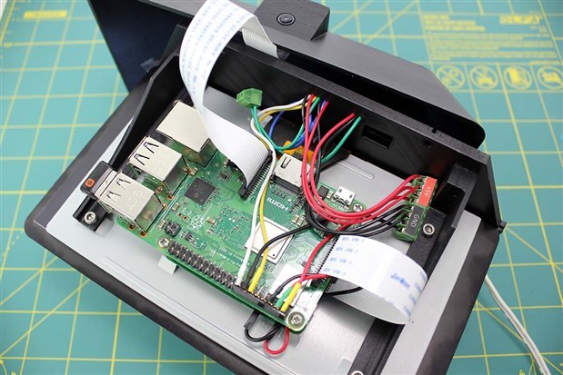

Hologram Pi-ramid assembly: Touch display assembly
Hologram Pi-ramid assembly: Raspberry Pi assembly

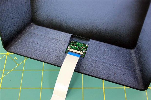

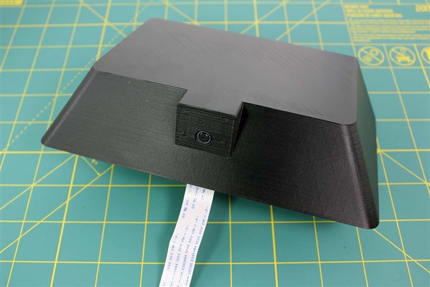

Hologram Pi-ramid assembly: Camera Module V2 assembly
Hologram Pi-ramid assembly: Camera Module V2 mounted

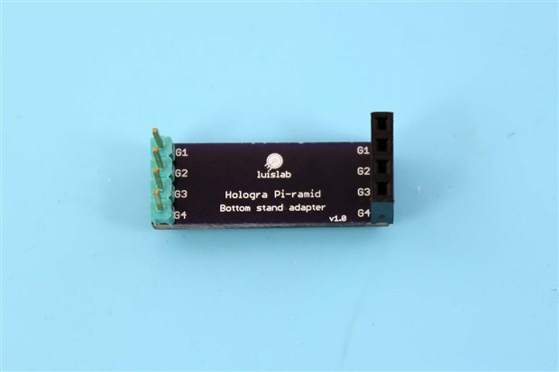

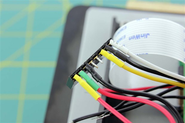

Hologram Pi-ramid assembly: Header
Hologram Pi-ramid: DIY splice connectors

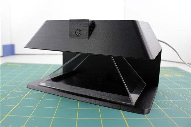

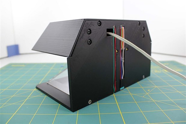

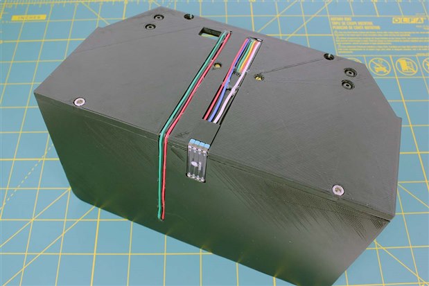

Hologram Pi-ramid: Final assembly (back)
Hologram Pi-ramid: Final assembly (side)

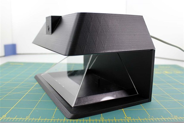

Hologram Pi-ramid: Finally assembled!
