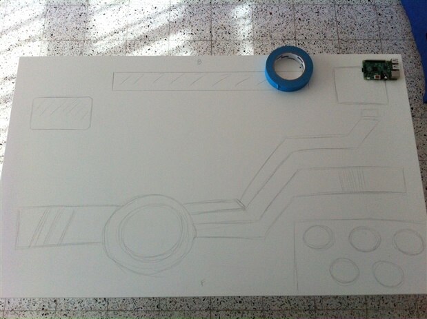

Ikea desk meets multitool. There's not much more to say about it, enjoy the picture gallery and be sure to check the description image
Hope you like the result so far!
{gallery} Ikea desk meets multitool

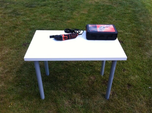

Desk & Multitool: The desk I picked for the project and the multitool I planned on using to carve out futuristic shapes with.

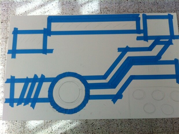

Sketch: Sketched where the different components like Pi, buttons and futuristic shape for LED strip would be.

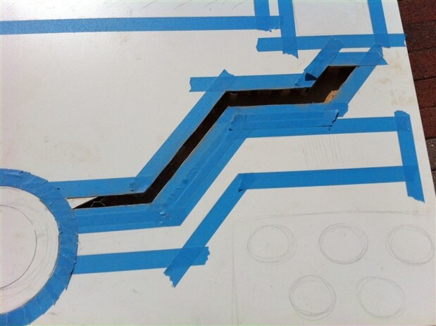

Tape: Used tape to better visualise the shapes and serve as reference when cutting.

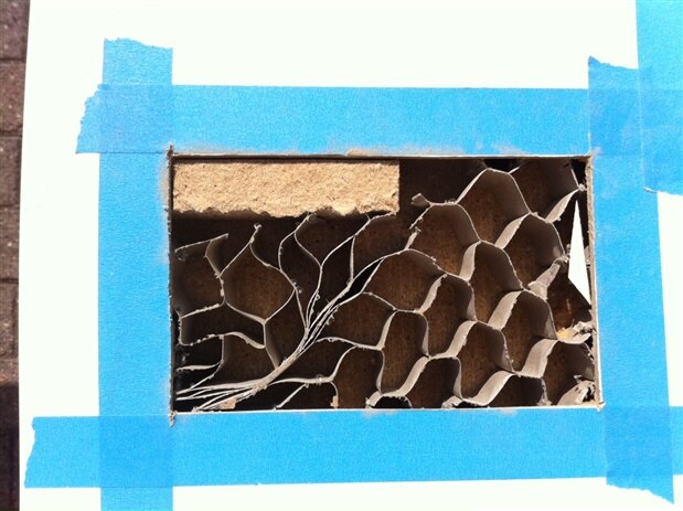

Internals: That's what the inside of a cheap Ikea desk looks like. A block in each corner to screw the legs to and a cardboard mesh for the rest.

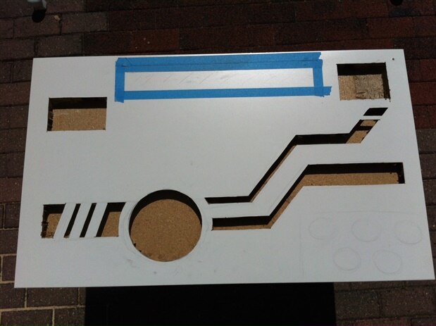

Cutting: Cutting using the multitool was rather easy, but tricky at times where the blade was larger than the shape to cut out.
Done: Most of the cutting work done, waiting for the final dimensions of the screen before cutting out that part.

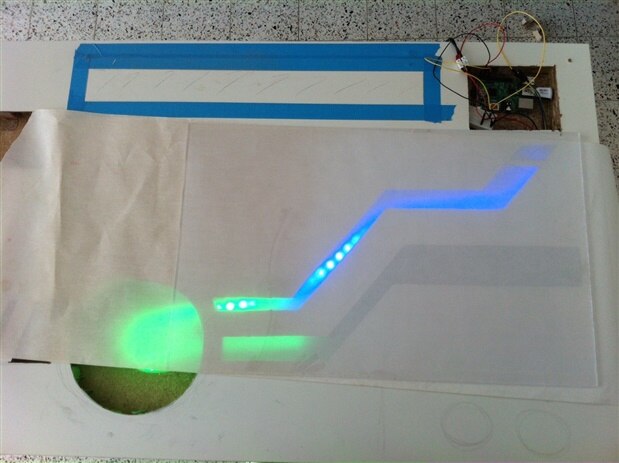

Test: A quick test to fit the Pi and LED strip and have a look at the result. Once the final LED strip arrives, it can be installed. In the mean time, I'll be testing various diffusors.

    Seems you didn't buy the massive oak version of the desk

    Interesting what is inside the desk! Nice use of materials for low cost yet reasonable rigidity. As one idea, 0.5mm thick white acetal ('Acetal C Natural Sheet' also known as ' Ertacetal/POM C' ) is a…
    Jan Cumps over 11 years ago in reply to shabaz +2
    ...with a lego brick height between the display and the sheet No kidding! You can actually see the 4 Lego bricks.

    There is a film the signwriters can apply to windows to give that sandblasted look.
    You might want to see if that will disfuse enough ...although having a glass layer on top might stop your other cunning tricks.. image
